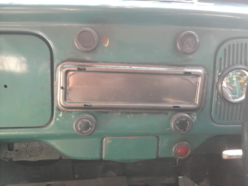

The previous owner tried to install a radio but instead of doing it right they decided to use a can opener and it was so skew put a plate over the hole to try and make it look halfway descent for now...

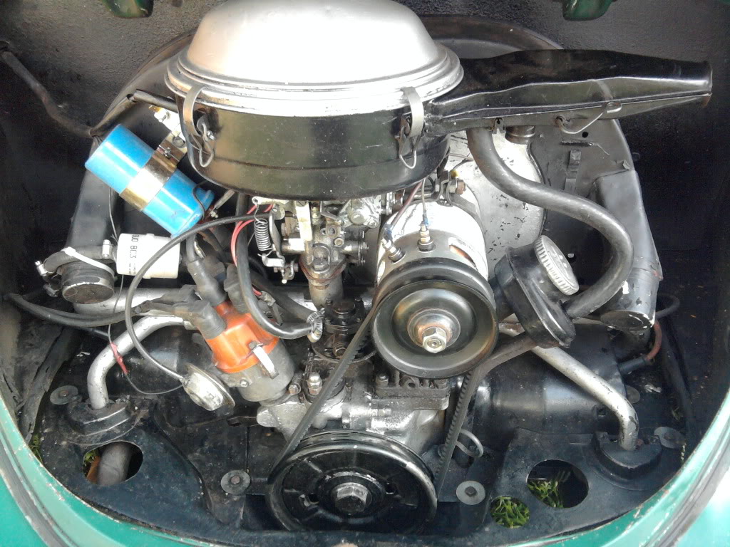

Very nice. You like your car? Want to drive it for a long time? Then have your mechanic move the fuel filter out of the engine bay.

Fuel line break off and sends fuel all over the distributor, spark plugs, other hot parts of the engine!
Then........
Fire, :shock: fire, :shock: fire. :shock:

Wow, okay then that would have to be top priority. My dad would hate himself if that happened after he threatened to do it himself lol.

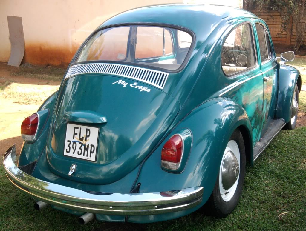

She looks like a 68, and my favourite late Beetle colour.
You should block off all the holes in the rear engine tin to prevent recirculation of hot air by the fan. :hangloose:

Thanks, we thought it might be later cause she does not have the vents at the back. Also did some research on the original colors and found that besides the carpeting being gone she is as original as can be. Peru green with cloud white leatherette (Platinum material inserts if you want it) and dark charcoal grey.
If I am going to repaint and all those things then I will stick with that and then in gold writing at the back I will rewrite her name. I just have to, otherwise I fear she will never forgive me ha ha

nive 68 also one of my favourite models as my first beetle and car was a 68....named "beetle bitch" also on her butt people used to like that....but she burnt down with me in tears on the side of the road...so move that filter A.S.A.P!!!

Where did you get the colour info? Was it specific to SA cars? I don't think cloth seats/inserts was ever an option on SA Beetles, and locally assembled Beetles were painted at Uitenhage using VWSA colours that may or may not have been similar to German colours.
I thought that green was Delta Green (German spec) or a local colour very close to Delta Green. If you've found a source of info on VWSA colours I'd like to know about it.
