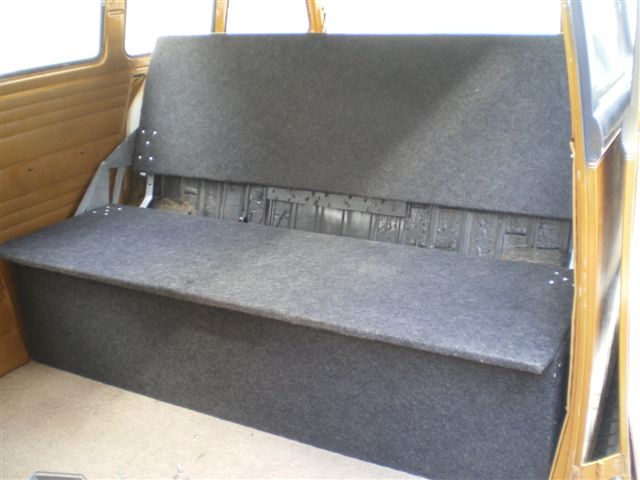

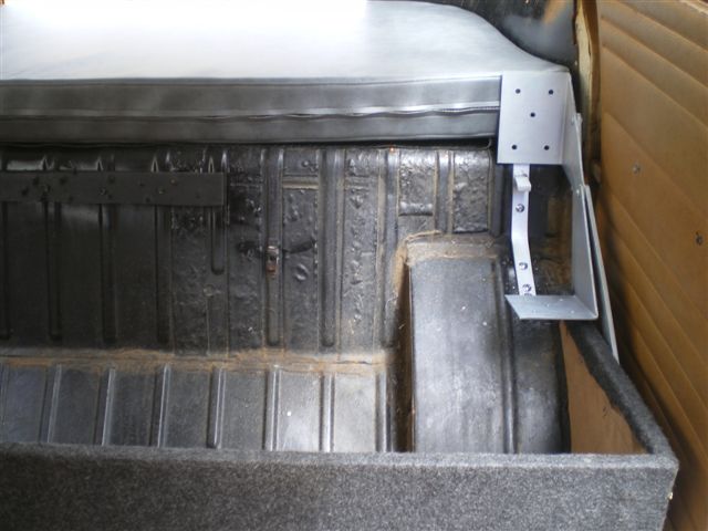

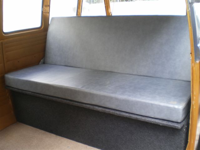

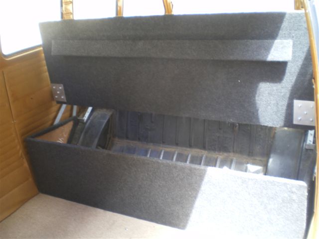

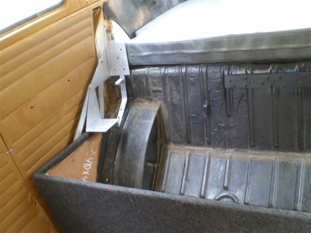

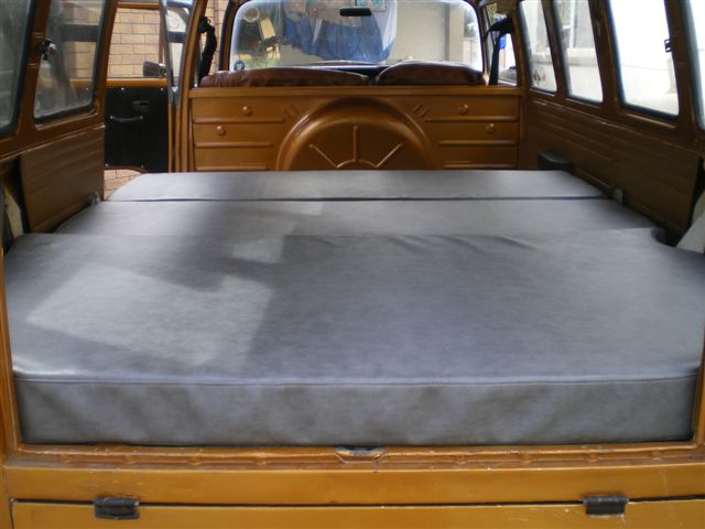

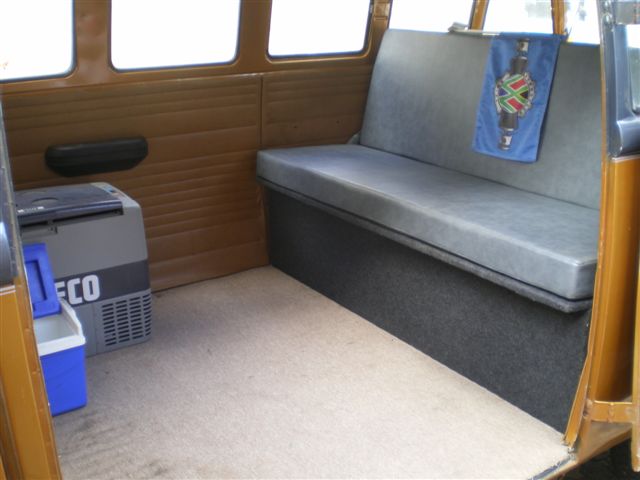

HI guys,
Did say I would post the final instillation of the seat/bed system, once I have had all the parts coated.
So with out extra delay, I bring you the Installed Rock & Roll seat/Bed system.......... :D
Now for the heavy sharp guys with out coulor blindness, The Grey of the seat is for the NEW coulor scheme of the bus, not this one, but will be testing it out in the Fugly for George and the KKK.
Please note the legs and the stiffeners are not fitted, but are still at powder coaters.

THAT IS LOOKING REAL NICE HERMAN!
HOW STRONG IS THAT BACKREST IN THE UPRIGHT POSITION AND WHAT IS THE TOTAL LENGTH OF THE BED?
