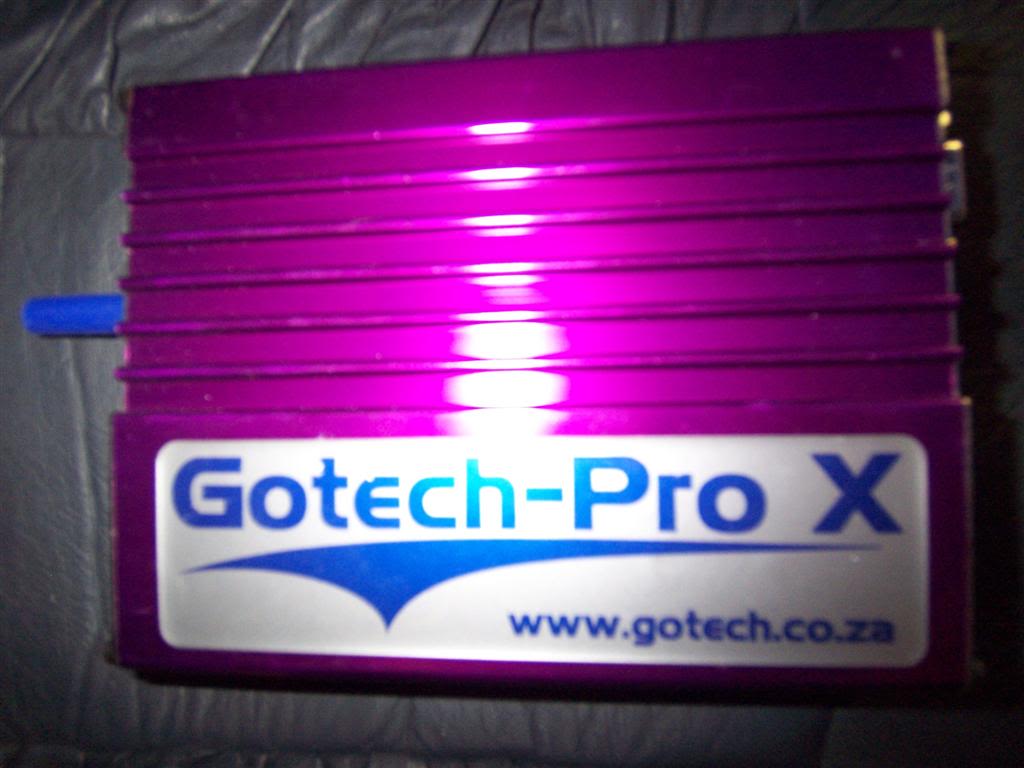

After having discussions with 4AGE (Louis) on this forum, I purchased a Gotech Pro X system from him with a semi made up wiring harness based on my current application.
I was thinking about running the mormal MSD setup that many others have done in the past. But then after talking to Louis, I realised that for a little extra than the MSD system, I would have a full electronic system will unlimited tuning adjustment. Plus for a long time I have been secretly wanting to run a fuel injection system. So if I ever do get to the stage that I decide to make that leap, then I already have the Gotech system to run the fuel injection with, at which time I would have had to discard the MSD system anyway.
For now, I am using the Gotech Pro X for timing ONLY. The 48IDF carburetors are still in place where they belong. Louis - I did look at the website you sent me to - those throttle bodies are the bomb and would be so nice to have. Nice to have and no more (for now).

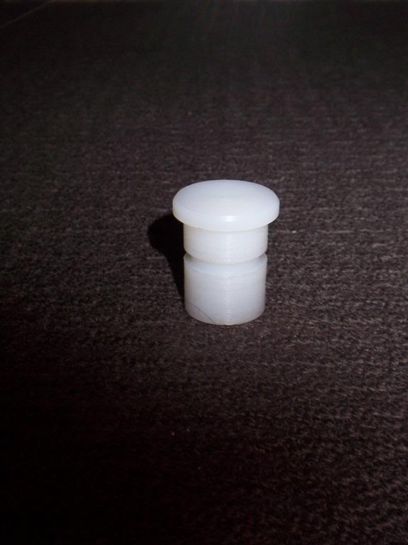

Take one Delrin plug which I made up on my last ship
and insert this plug into the engine where the distributor used to live.

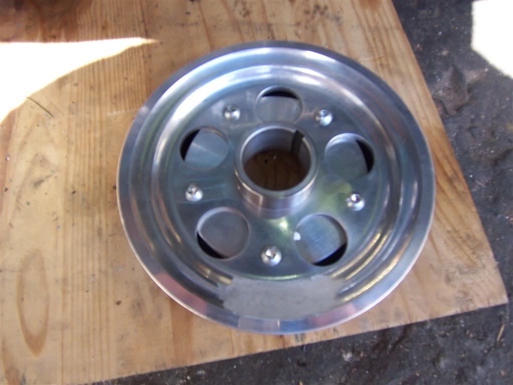

First though, it is time for pics of my pulley.
Note the amount cut away to get the unit balanced. Also note the 5 allen head bolts inserted into the back

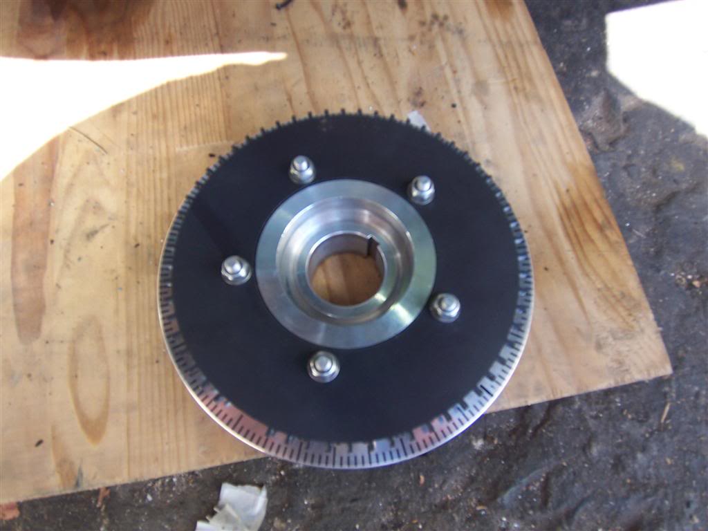

On the front of the pulley you can see the 60-2 timing wheel which tells the Gotech unit's hall sensor where the engine is in relation to crank angle.

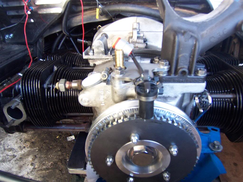

Now you can see the engine with the pulley, hall sensor and the distributor plug installed

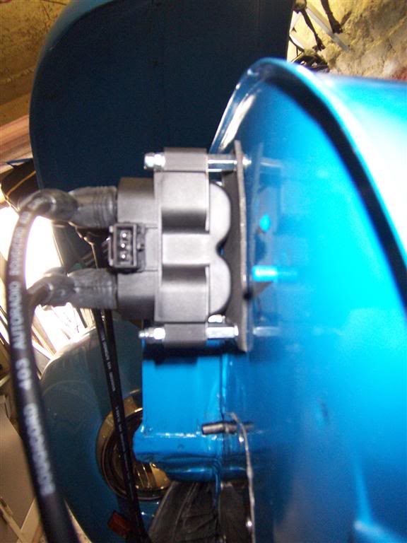

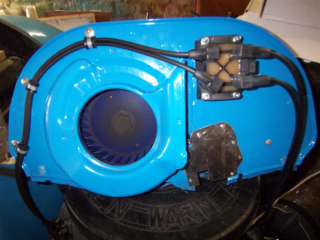

Then it was time for the coil pack to be mounted.
The coil comes from an early 16V Opel. it is a twin coil pack designed to run in wasted spark mode. The term wasted spark describes the spark event and in this case one spark is wasted. Coils designed for this have 2 spark plug leads attached to each coil, so it fires two cylinders at the same time. One of these cylinders is the cylinder that need spark, the other is busy in its exhaust stroke (this is the spark that is wasted). So with the beetle having a 1-4-3-2 firing order, cylinders 1&3 are connected to the same coil and 2&4 are connected to the other.
I mounted the coil to the back of the fan housing and mounted the spark plug wires to the housing to for a clean look. I'll tell you what though, using riv-nuts without a riv-nut gun is quite the accomplishment, but I got it right.
Here you can nicely see the twin coil pack
I am actually proud of the way I ran the plug wires - not once do they cross each other. Running side by side all the way from the coil until they separate to attach to the plugs.
