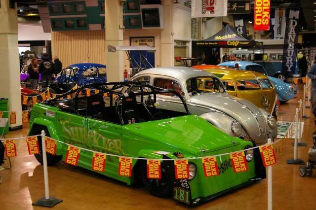

I saw the TV program where they built "Shrekker", there's not a whole lot of trekker left in there...

yep it the guys from beetle crisis...it must burn the eye's of the purists...but you gotta admit it ooks mean and it has the vooomaaa to go with it...
