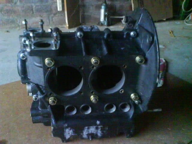

I brought the case already line bored from Dave Rowley for R750 which I think was a good price as the case has only been line bored 40 thou, has factory fitted case saver inserts and is also dual relief
The full flow tapping,drilling and milling was R100 and R45 for the brass 90º elbow.

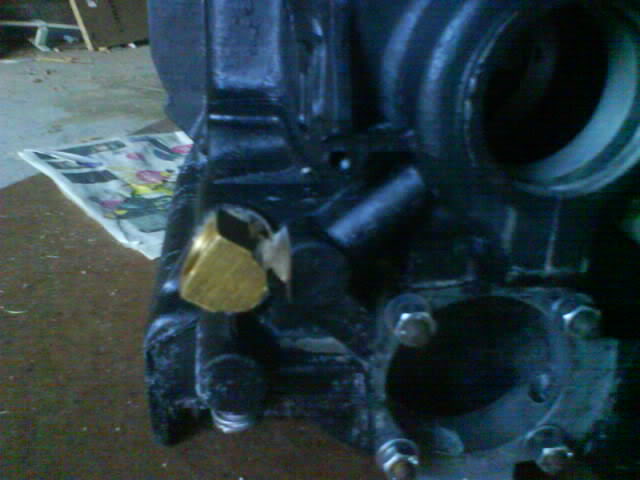

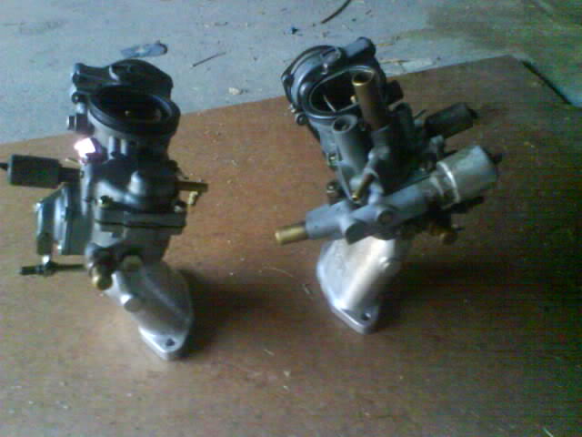

Here are the pics of the full flow mod on the case as well as the carbs on their shiny new ICT manifolds[

How much did you pay for the manifoldas?vw trends want 600 to 700 buck for a set!

I was really lucky with the manifolds DaveR had them spare from a tp ict carb kit which was going on a single port motor so the TP manifolds were laying in his parts store for a while.
I paid R350 for the pair including the carb mounting studs which was really a good deal

Dubster, my baja has the full flow oil filter setup on at the moment will post some pics of it.
