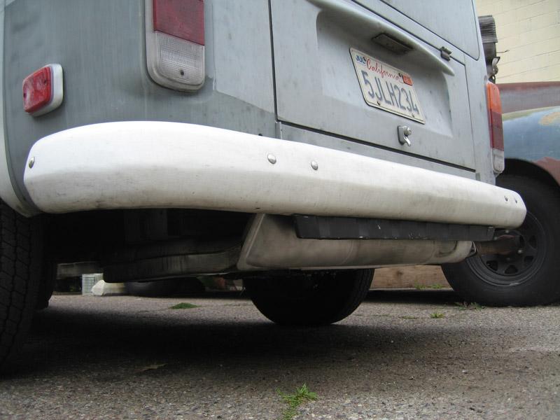

By the way, some production changes happened mid-way during 72 production year, like this:
Early 72 engine lid with short length brow over licence plate:
Later 1972- Longer brow like later bays:
The count for 72 Type 2 production- (last 6 digits), was 230 000 on July 1 1972 in Germany.
On 31 Dec 1971 last 6 digits were 088 996. (Official production year starting August 1971).
At 057820, Eugene's one would be a relatively "early 72" model.
