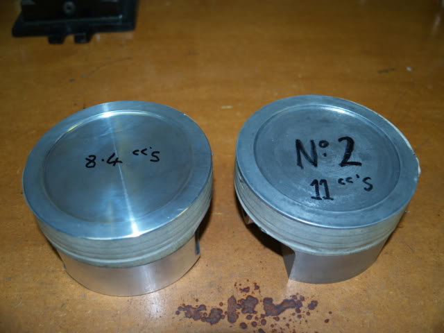

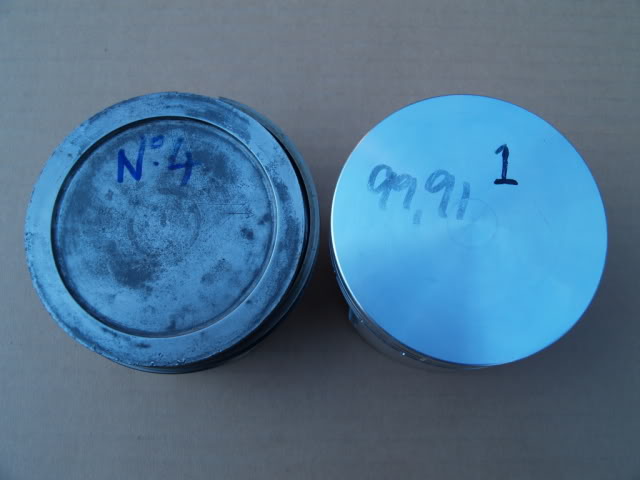

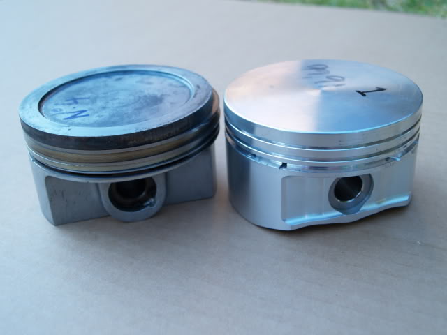

PISTONS:
My old engine had a set of Mahle 100mm pistons and cylinders (forged pistons & cast aluminum Nikasil cylinders) when I tore down the engine I found the cylinders were quite worn. After months of searching I was unable to find the correct rings for the Mahle pistons. Eventually I contacted JE Pistons and they said they could make me a new set of rings. However, after looking at their catalogue I decided to have complete new pistons made to take the Porsche 100mm rings. I sent a piston to JE and they sent it back with 4 shinny new ones (I had them made flat top as I thought that would be a better way to go)
I was wrong :oops: :cry: My plan was to increase the deck height to 2.06mm to achieve a static compression of 8.5 - 1... wrong wrong wrong!!!!! :evil: :evil: "to much deck height" I had to either remove +-8cc from the chambers or machine a dish in my nice new piston to achieve a deck height of +-1mm. I chose to dish the pistons. Long story, making up special tool to hold pistons took longer than the actual work, still all's well now. :D :lol:

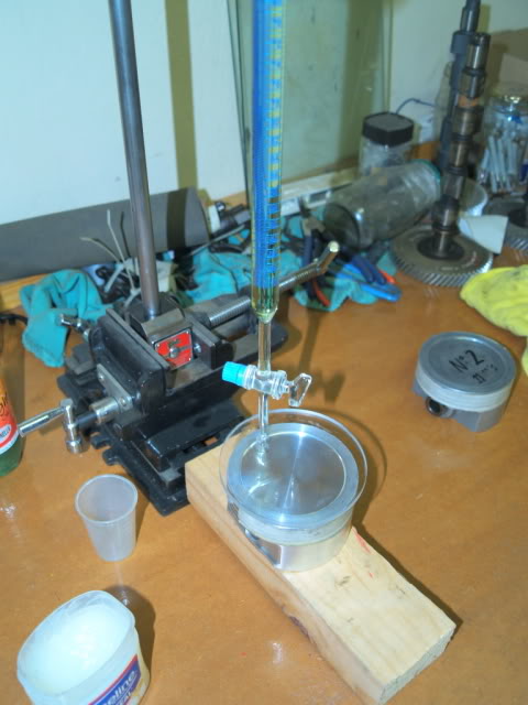

I built my own rig for balancing the cylinder head chambers (Heads, a later story) I used it to check each piston after machining the new dishes, I was expecting to do some hand finishing to get the balance right, but :D they all came out at 8.4cc :lol: hows that :wink:

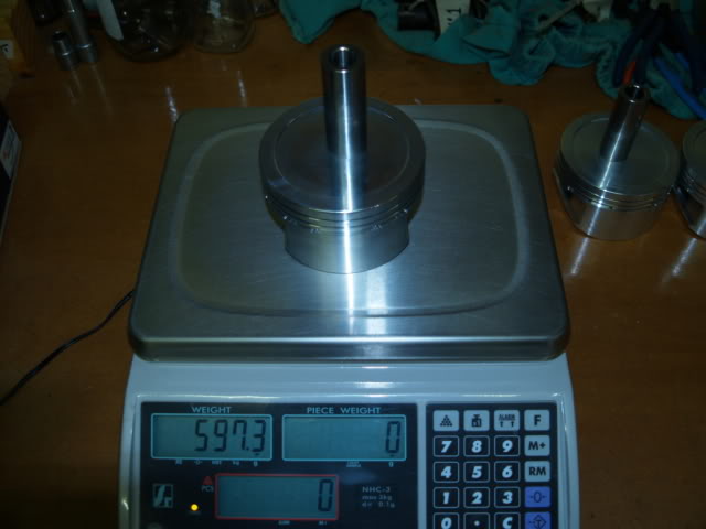

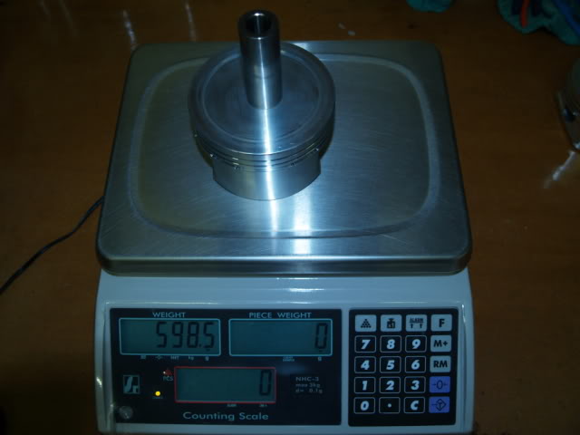

The next job was balancing the pistons, I contacted JE and they told me that 5 grams was considered Ok for road use and 1 gram for race use. My new piston were already +-1gram. Anyway, I thought I might be able to do better :wink: so I set to work weighing each piston and pin, mixing and matching to get the best balance and then grinding to achieve a final spread of only 0.2 grams. I became quite obsessive but its really hard to get better as you are working with only half a feather at weights of +- 0.2grams :x

hhmmmmm....T4, you have such a long pipette......;)
Ants dig sand!
1.9 KCC Porsche Speedster
Re: Type 4 aero conversion
its the vaseline that worries me :P

You bet yeh.... :hangloose: you should see the size of the stand I had to make to hold it upright :shock: :D
