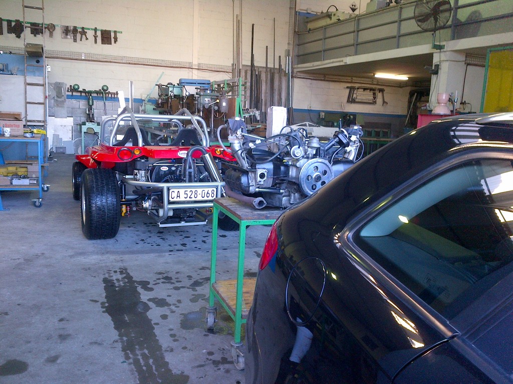

While getting everything back on the engine I managed to snap one of the exhaust studs and when I tried to drill it out the bit snapped off. Took the engine to Dave at FFR early Saturday morning to get the stud out.
