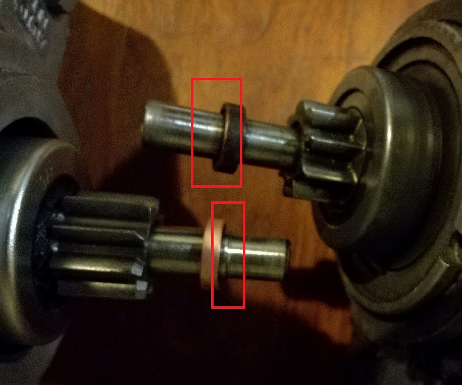

Re: 67 Panelvan
Still no luck.
New earth strap between body and gearbox.
tested with 2 new batteries
new starter bush in gearbox
hard start relay installed
new starter installed
Still no start, The new starter definitely makes a lot more noise than the old one and sounds a lot more crispy. It spins but just wont turn the engine. If i turn the engine by hand after trying to start it with the starter I can hear a clear click coming from the starter. I believe the sound is the starter disengaging ?
There are two main differences between my old starter and the new one. The splines itself differ in length, the new is longer. The new starter also has a little lip on the shaft that goes into bush. Would any of these two differences be an issue ? The starter is marked as beetle. I do have a beetle gearbox in the kombi and also a 1600TP engine.
I am completely lost at the moment as to what the cause could be.
Could electric/wiring still be the problem ?

Re: 67 Panelvan
Hi Donovan
That new starter might not be correct. Generally the longer bendix is for the 2.0 type 4 bellhousing. That will be an issue in the beetle box.
Do you not perhaps have another gearbox or bellhousing around to test the starters in a remote option?

Re: 67 Panelvan
Some incorrect universal parts cross-references out there.
Basically 3 types starters used by manual trans acvws:
1) "6V" type which fits 180mm flywheels from 6V type 1, 2, and 3 cars. Called "SR11"
2) Anything which has the 200mm "type 1" flywheel, or 210 or 215mm "type 4" flywheel, uses "SR15" starter. Including an older car which had the later flywheel fitted, and including 411/412 cars and 1600/ 1700/ 1800 baywindows, but excluding 76-onwards 2L bays. This is by far the most common starter for acvws.
3) 2L bays have "SR87" type starter, (with the longer gear to reach the ring gear). Different bellhousing goes with this starter, to accomodate the large 228mm flywheel.
Starter from automatic:
In place of number 2) "SR15", one could also use the "self supported" starter from an automatic type 3 or automatic 411/412. (Porsche 914 and early 911 also uses this one.) Does not need the gearbox bushing, and is slightly stronger.
So called "SR 17" starter. Drops in, no modification.

Thanks again for all the info and advice.
The starter I got from goeie hoop is marked as a Lucas-VW Beetle 70 > 79, S90 starter.
Re - Retrovan, Sean and Dawie's post, Im still unsure if this is a correct starter ? I dont want to mess about if its not the right one or damage and ding this one and then not be able to return it if its not the correct one.

Hi Donovan.
I'm at the factory in Brackenfell today if you want to swing around and test them. I have a test setup for it.
