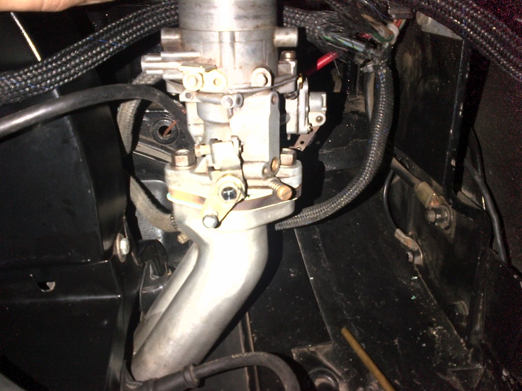

Any suggestions where I can connect my return springs, the arms on the throttle shafts where I attached them before was removed.
Before(best I can find right now):
After:
After:
- Posts: 14994
- Been thanked: 487 times
Re: 67 Panelvan
stick one onto the coil mount and another onto the fan mount bolts.
Or run it from the alternator clamp over the alternator to the right side arm - thats how I do mine.
- Posts: 8709
- Been thanked: 539 times
Re: 67 Panelvan
Here is howi have done it,
Used the old spring arm from the old carbs, (or make short arms ) and fitted then on the butterfly shaft, and fitted my springs as shown below.
hope it helps
hope it helps
