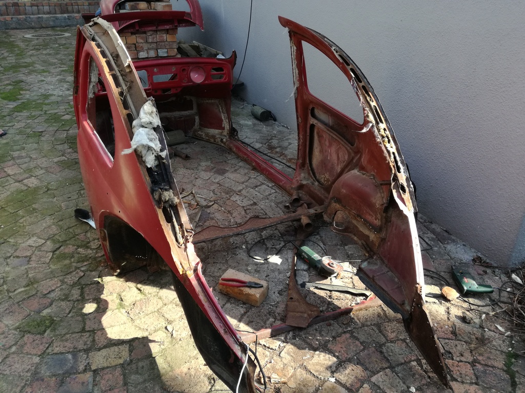

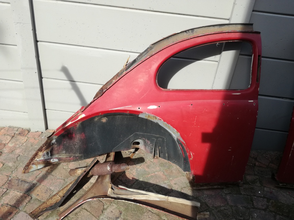

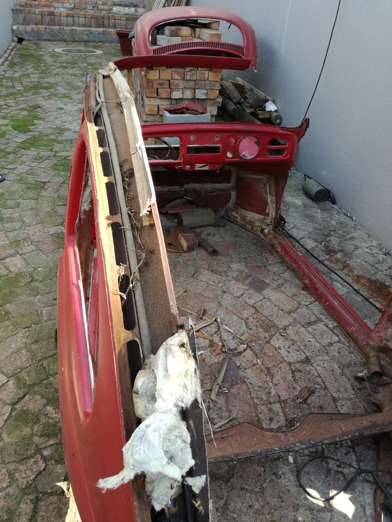

Ok so thats the end of the donor, all chopped.

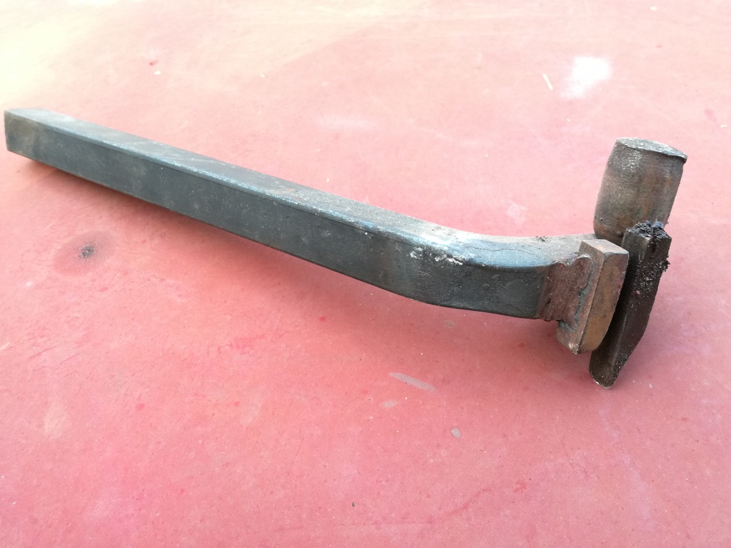

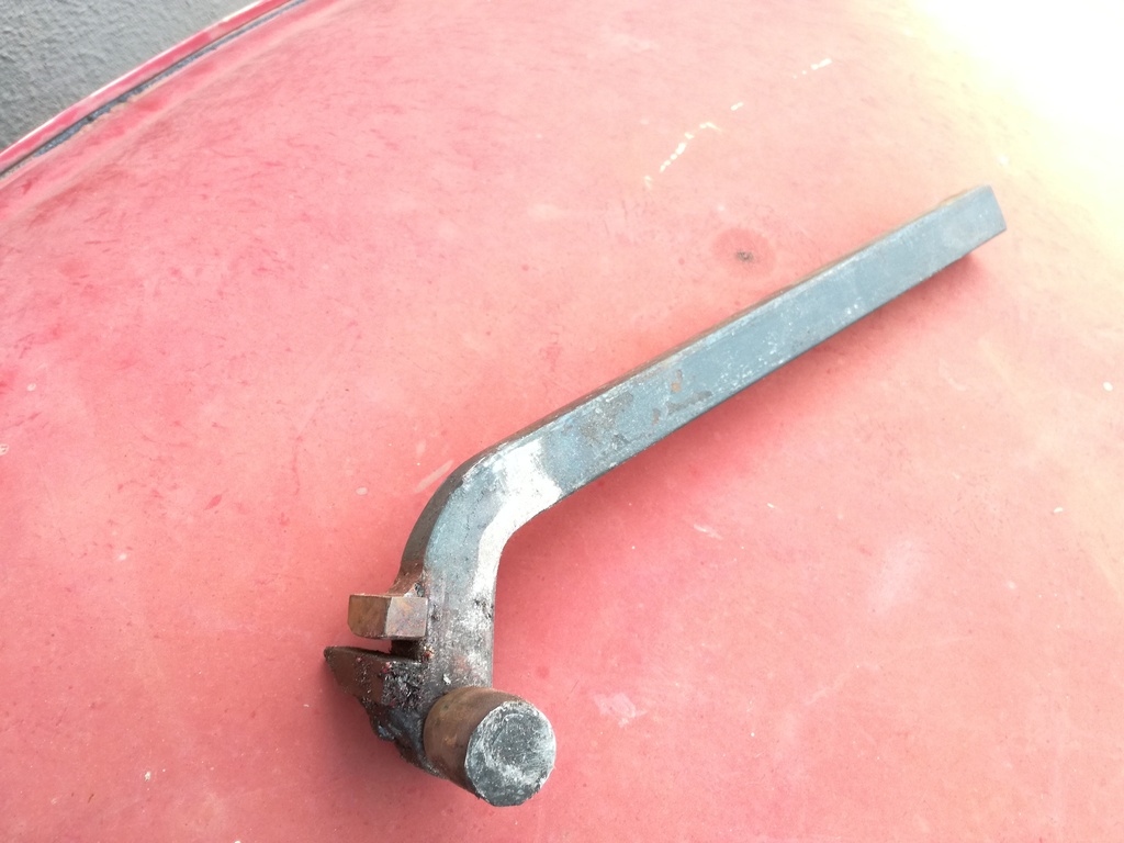

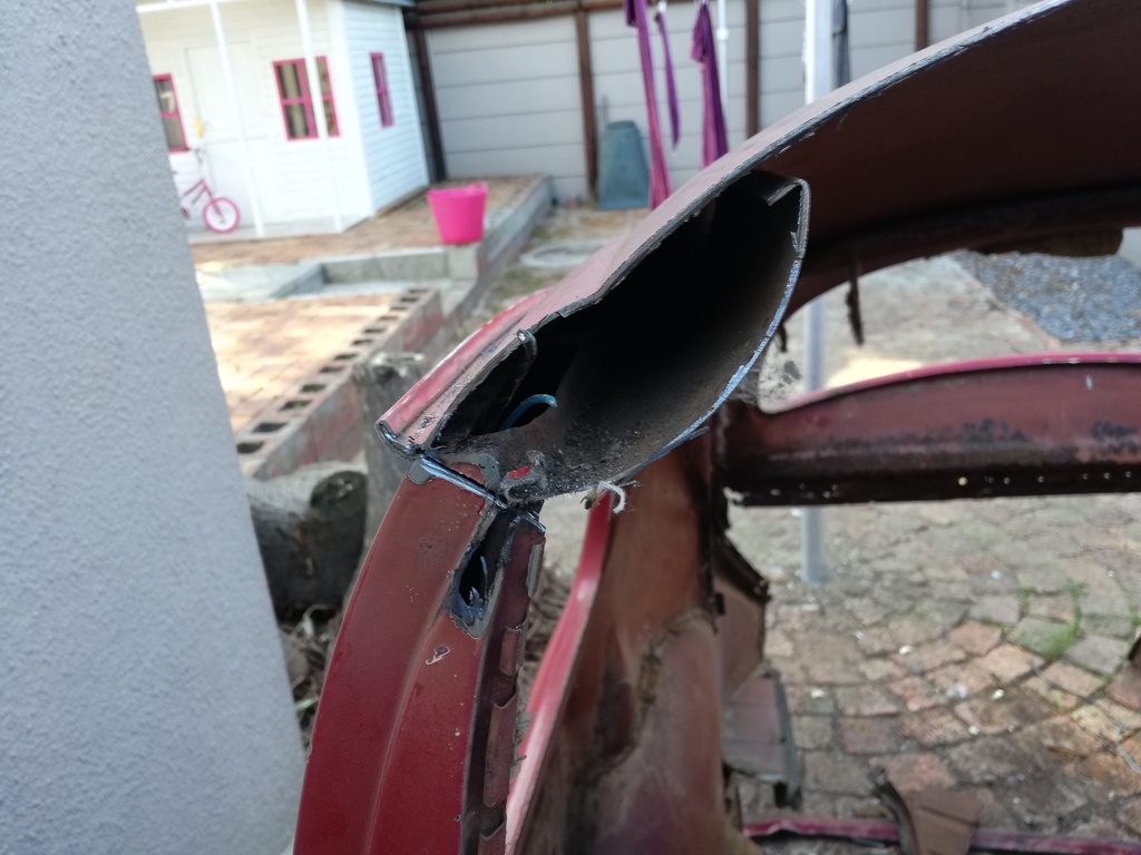

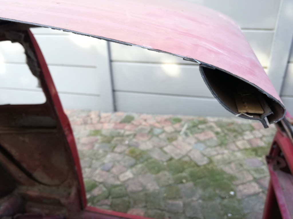

Tool my father made based on the VW factory tool, used to break open the roof gutter.

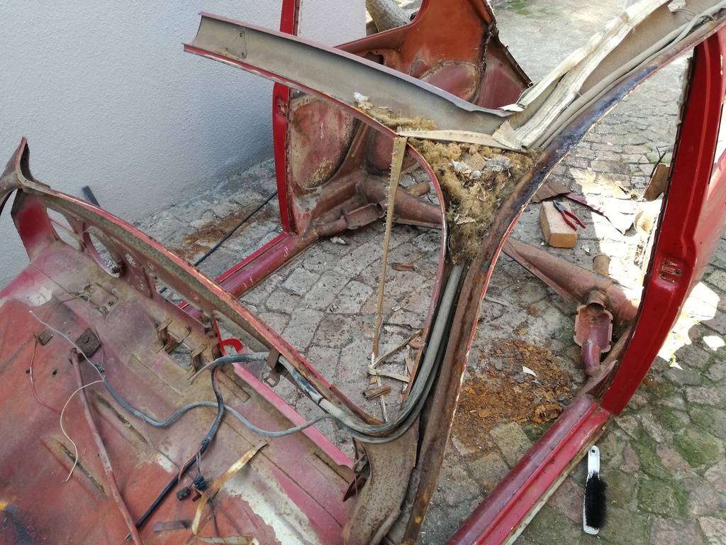

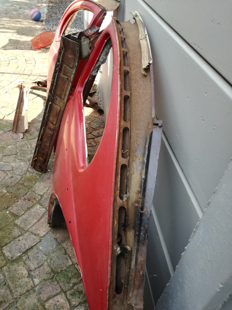

I cut out the main piece I need for the oval , for anyone interested this is what the roof looks like when cut.
Got the roof off. This is actually an easy job once the channel is opened

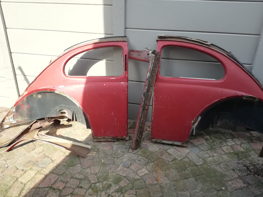

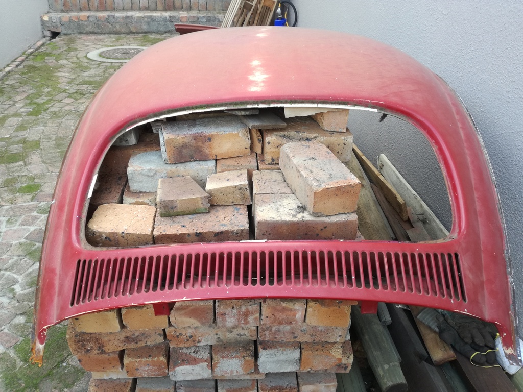

These are two bits I do not need, any takers
Hoping to get R500 for both rear sections, still pretty good condition.

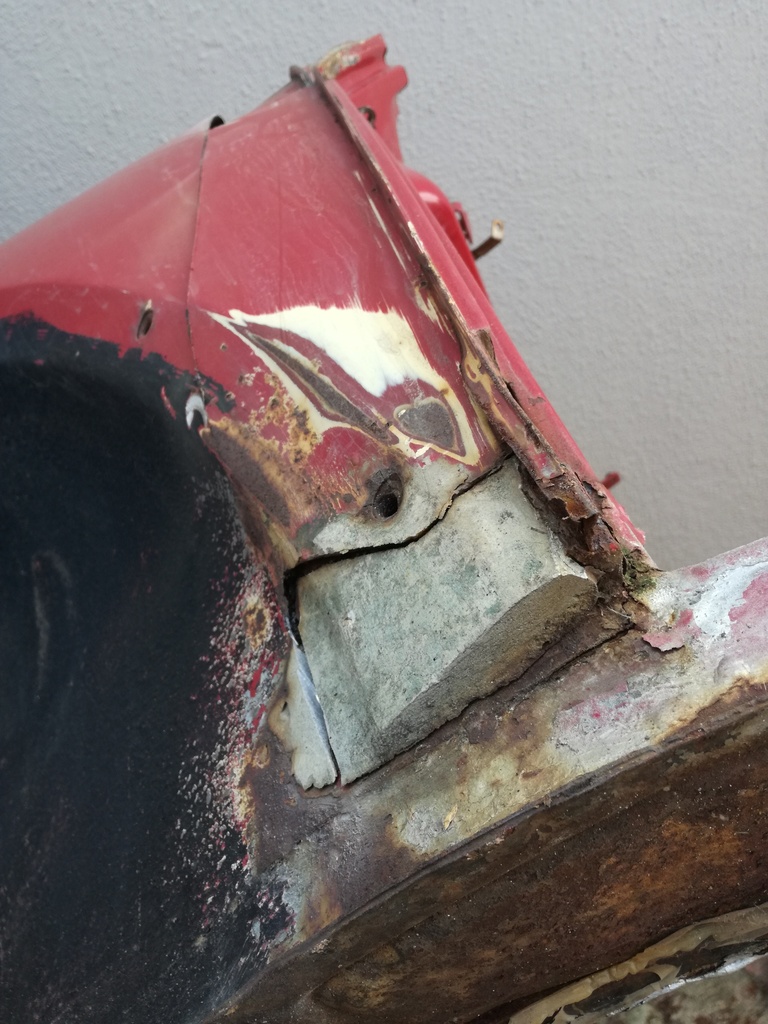

Next level body putty
