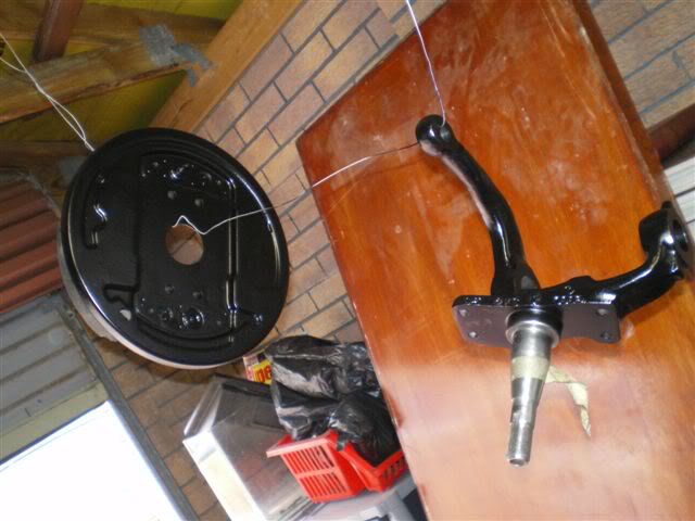

Well as promised, here are some pic's

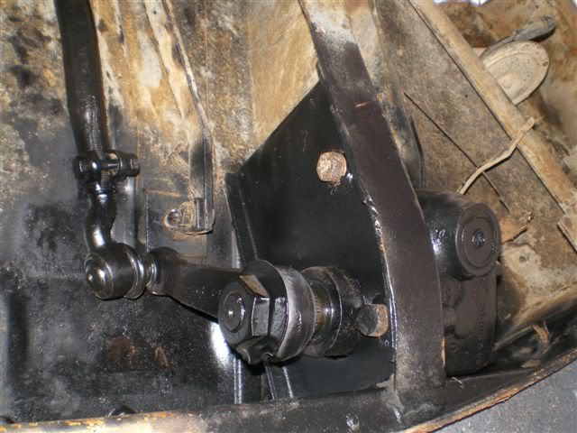

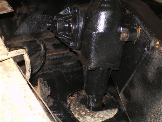

The reconditioned Steering box, filled, new seals, and ready...
Just an other view of the steering box

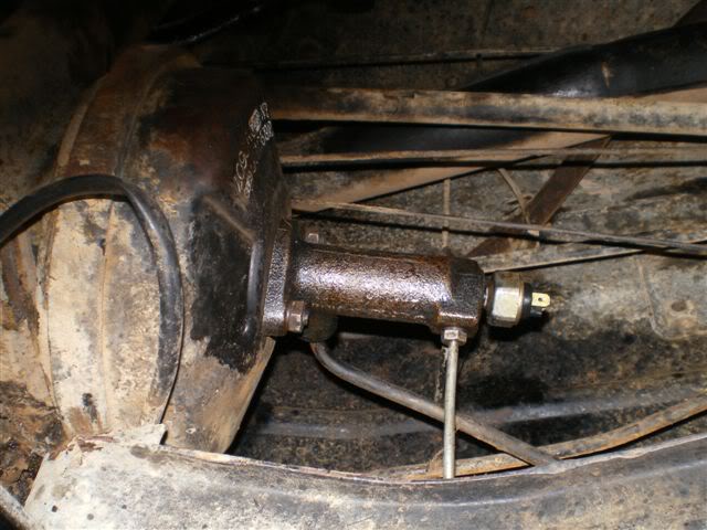

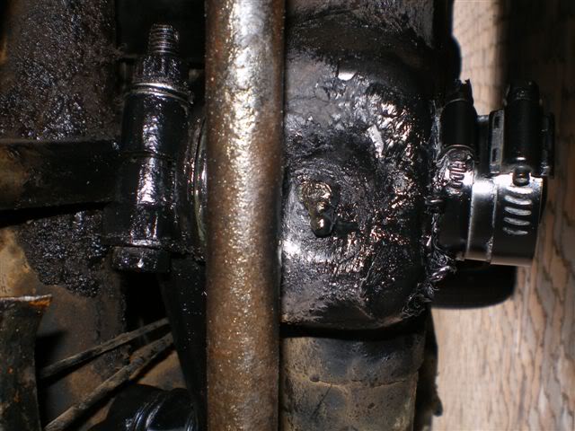

Serviced Master cylinder.... Unknown parts number 211 611 111

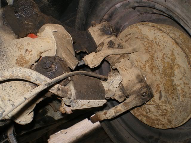

Before pic of king/ link pins and drum
After pic of swing arms ready to fit the link & king pins..

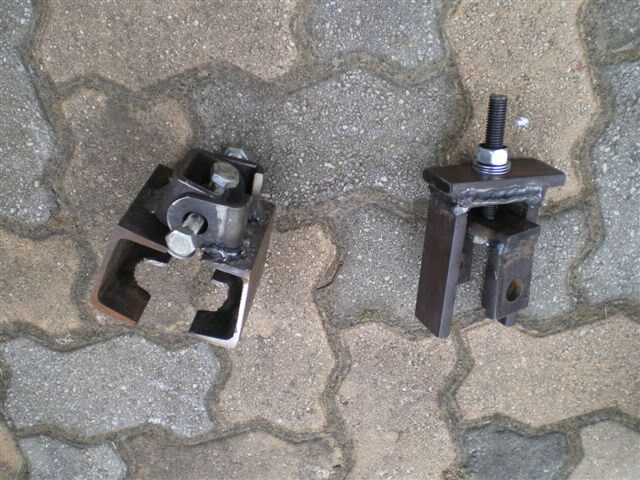

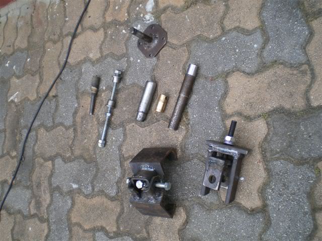

My "Tools" to make the job easer,
The top one is the Oil pump skimming adaptor to fit the oil pump to the lath to reduce/ flat cut it.
The bottom centre is my Steering wheel extractor.
Next to it(bottom right) is my Knuckle extractor, the outer "U" presses down on the stub axle, the small "U" fits over the knuckle pin hole, where the link pin fits, and a 14 mm bar passes through the hole, through the knuckle, and the bolt pulls it out.
The centre line from left to right,My sand paper flapper rod, to clear the inner part of a bush to size, Next my Bush puller inner, Then my bush drift, to knock out bushes. the small brass one does the same.
THe last one is a bush line up tool, and /or knock in tool.
Better view of the steering wheel extractor tool, and the Knuckle pin (king pin, upper & lower) extractor
You will note the Steering wheel remover has a swivel on the two half cups, so that they may hook in under the wheel, to spread the pulling load fully around the base of the steering wheel so that you do not get damage.
You then turn the top bolt and the bottom of that bolt presses on the flush nut and steering rod.
Not very pretty, but they work a treat, Look Ma no more bleeding hands...... :D
