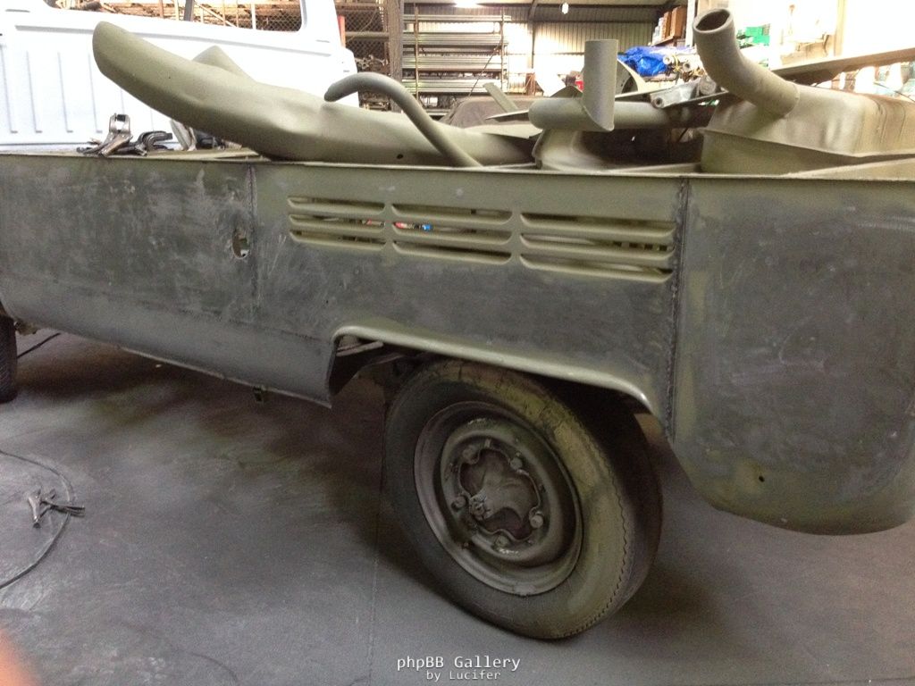

Long side prepped for epoxy primer. After the repair panels were welded in, I sanded down the side completely that had not been sandblasted for fear of warping. I might has well of sandblasted because it was rusted and warped anyway. That paint could not have stayed, although it looked fine with some very fine spider web looking imperfections, the sanding revealed it was actually rust development. Most probably started from a stone chip kind of thing.
Treasure chest outer rocker fitted and sprayed.
B-pillars installed and primered.
Issues with installing the drivers side B-pillar. These guy’s at Autocraft got something very wrong here. This part was actually back to front and the treasure chest outer rocker wasn’t correct either. They were never made to fit. After some modifying and tinkering, I got them to fit. In this case the Gerson panels fitted perfectly on my 59.
