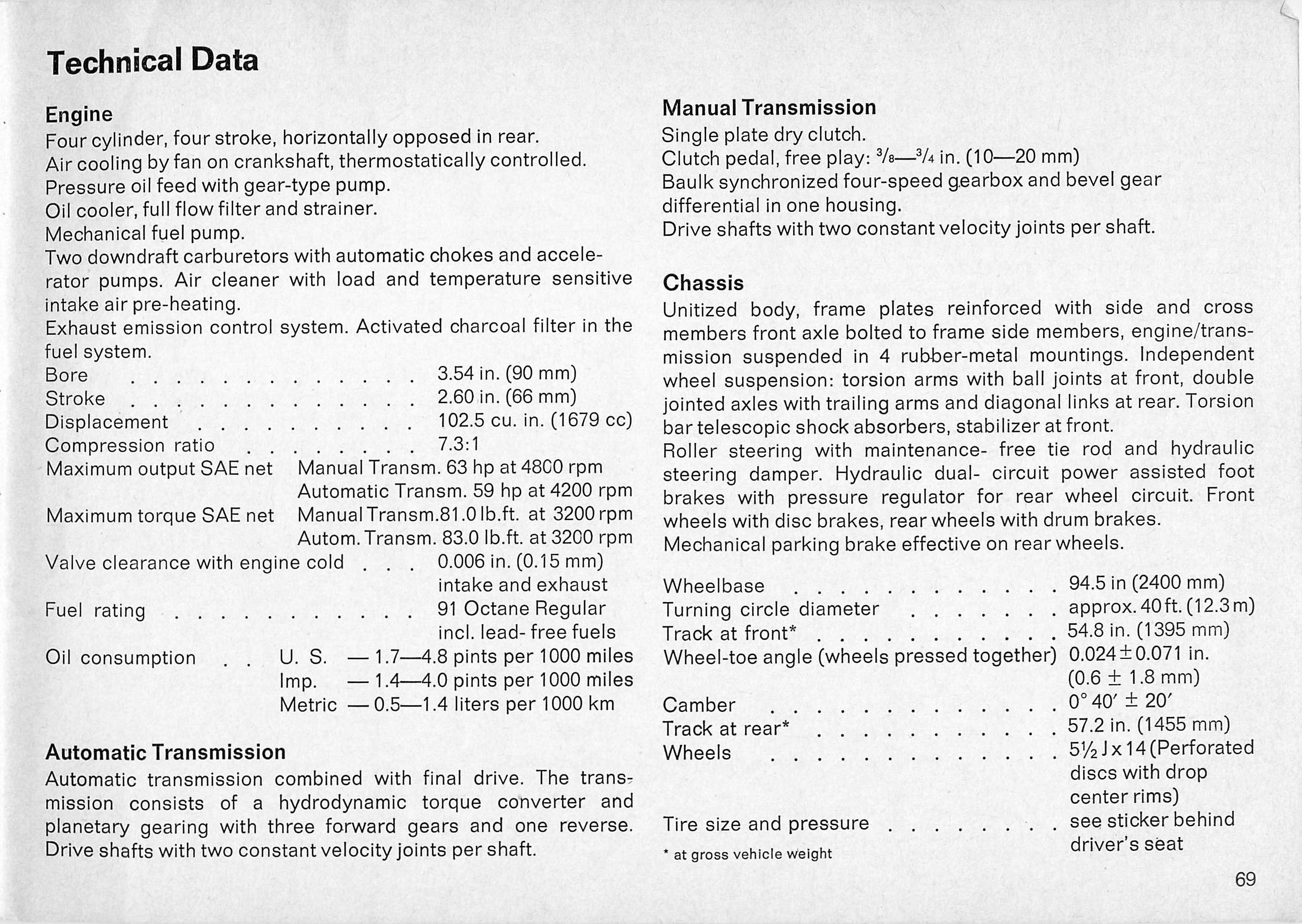

Remember that the 1700 kombi with manual transmission had max power at 4800 rpm. It had a different camshaft than the 1700 automatic. This was done to achieve better matching with the manual gearbox, which still retained the 1600's gearing.
To help a heavily loaded kombi pull away with the 3-speed auto box, and prevent "hunting" between the gears, a different cam was introduced for the automatic, which made less power, now at only 4200 rpm, and more torque.
Later 1800 and 2L manual versions also got the same "automatic" cam, for standardization reasons. This remained the most common type 4 cam. When sending your cam for a regrind, chances are more than 90% that this is what you will get.
This scan is from a USA spec 1700, which had emission equipment and lower power than "rest of the world" models, but you can see difference in rpms between auto and manual engines.
"Rest of the world" 1700 kombi's made 66hp@ 4800rpm in manual version, and 62hp@ 4200rpm for auto.
The fuel injected 411/412 1700 had a different cam as well, making 80hp@ 4900 rpm, and same torque as 1800.
To distinguish between different type 4 cams, VW put an identification mark on each type of cam. By now, this means little, as most have been reground to the most common kombi profile.
