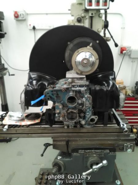

not an update, but I did find a picture of the upright cooling installed.
I had to cut off the breather tower as it was a closed top tower, file the insides and then make a spacer to get the correct height. OK, this picture still has me using steel flat bar to mockup the spacer height.
I think it turned out pretty well.
