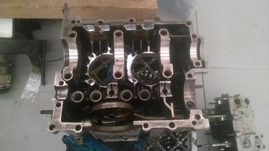

Now onto clearancing the case for the long stroke crank, short rods and bigger pistons.
I hate clearancing a case for a long stroke crank... Anyway, its done now...

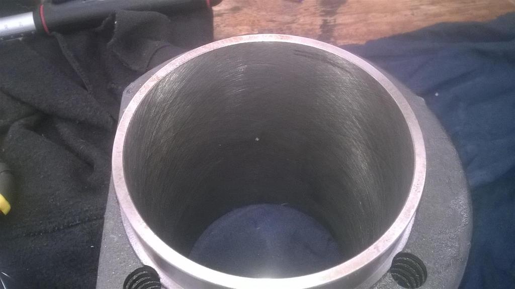

When pulling the pistons out of the liners to measure these all up, I noticed a hole in the one new liner... yay
The best part is that these are imported... so getting a replacement is going to be a PITA.
Good thing I had a spare set on the shelf, I'll deal with warrantee later, for now, I'll keep on with the project.

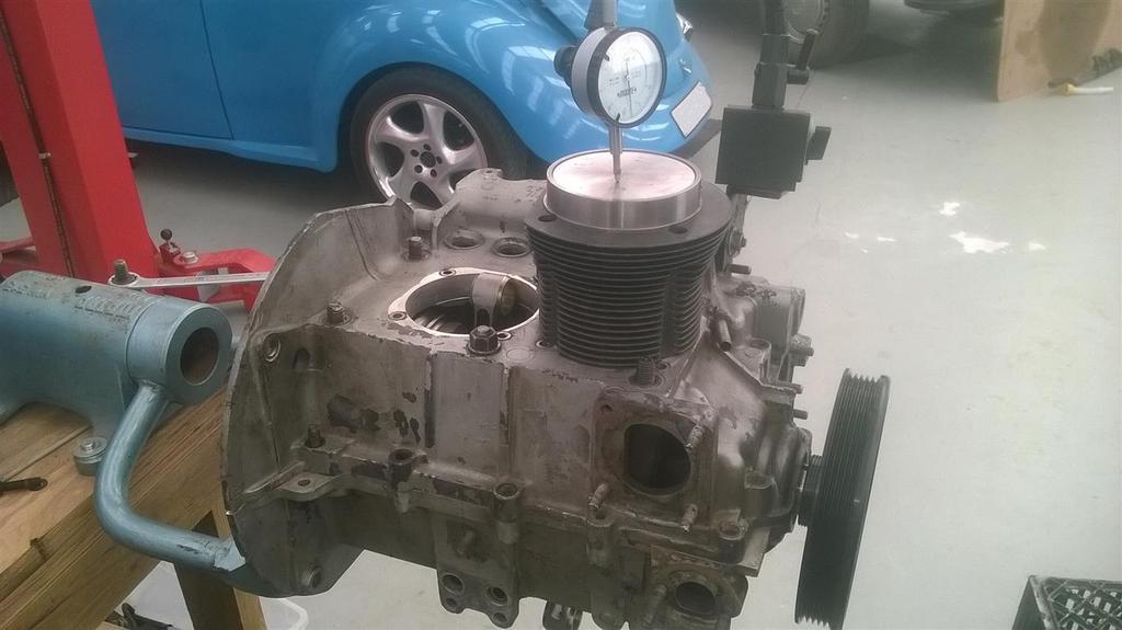

Checking deckheight to calculate the shim sizes that I need

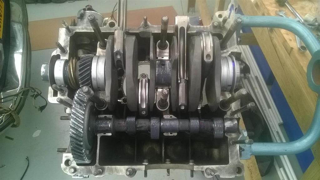

OK, I have to confess that a project like this is slow going.
The first thing that makes it so slow is that, since this is a fully custom engine, everything needs to be checked and double checked. And I mean everything.

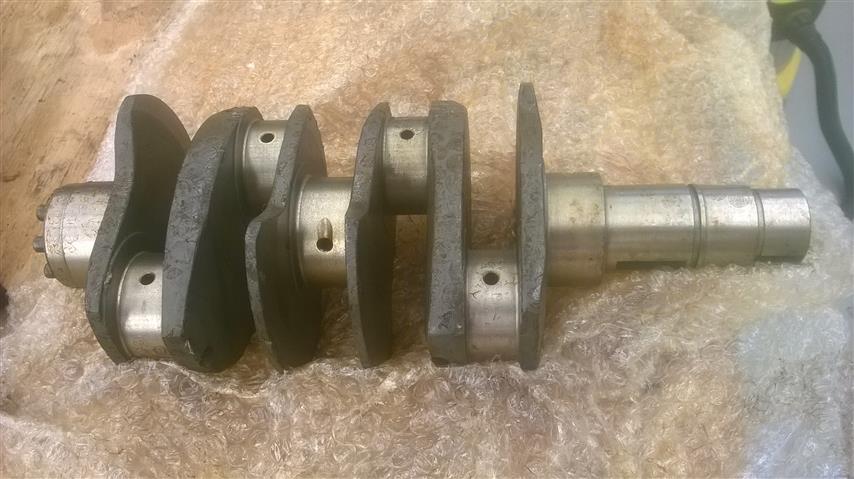

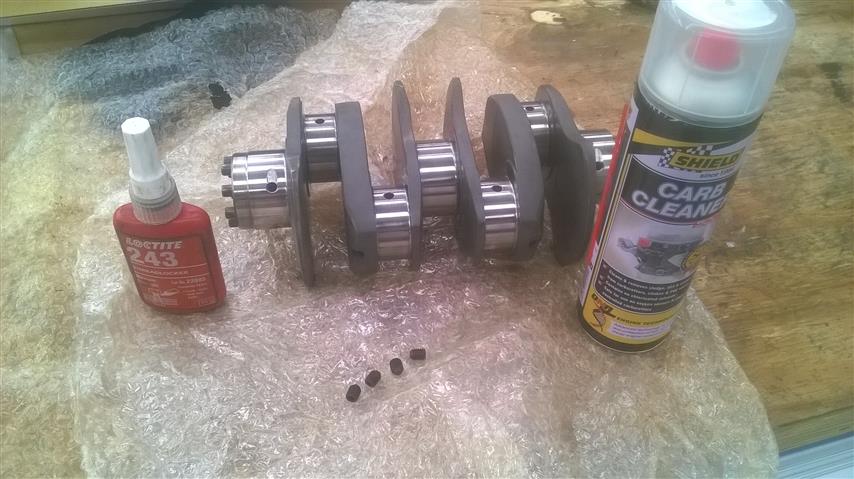

It seems I missed a picture of the crank

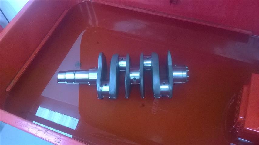

I keep my cranks covered in Tectyl while I store them.
The Tectyl comes off pretty easily in paraffin
Ant then for anyone using a new crank, this is a vital step which must not be forgotten
Remove the grub screws from the drilled oil galleries, clean the internals of any swarf that might be left behind and then loctite the grub screws back in. If a grub screw comes out, you might or might not have damage from it flying around, but you will loose oil pressure as the oil is now free flowing out of the crank instead of going to the various engine bearings and this will lead to a fairly rapid seizure of the engine.
Slowly coming together

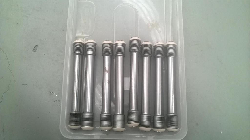

New pushrod tubes with imported silicon seals
long block nearly finished

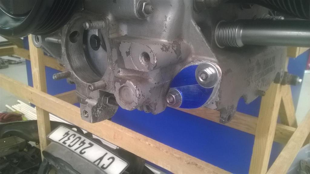

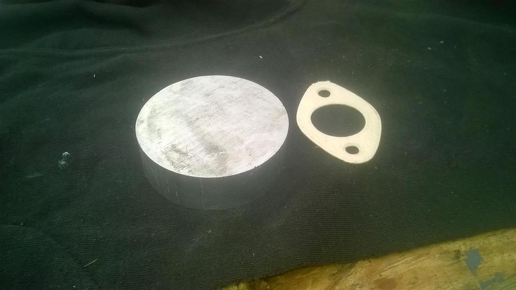

And then, since the case is a universal replacement case, it has the type 3 dipstick tube hole in the block
Since I dont have any use for it, it needs a blanking plate.
Question is, where to get one?

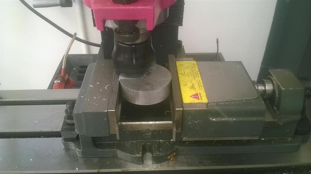

Well, screw hunting and spending money on fuel, I'll make one.
Find the gasket in a gasket kit and use this as a template (after making the bolt holes bigger so that the gasket fits)
Then grab an aluminium offcut and begin
Make smooth and flat
fast forward 90min

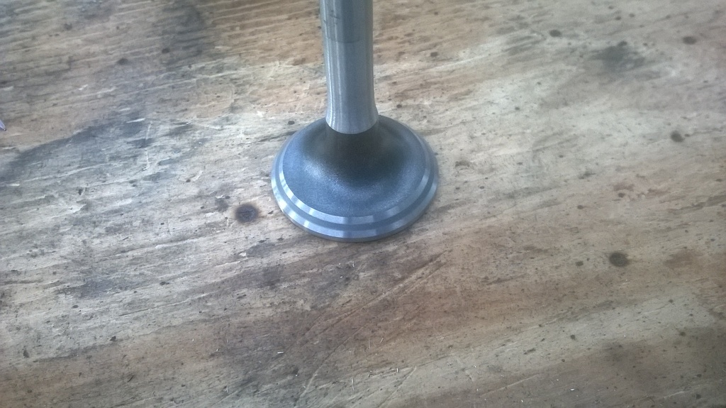

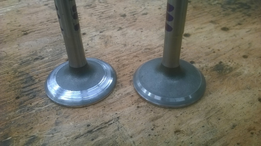

Coming back to the heads.

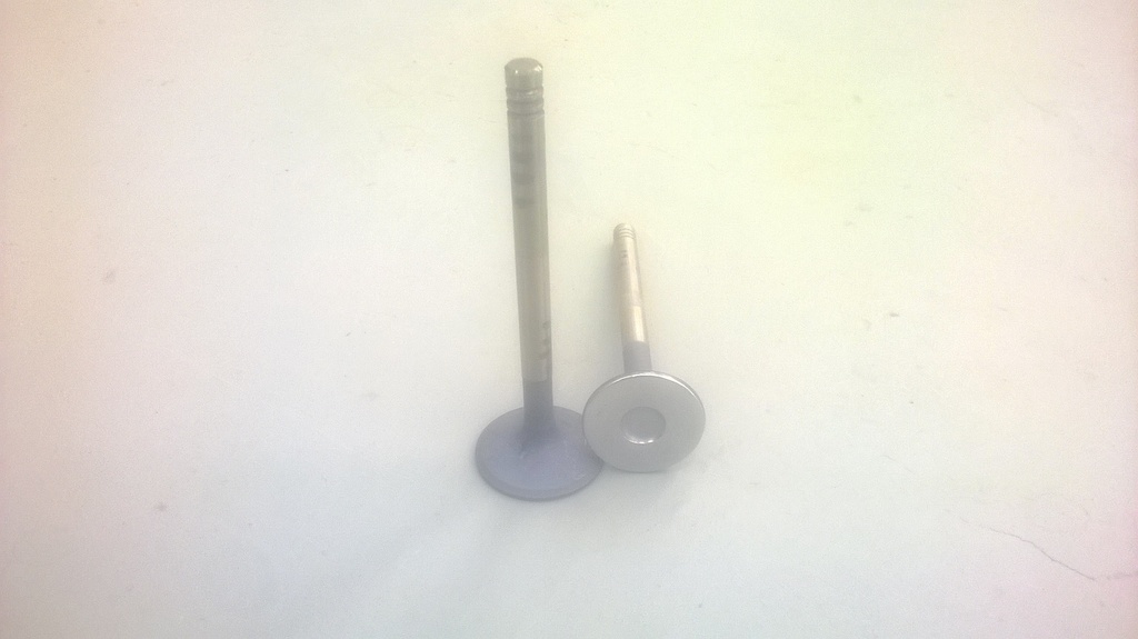

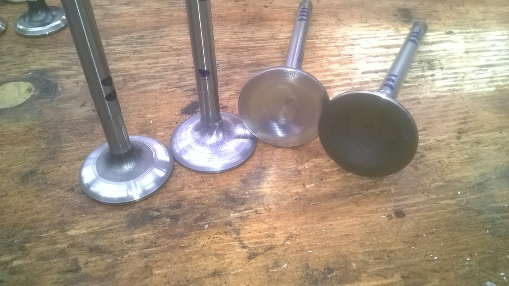

Here you can see where the stock valves seated in the stock valve seats. The grey ares on the valve seat is where I lapped the valve to check the seat location. You can see how high up on the seating surface it sits. This basically makes a 35.5mm valve have the same effective size as a 33mm valve. So some time needs to be taken to move the seat out a little to ensure maximum air flow. This also results in me being able to cut a longer 60* entry angle into the seat to improve the seats airflow efficiency.
And now you can see below two inlet valves, the one on the right shows where the seat has now moved to, while the one on the left has been backcut for improved airflow
And now below, the valves are slightly polished before being sent off for ceramic coating. See the difference between the unpolished valves (dark areas on valve head/poppet)
And now, the final ceramic coated product

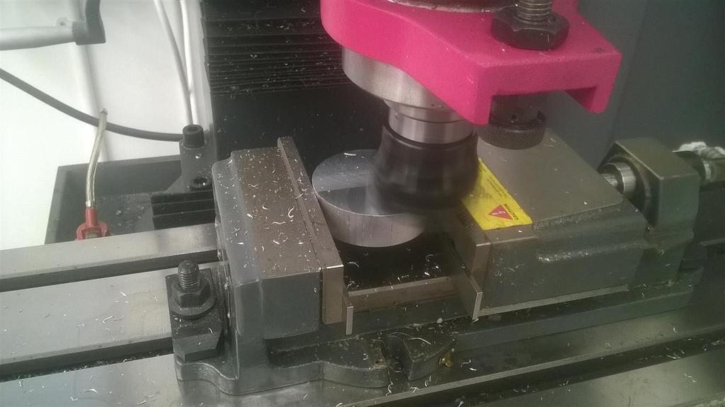

But I needed an oil pump cover.
All my steel covers were well worn down, so the logic is to make one smooth in the milling machine but I couldnt find a way to hole one down properly, so I scrapped that idea.
Next option, put sandpaper onto a sheet of glass and lap the cover until flat... nah, too much effort.
Third option, use an old aluminium full flow cover and plug the cover. Nah, I could use this cover in the future somewhere...
4th and final option, make a new cover. So I grabbed an offcut of aluminium and made a 10mm thick cover.
Before and after

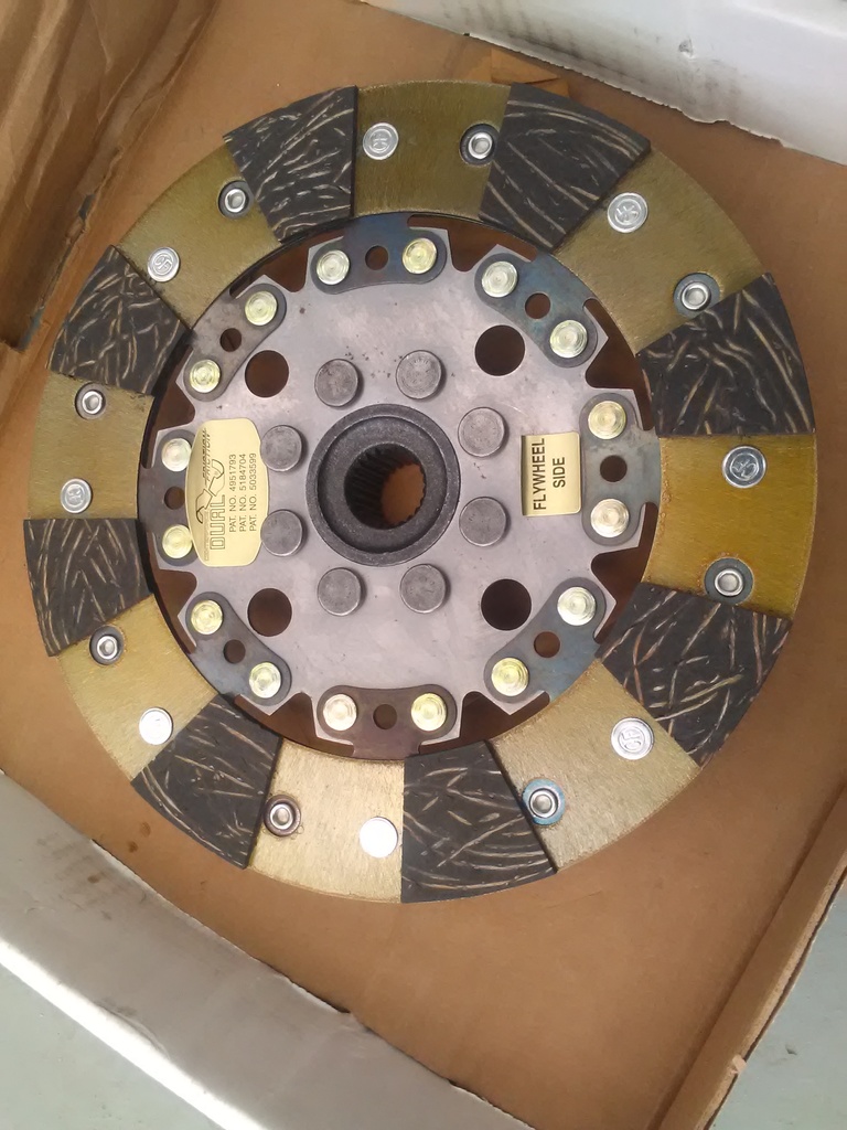

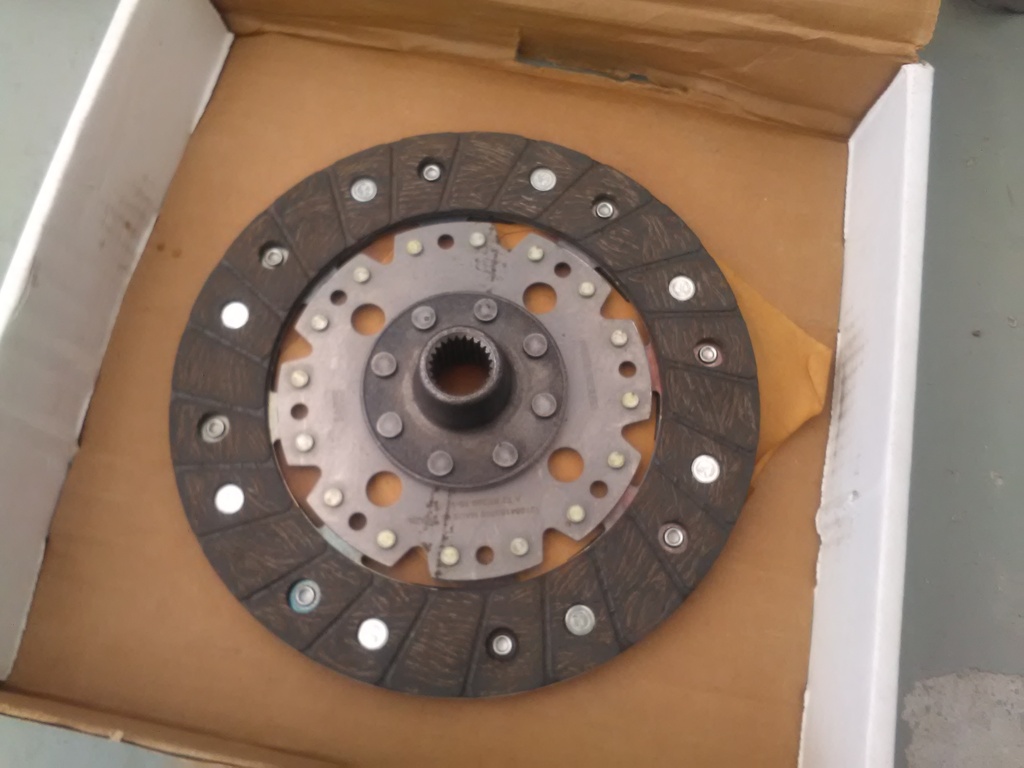

Now onto the clutch....
more power, more torque and using a stock 200mm flywheel and pressure plate.
I wanted to keep the clutch pedal light, so upgrading the pressure plate from stock to a stage 1 was not one of my options.
With this in mind, I had previously imported a dual friction clutch disc which can handle more torque than a stock clutch disc, but still provides smooth engagement. I use one similar in Angrrr with great success.

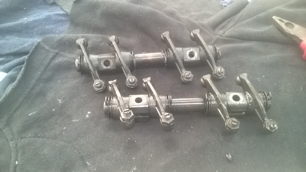

And now rockers...
Take and old set apart to use the rocker arms.
Fit the arms onto a solid shaft with bolt on end caps instead of the clips. Also, instead of using wavey (Belleville) washers, flat shims are used. These shims need to be adjusted and swapped out to keep a tight floating clearance on the rocker arm while lining up the rockers with the valve stems (slightly off center to the stems).
This stops the rocker shafts from coming apart due to the combination of higher rpm, more radical cam and heavier valve springs.
It also makes the valve train a fair bit quieter than when using the stock rocker shafts with the big cam combo.

Final setup installed

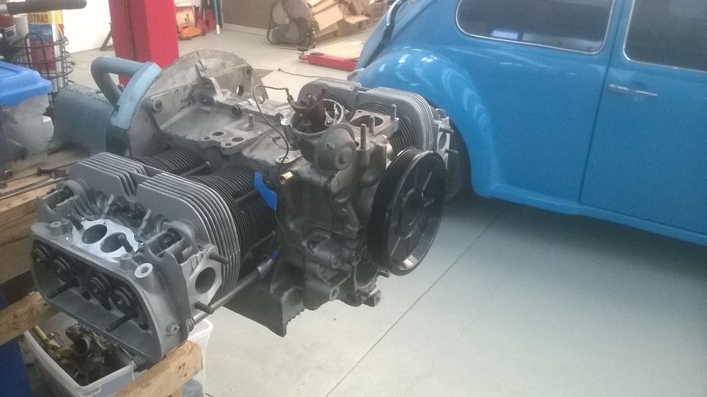

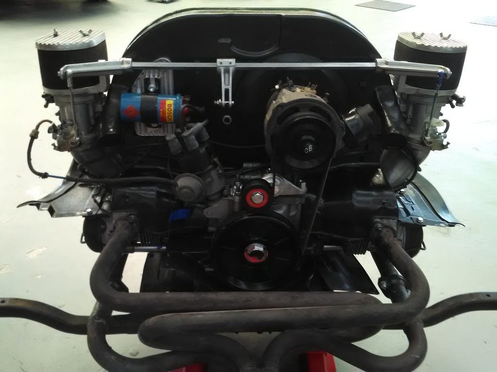

Then fitted CB serpentine pulley and belt system. This was actually bought for my 1302 but I wanted some bling for this engine too, so I used it now....
Engine together and ready for install...
but wait, there is more

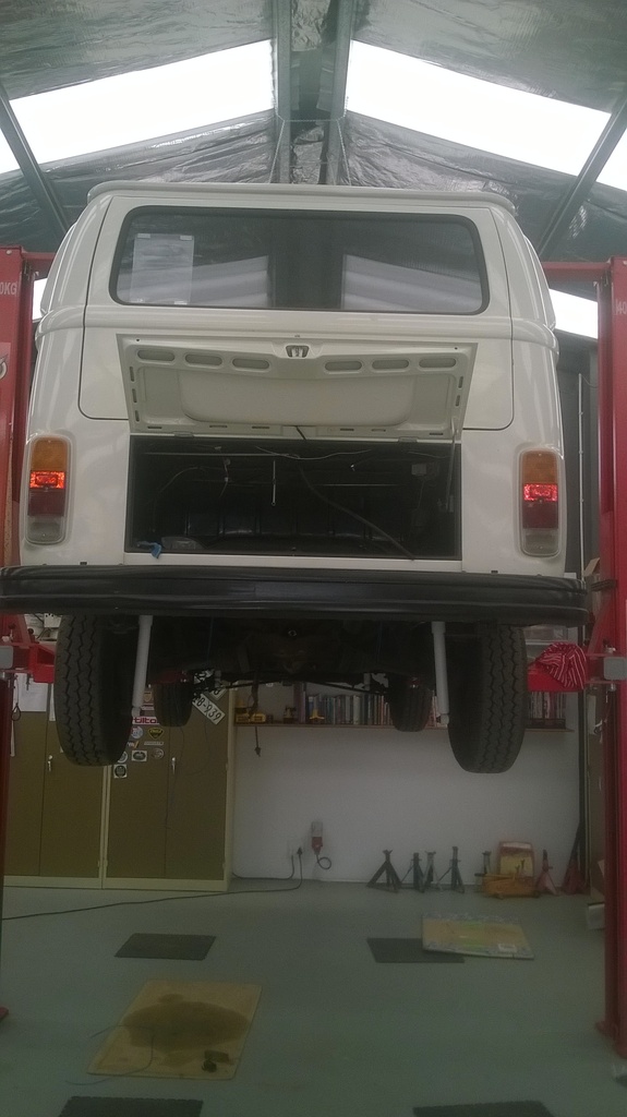

The bus is on the lift
But something is missing
One of my ideas for the bus when fitting this bigger engine was to be able to use the power to make cruising easier, quieter and if needed, able to go faster without over-revving the engine.

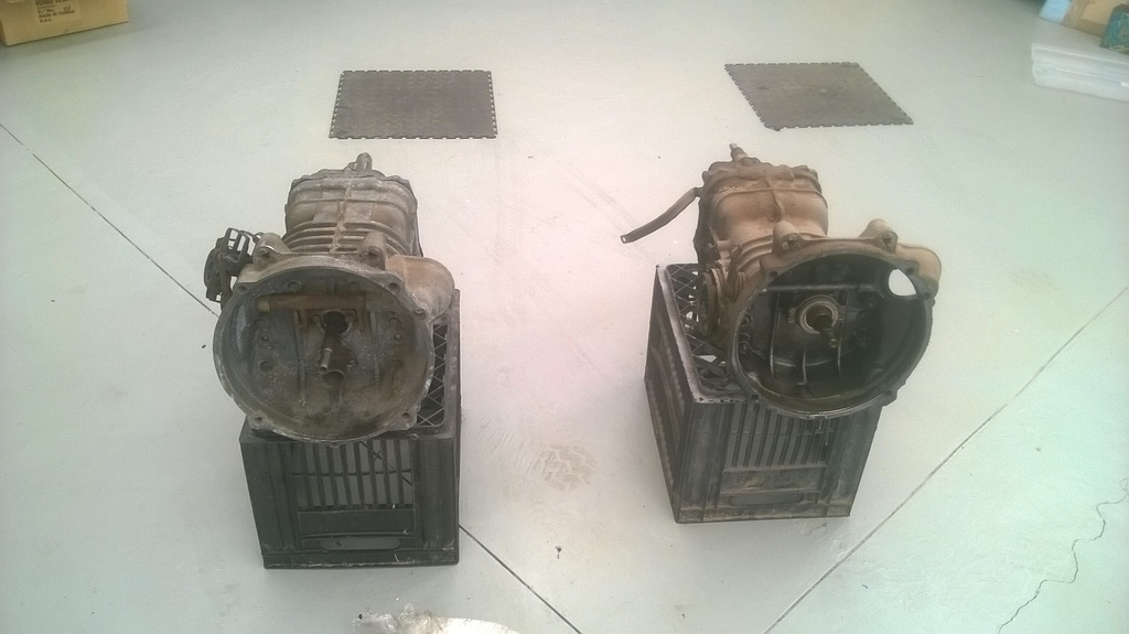

So I sourced a 2L kombi geabox and had Bugger recondition it. This is to replace the lower geared 1600 gearbox
Like I said, I have been planning this engine build for a while
Two boxes together

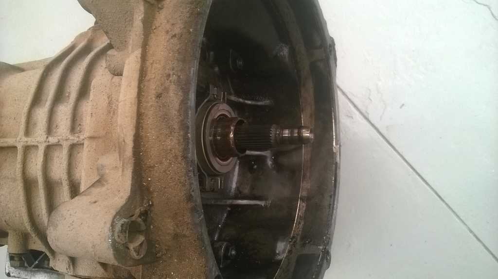

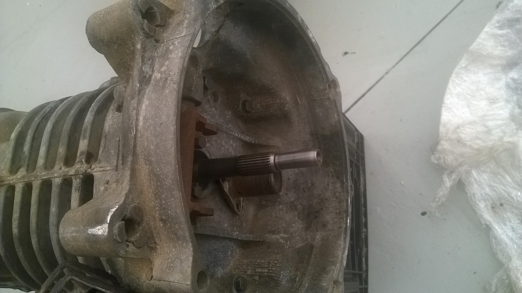

Now you will see that the 1600 gearbox has a shorter input shaft than the 2L box.
The 1600 box was made for the type 1 (beetle) engine, while the 2L box was made for the Type 4 engine.
Now the correct way to fix this is to swap the bellhousings and also the input shafts around.
I swapped the bellhousing, but the input shaft I could not get out. All the tutorials online say to remove the input shaft after popping off the bellhousing. But this 091 gearbox must need it done in a different way as I couldnt get the shaft over the diff.
The diff in itself looks like a much larger unit than in the 1600 box and also has 4 spider gears unlike the 1600 box which only has 2. So its a massive upgrade as far as the gearbox's strength does.
How to fit the T1 engine to the T4 input shaft? Especially since I wasnt going to take a newly reconditioned gearbox apart.
Simple, take an angle grinder and remove 14mm off of the shaft.
Now the shaft will fit into the bearing in the T1 glandnut without bottoming out. Just remember that if you do this, and you wish to fit a T4 engine, you need to get a spigot shaft bearing and fit it to the flywheel of the T4 as the input shaft no longer reaches the bearing in the crank.
