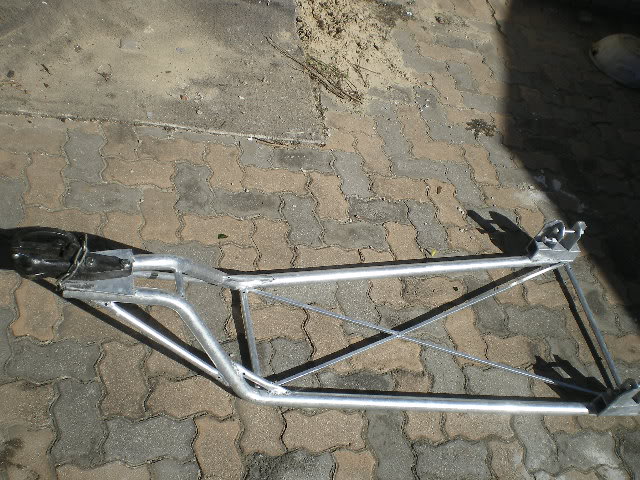

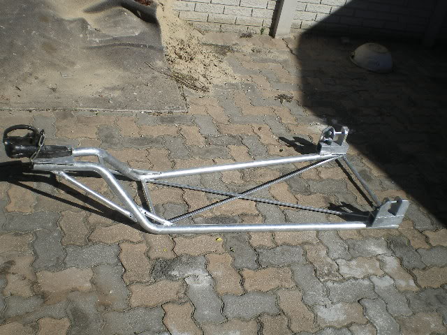

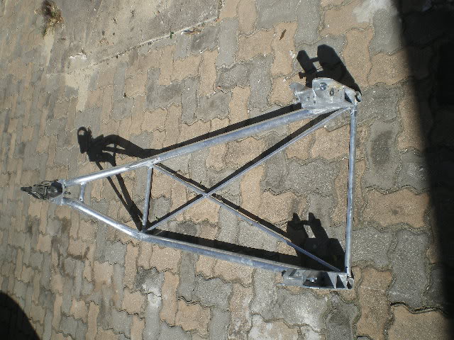

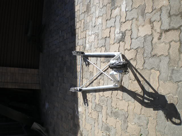

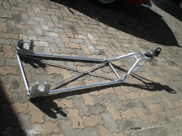

Well finaly, I got all my Ducks in a row, and got the photos, worked out the price to manufacture this A-Frame, and also looked at making it a "fold-up"
The truth be told, I think it would be unwise to make it a "Fold-up" but Hey, that's just Me.
Will be easy enough, all you do is cut it in the centre, fit smaller pipes into the one side, and plug weld, and make two bolt plates for the centre cross.
The Price as follows, Supply of pipes and bending.....R 430
Galvanising .........R 200
Welder time ........R 450
Hitch and chain .........R 220
Profit ........R 50
Total cost if you guys want one ..................R 1350.00 excluding transport and shipping.
Best I can do guys, Sorry.

Thank you, as the main pipe that takes all the twisting forces, when things go wroung, is made of 3mm wall thickness, the machine to bend this pipe, is a monster.CooP wrote:Seems very reasonable to me
Will never make them out of thiner steel, and sell them with my name on it, like the beetle bars, on the Samba. for $150.
Will be placing the drawings on this thread, then each and every Volks, can make his own.

Frame looks cool and no doubt you have looked into this but how about making the thing to fold. eg a pivot at the hitch end and the hitch plate to bolt when legs are open and the cross members that can be just bolted. We could leave this folded in the car when going for treasure hunts. Just part the legs drop on the cross members and away you go.
Just a thought
Just a thought
- Bushpig
- Posts: 707
- Been thanked: 5 times
Re: Towing A-Frame for Split Bus & Beetle
Herman, sorry just found the post about the folding - when would you test one that folds?
- Posts: 8709
- Been thanked: 539 times
Going to use the spare one I made, turn it into a fold up, and test it, will let you know.Bushpig wrote:Herman, sorry just found the post about the folding - when would you test one that folds?
