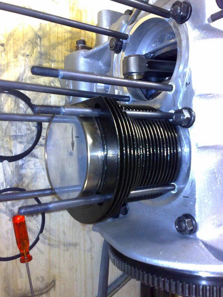

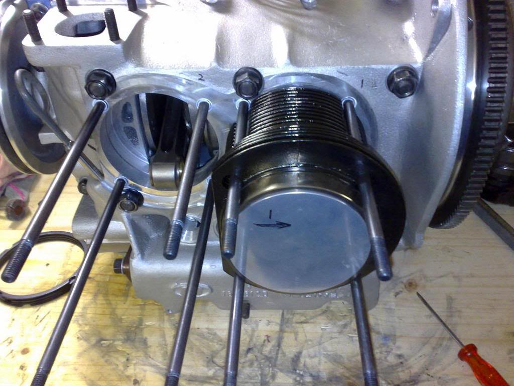

I have got these pics from my engine build to demonstrate the deckheight idea
Here you can see the barrel and piston assembly, but the piston is sticking out past the end of the barrel

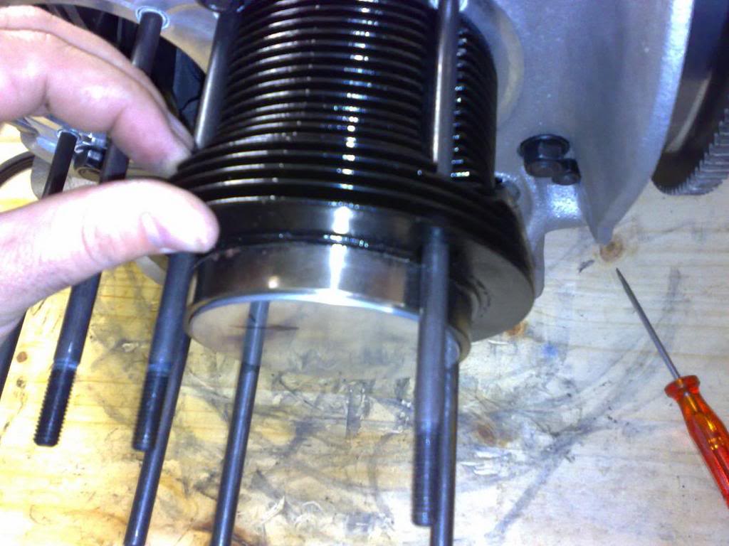

So I added a 1.5mm barrel shim
I then also added various bits of shim stock that I had cut to size until I ended up with a deckheight of 1.05mm
