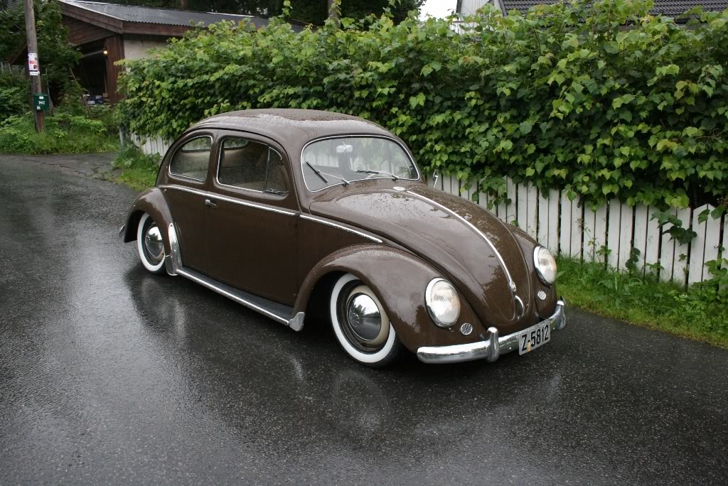

Thinking of making it 2 tone, with white sides,
Any opinions????

I prefer the current colour scheme to two tone with white. I think white will be too much contrast. At the same time. You have to look at your bug more often than me so you should really pick something that you like. I like John Lemon's coral bug. I like the grey ones. I like the VW dove blue. I like subtle two tones. Like brown and black gray and blue.

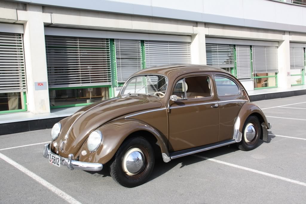

I must agree with you the right colour for my 59 is VW dove blue and white, BUT, ........it is brown now, and looks depressing, its a nice colour, but not on this beetle, do not know why ??Drusky wrote:I prefer the current colour scheme to two tone with white. I think white will be too much contrast. At the same time. You have to look at your bug more often than me so you should really pick something that you like. I like John Lemon's coral bug. I like the grey ones. I like the VW dove blue. I like subtle two tones..............
Have a few images here, if any body would like to comment, also....
If anybody has PHOTOSHOP, could you please take a photo of my Beetle, and paint it with white two tone, or even other colours, lets see what it looks like.

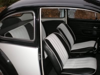

My Beetle looks good with Ivory 2 tone, white will be to much..
Any other suggestions..........

That's why I think the Ivory 2 tone will give it a Twist. 2 tone seats, get ride of the Black roof lining, and get it back to LIFE, Wonderful, Wonderful LIFE........

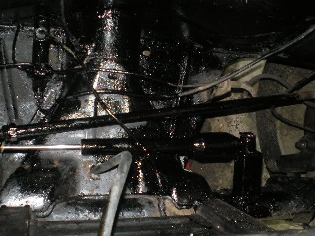

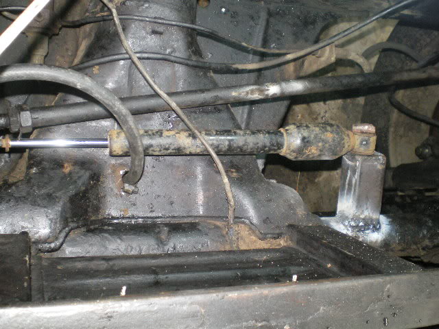

Well today I fitted the Steering damper (2nd Hand) back onto the beam, as someone had cut it off, (marks still there)
Had to make a new box mount, as this was gone, and re-weld it on to the beam without burning the car out.
Here is a photo of it just welded in,
and here with it painted,
