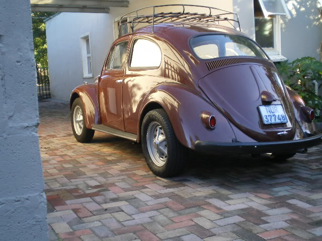

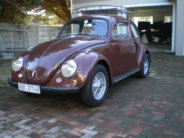

Here is a more cheerful looking 59 Beetle.
Now I have to take her for RWC, and onto my Name......
What you guys think ?????????

Looks nice! Glad to hear that you have already worked through most of your "to do" list, (that was fast!), and it's now running well!
- hitlers revenge
- Posts: 6486
- Location: back in the 'Fell
- Been thanked: 36 times
Re: 1959 Beetle.. Before and After
Its a matter of taste but I think it looked better with black rims and hupcaps.
- Posts: 10783
+1 The KDF -Look is gone....But personal preferences I guesshitlers revenge wrote:Its a matter of taste but I think it looked better with black rims and hupcaps.
- splitbusahollic
- Posts: 1265
- Facebook: vintage kombi
- Has thanked: 87 times
- Been thanked: 54 times
i also think the black rims looked better.....
now it looks like "any other beetle"
