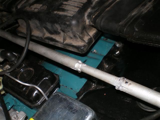

The stub manifolds went in and the balance/ideal bridge pipe was also fitted, after modifications.
Had to make up the joint accelerator shaft, with settable connector shafts to the two carbs, make up a cable bush, and connect it to the shaft, with adjuster.

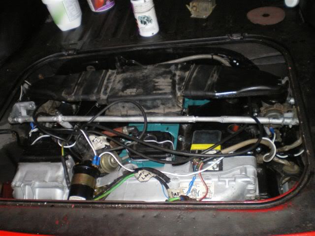

Hi Guys,
Here are a few photos of the engine in place and all working.
As can be seen from the photo, the left carb has the Idle towers on it, so no Pancake filter will fit without MAJOR modification.
So have tried the STD Van filter box, and it sits well, only the dust box, under the paper element, it is too big to fit. SO....
I will be cutting a section out of it, just under the paper element, and re-assembling it again so that it fits into the space seen here....
Once that is done, I will be neatening up the wires, and pipes, so the engine compartment looks tit.

Herman, what is holding your coil in place???
- Posts: 8710
- Been thanked: 541 times
FAITH............hitlers revenge wrote:Herman, what is holding your coil in place???
. Sorry, could not resist,.......
Just joking
No, I drilled and tapped it into the casting, as there is a thick section there.
The voltage regulator is also drilled and taped. (silver box to the right)
Wanted it on the engine, so that all move together, but as you can see, the engine compartment is getting a bit voll jong...
When I clean up the wires, you will see what I mean, Its all fitting very nice, and compact.

Congratulations on getting it started.
There is the original mounting point just to the left of the coil, or were you missing the original bracket?
Are the carburettors happy know or are there still issues?

Hi there cool mile stone
coil fits in std location on a type4 into type 3 as well
The regulator might not last there they were removed from the engine compartment for a reason
Armand
