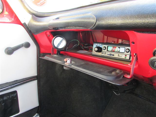

So I decided that its time to work out what the new long 4th gearbox does as far as engine rev's
The best way is to fit a Rev counter, but that will be a bit takkie, even I have my ethics.
Right so it will have to be a hideaway unit, .....
As said by Tony, maybe fit it temp. and mark the speedo, then you will have it.
OK, so now my take on it is, fit the rev counter get use to the gear changes and top speed revs then move it to the next car.
So here is a photo of the Rev counter fitted as seen from the drivers seat........
So how do you like it.....
OH! sorry, lets try that again...
Well now I can use it when I need to, and hide it when not used. Yes it is fixed to the glove box lid, and slides neatly into the glove box when closed.

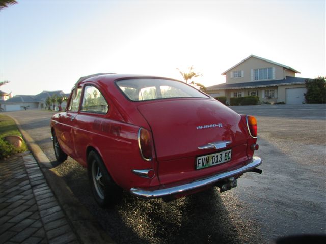

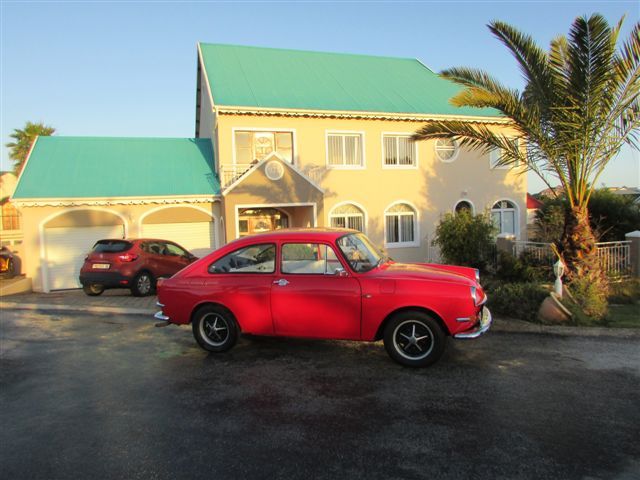

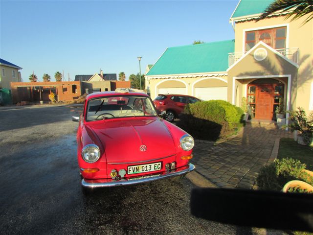

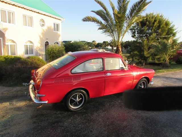

Decided to wash the Fastback as I had her out to stretch her legs,
Bit wet still but ..
and finally dried off ready for bed....

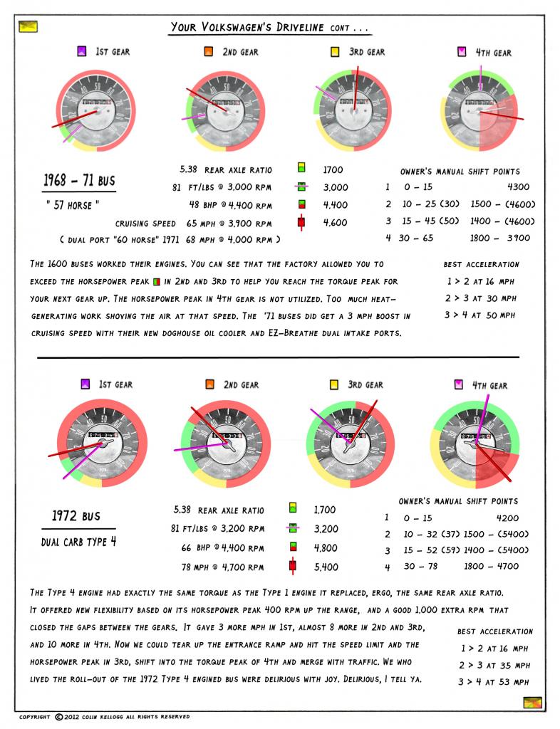

No we took her for a highway drive and made some notes on her speed/ engine rev ratio.
Makes for interesting reading, as it near perfect from one gear to the next.
1st Gear 4000rpm = 20 Mph
2nd Gear 4000rpm = 40 Mph
3rd gear 4000rpm = 60 Mph
4th Gear 4000rpm = 80 Mph
80 Mph = 128 Kph
So what is the recommended cruising rpm for a type 4 2lt motor ???????
