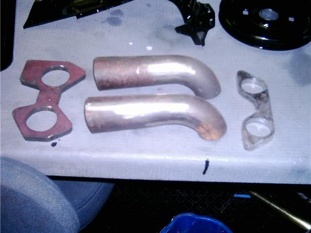

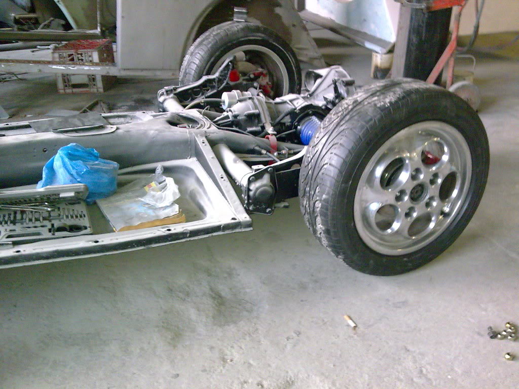

Hey all got some updated picks from impi on my motors progress..... coming along nicely..... he is da man

![Image](https://www.aircooledvwsa.co.za/images/pbucket3/albums/dd195/65looker/motor.jpg)
i heard if i want to run fuel injection i must use a fuel cell? is this true or can i still use the original tank with a 6mm return on it? I would like to use the original tank

No you dont need to use a fuel cell
You can modify the bottom of the tank to a larger diameter hydraulic tube bend that fastens the std way and
SEND THE TANK INN TO GET THE RETURN pipe FITTED ON
It is also not a must to use a surge tank but it is advisable to feed the EFI pump then

That IMPI 'shroud looks so good ![Hang Loose :hangloose:](./images/smilies/action-smiley-035.gif)

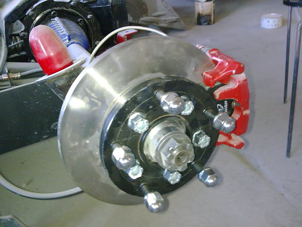

got the adaptors on 5x100 up to 5x 130 pcd

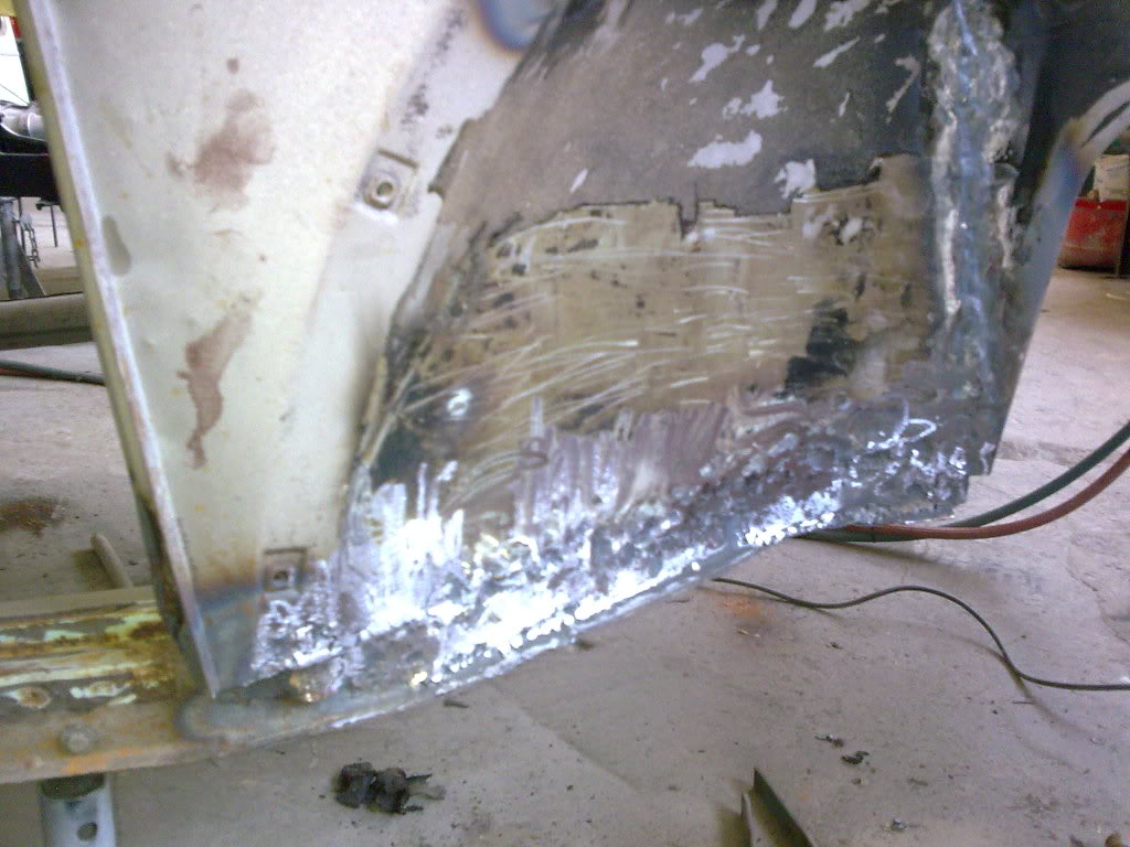

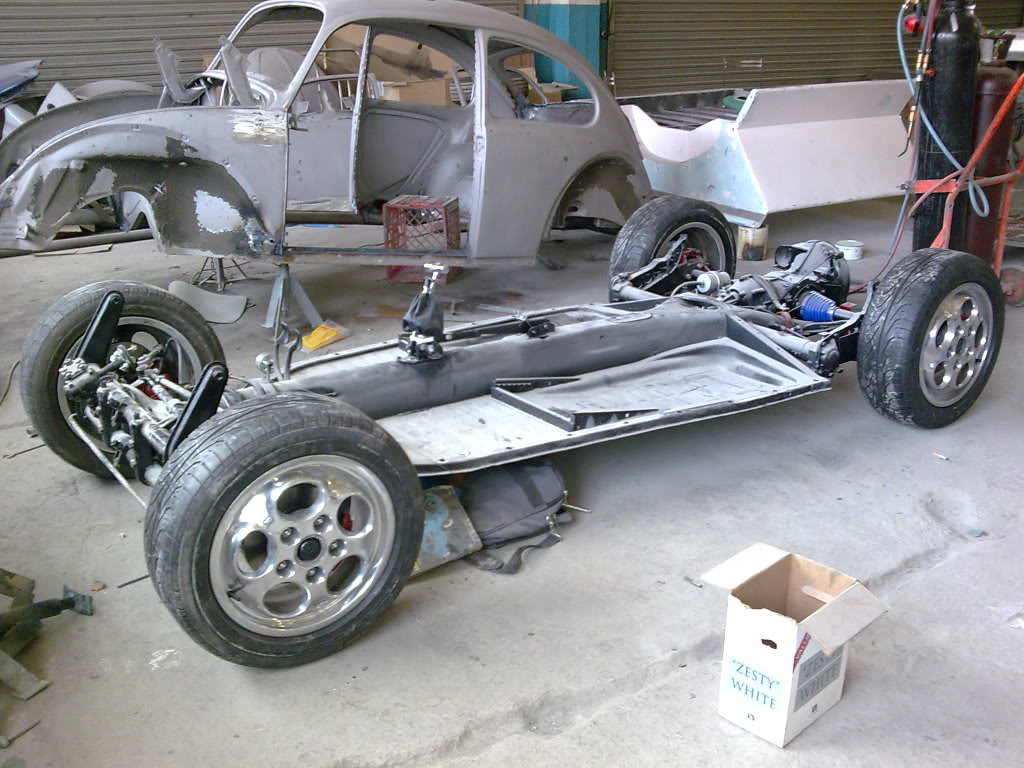

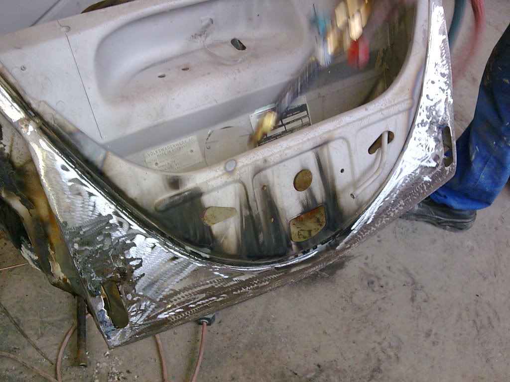

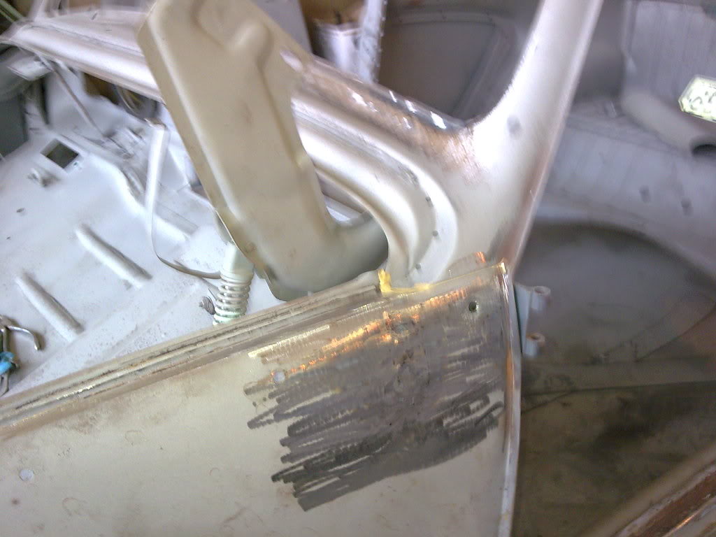

got the wheels on and body work has begun
![Image](https://www.aircooledvwsa.co.za/images/pbucket3/albums/dd195/65looker/Image007.jpg)
![Image](https://www.aircooledvwsa.co.za/images/pbucket3/albums/dd195/65looker/Image005-1.jpg)
![Image](https://www.aircooledvwsa.co.za/images/pbucket3/albums/dd195/65looker/Image001.jpg)
![Image](https://www.aircooledvwsa.co.za/images/pbucket3/albums/dd195/65looker/Image000.jpg)
