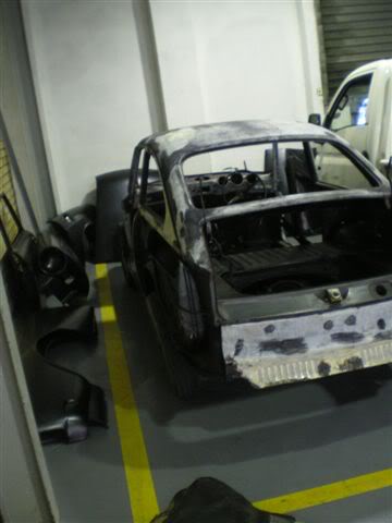

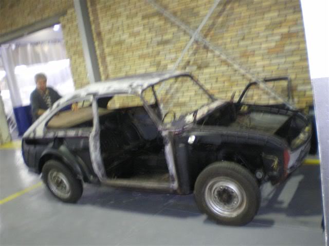

Hi All,
This thread will be a bit thin while the car in in the spray shop.
Will be doing the loose parts 1st, then the body, so as to protect the loose parts, in My store, during this long process.
Here are a few of the car, as hopefully this will be the last time , looking like this, and more looking like...........(will have to wait)

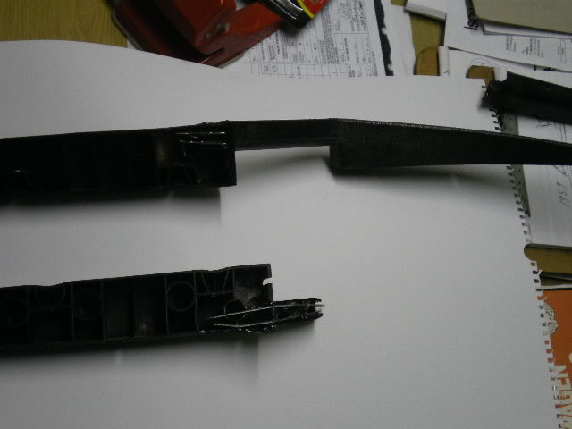

I am doing the small things that I wanted to do once I start assembly.
So the arm rests were repaired by inserting steel stiffeners in to the broken joints, then repaired with 10 minute epoxy.

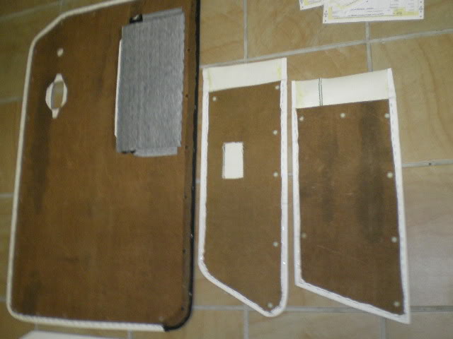

Have at least got my door panels done,
to match the seats,
with NEW back boards and all.
