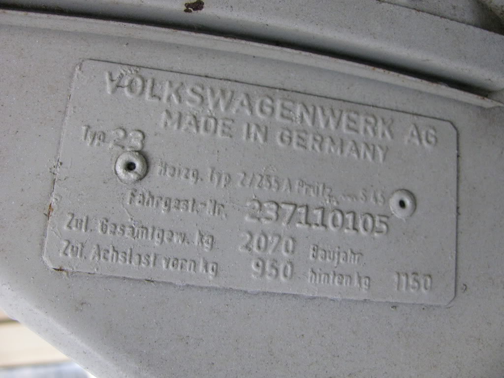

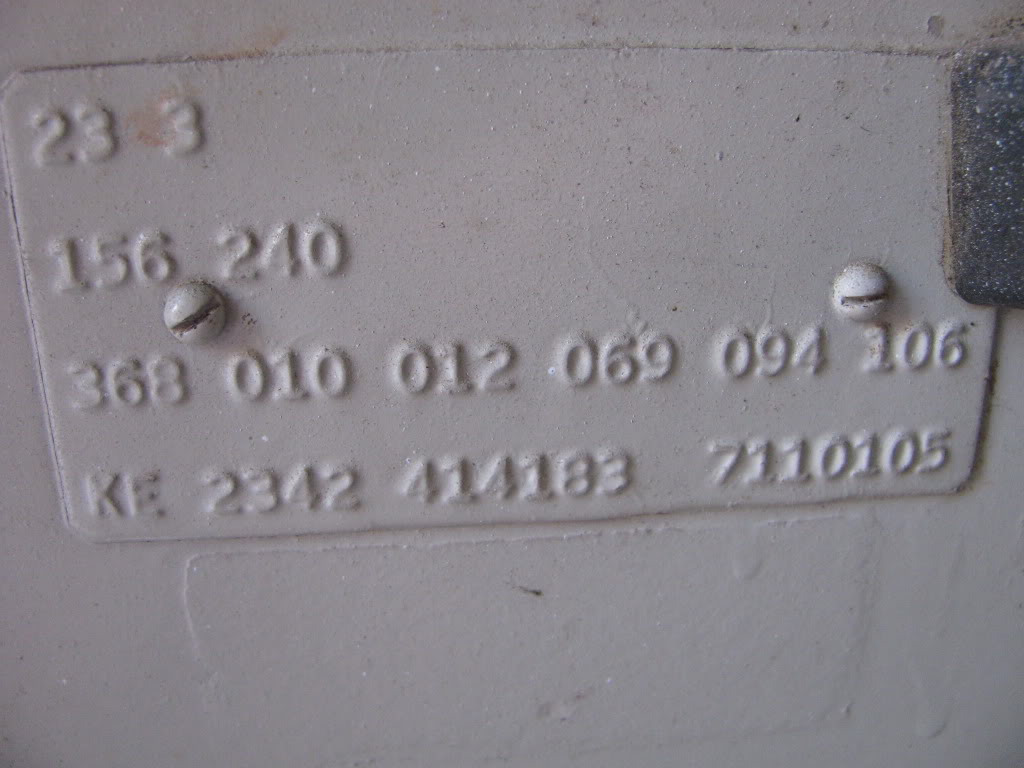

First off, the full VIN is on the VIN plate on the overhead air vent. The VIN on the M-plate is short the first two digits, which give the model. So the full VIN 237110105 says it's a Type 2 (2), Kombi (3), 1967 (7) and it was the 110105th bus of the 67 model year.splitbusahollic wrote:
