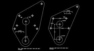

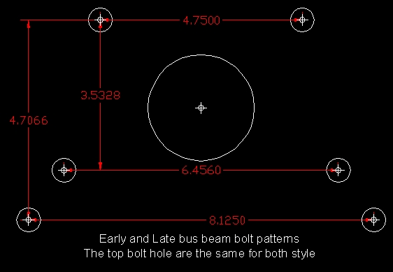

When I did some investigations into this I found that the very early Bay beam will fit bolt for bolt.
Have not tested this as I did not have an early Bay beam, I had a late bay beam.
The Pic is of a Fugly beam, which is the same as a split, there is no advantage of swapping out these beams other then if it is in better condition.
So to fit my beam, I had to cut the Beam, not the bus, as the old beam can then go back if need be, and the cut Bay beam can be welded up and used in a bay again. So very much in keeping it restore-able.
The Fugly has the same beam as the Split Bus, so now you can measure it and see if it will fit.
As Sean said, remember the Bay beam will increase the ride height by 25 to 40 mm so if you use big wheel you will get the raised look, but if you want the dropped look, this will not work.
If you need info on how I cut the beam to fit, let me know and I will post it.
