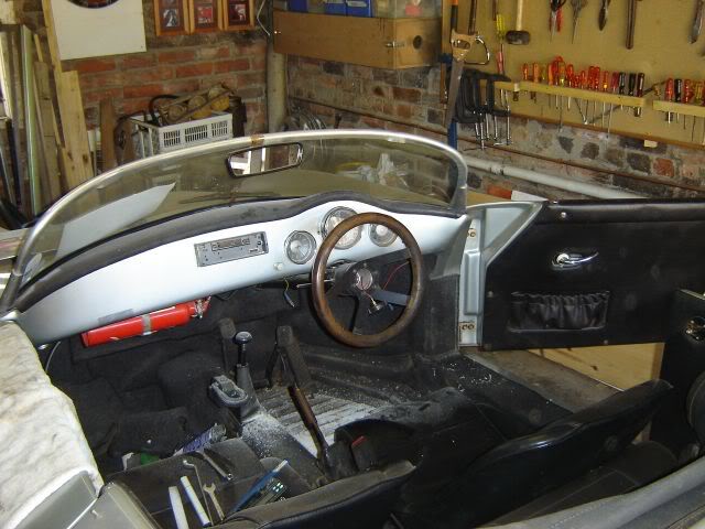

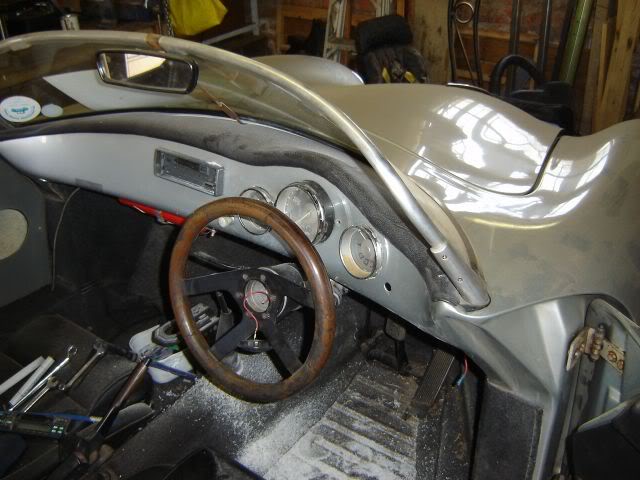

Update:
Well the long weekend gave the time to do a few naggling things that I wanted to do, including removing the old gauges and see what the condition of the wiring is like under that dash.
First thing was to cut the holes for the new gauges that I'm going to be fitting.
Pretty straight forward, the dash appears to be almost 10mm thick. I was quite impressed with this. The gauges still need to be fitted correctly, but I'm happy with the look.
They're in. The centre hole will have to be filled as the previous gauge was flush mounted from behind, so I'm still going to consider what I want to do here. I may flush mount the new gauges as well and have new billet rings machined to clean it up somewhat.
The wiring by the way, is terrible.......I'm going to end up ripping the whole lot out........DIY home cable etc etc, this pretty much shows me that this car was built from a kit........it's a fire waiting to happen.
I also got my pass side handle sorted out and this week will be new hardboard for the doors and then the search begins for some nice gas shocks for the hood and trunk as well as a hood release mec for the engine lid and a modified golf mk1 handle for the release.
Stay tuned.
8) looking nice
Are those gauges from a Type3?
Posts: 4195
Has thanked: 36 times
Been thanked: 50 times
Post by flatfourfan »
Yup, IMPI donated them to the project, they will still have to be stripped/ cleaned and also have the faces changed.
flatfourfan wrote:Yup, IMPI donated them to the project, they will still have to be stripped/ cleaned and also have the faces changed.
Looking good!
Much more unique than shelling out on Porsche gauges :wink:
