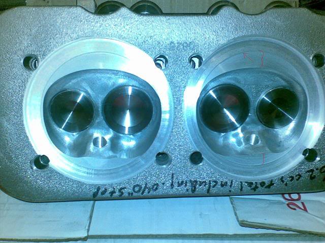

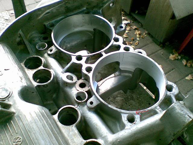

At least this part of the buggy build is still going as planned. The engineering shop (ENSCO in VDBLpark) is done with the heads and case - opened them up to accept the bigger cylinders.
The ridge shown in the top photo will have to be remove, I'm worried that the cylinder spacers (that I'll have to install) will not seat very well on what is left there, so I'll have it machined down and flat in that area. The heads, well what can I say, they will accept the bigger cylinders, but somehow I need to find a way to fill up the 1mm cut that my American friend did (arrows). The cut moved the quench pads away from my dished pistons, so no squish available at this time, which is probably a bad thing :D .

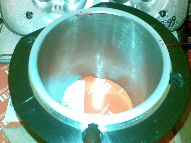

On to the QSC aluminum Nikasil cylinders. Some bad news there I'm afraid. The sealing edge on the heads side, were so bad that I had to have them machined down a little. This turned out to be a good thing, because they were found not to be of equal length, so we corrected that. Problem is machining the cylinders caused the Nikasil coating to chip around the top edge. Luckily the rings don't reach that far up (or out if you will), but I don't know what that means for longevity.

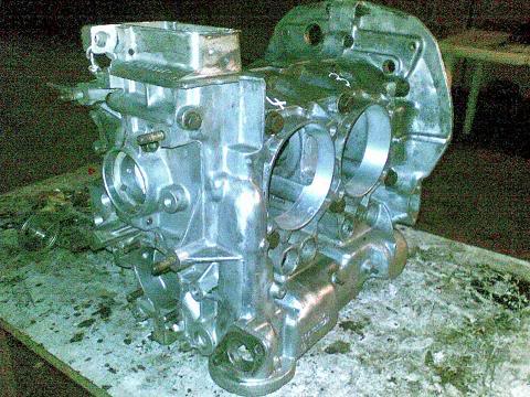

Now I've torqued up the empty case (bad photo, sorry - taken late tonight) to have the main bearing saddles checked for roundness and to make sure the crank is parallel with the case center line. This will be done during this week. Looks like I'm going to have the motor up-and-running before the buggy is even ready to accept the performance motor.

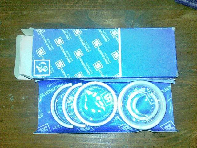

Got some hen's teeth - German made main bearings. 0.020" oversize in the case and std on the crank.
Just goes to show - industry needs people with memory like an elephant - the shop was starting with the whole "OH no! we'll have to order these, VERY difficult to find" when the one guy remembered about these on the shelf. Was ordered for a customer years ago, but he wanted 0.020" on the crank and std in the case.
