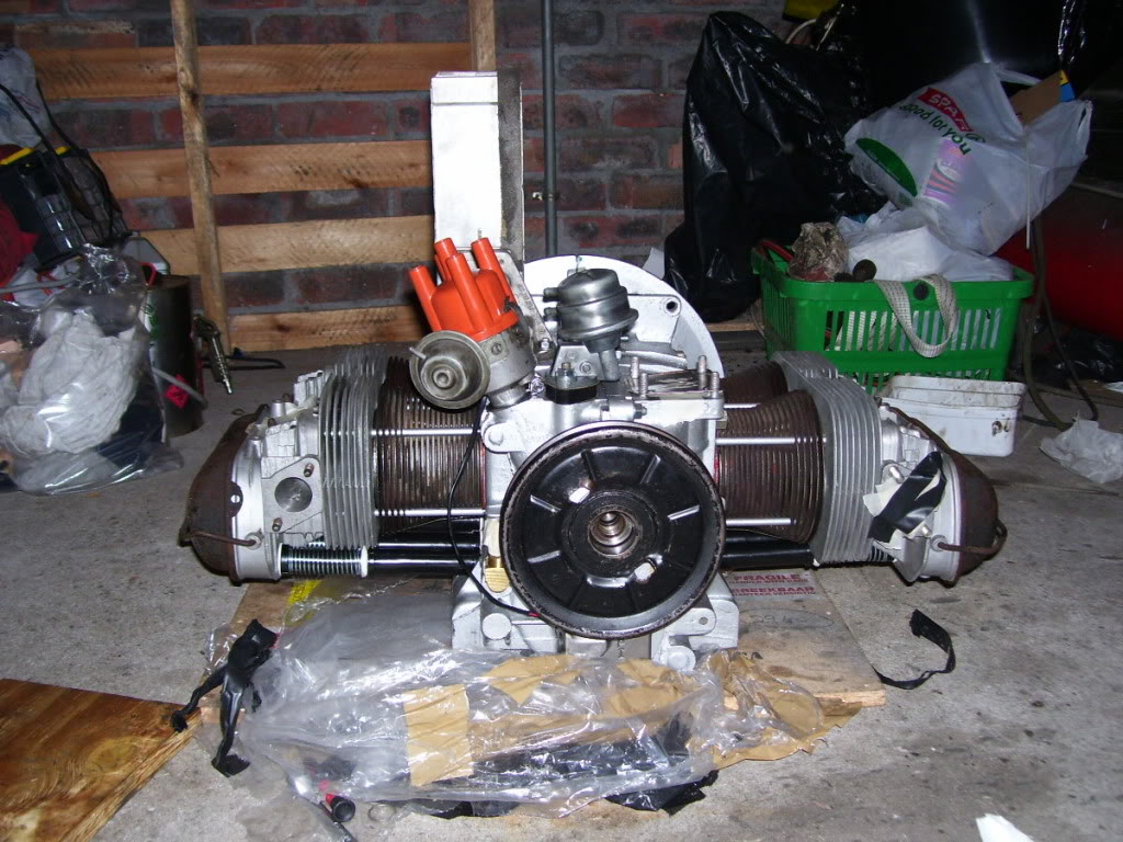

Engine has finally been built up to a longblock
should of taken a pic before i sealed and wrapped it up but too late now.
Engine tin is going for powder coating on monday, once it comes back I can start bolting on all the ancillaries like the carbs,alti etc.
Gonna take the engine to Dave Rowley to break it in on his test stand when its fully built up and will also run a set of SS trumpet exhausts temporarily till I can afford a nice 4 in 1 SS buggy exhaust.
Hoping to have the engine ready by the time I go on leave in december.

Re: 1600 mild street engine buildup
All the tinware got sent for powder coating yesterday should collect it at month end, its going to get powder coated semi matt black for the factory look

I love it, so neat and clean. Anyone want to give an educated guess at what this engine would cost if it were for sale vs building it this way?
Its going to look even better once the powder coated tin is on with a few chrome bits sprinkled on it
So far I have invested R13500 in this engine but it was built from scratch and I did a few extra things to it a stock rebuild wouldn't get(balancing,strengthen valvetrain,W100 cam,8 dowel and lighten flywheel etc)
Also curious how much an engine would sell like this as the basic long block itself cost about R9500 just in parts

Edmond that pic size is perfect. Most of ours are that size. Something like 680 x 840.
Nice, BTW Shoprite missing a shopping basket????
