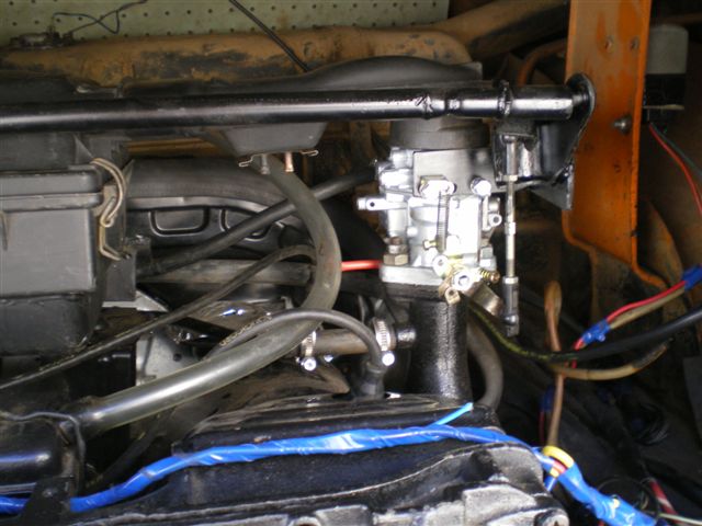

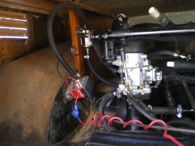

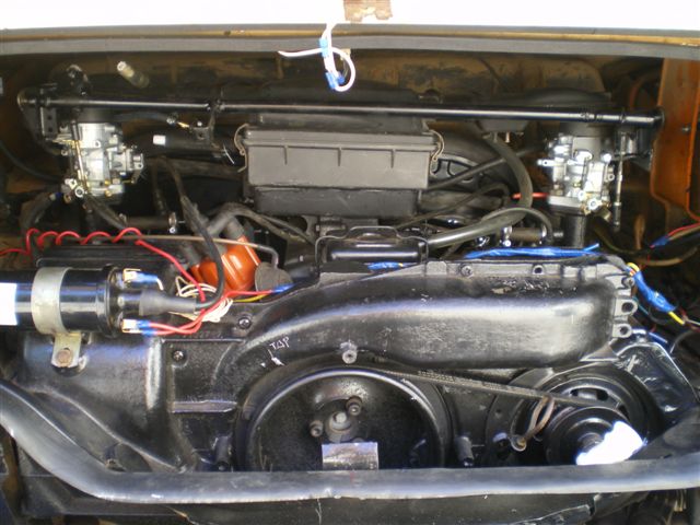

Well here we go.
The Webers have arrived, and the decision to only get the two Carb's was taken to enable the old type 4 filter cartridge air filter to be retained.
With the Fastback I got the full set with linkages and fittings, but as the linkages are to close to the carbs, the old Air Filter would not work.
Also I saved 1800 ZAR's by not bringing in the kit. :D
But this means that a full rework of all the linkage parts had to be taken on, and blind Mounting points had to be found on the Webers and tapped, for threads.
All the fuel pipes, vacuum pipes, and filter vent pipes had to be rerun or rerouted.
But this was all done, and the timing was set, the idling speed set, the Idling mix set, and the linkages were set.
So all tools packed away and armed with a 10 mm spanner, I hit the road.
Down hill and up hill, start stop, sett a bit on the timing, and all over again.
This went on for 120 Km, but now I can say that the Fugly is running right, and strong.
Here are the Twin 34 ICT Webers fitted....

Re: RetroVans's "Fugly Braziliamba" Project
Looks great Herman.
Why did you go for the ICTs instead of IDFs?
Thanks.
I wanted something that looked semi original, but had fuel economy, as well as road side simplicity.
And they perform great on the type 4 engine.

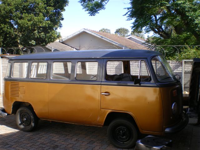

Fugly all done, and legal, fitted the new road wheels, ready for the Road Trip.
