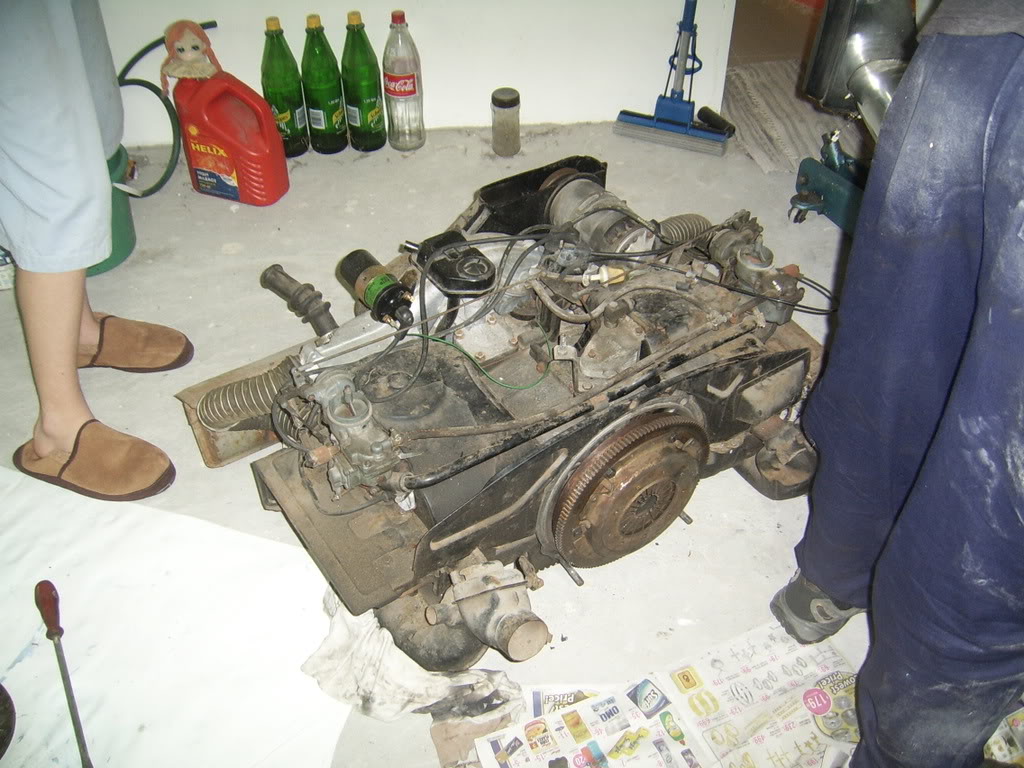

We(me and BAB) took the 1600 engine out the Fasty I bought and we put it in the Notch.
The Notch engine took 18 min to take out and the Fasty engine took 11 min.

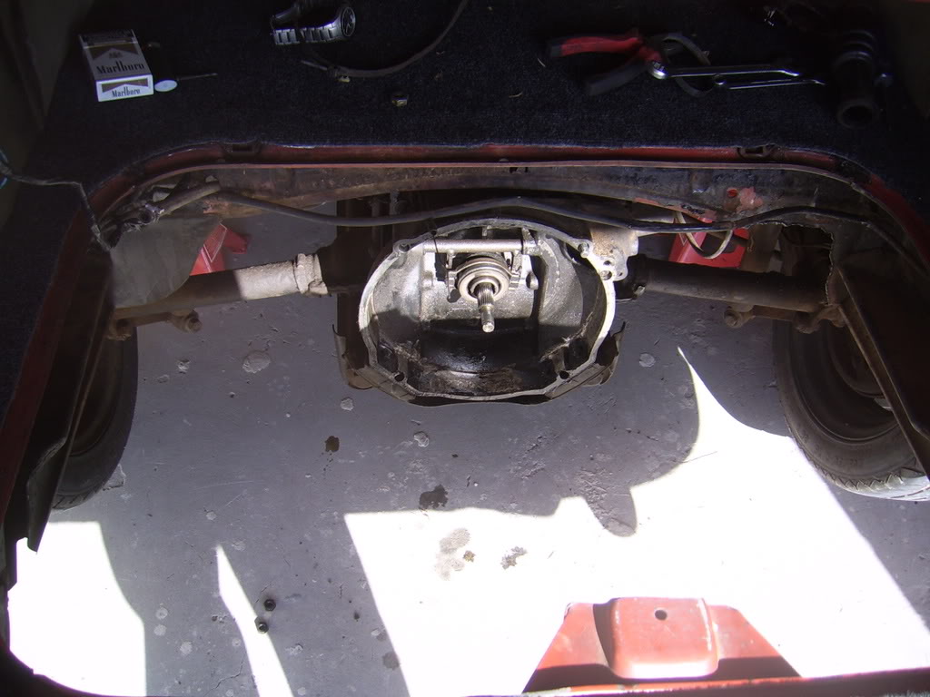

Re: My 63 Notch
You have a later model tranny in the Notch.
- Posts: 11732
Re: My 63 Notch
How can yo tell?
The starter is 6V and the 12V flywheels doesn't fit.
