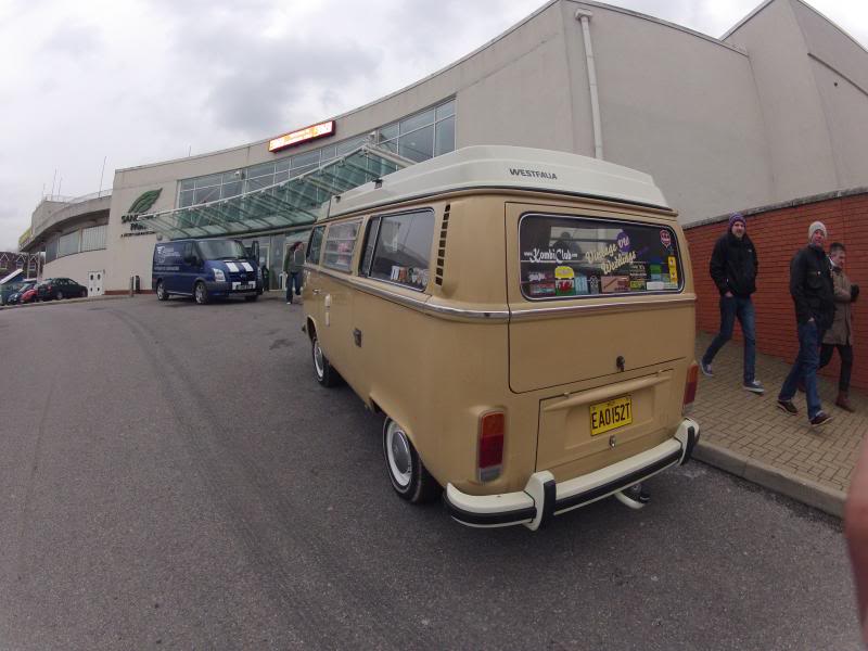

I got to the show at 10.45 am and so had to leave the van outside. I parked it directly outside the entrance though so it was the nearest I could get without being inside.
I met a few TLBers. Thanks to Jen & Rich for their efforts & to Fancy Bug for phoning me. It was all good in the end &I've learned a valuable lesson. :)

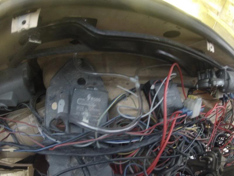

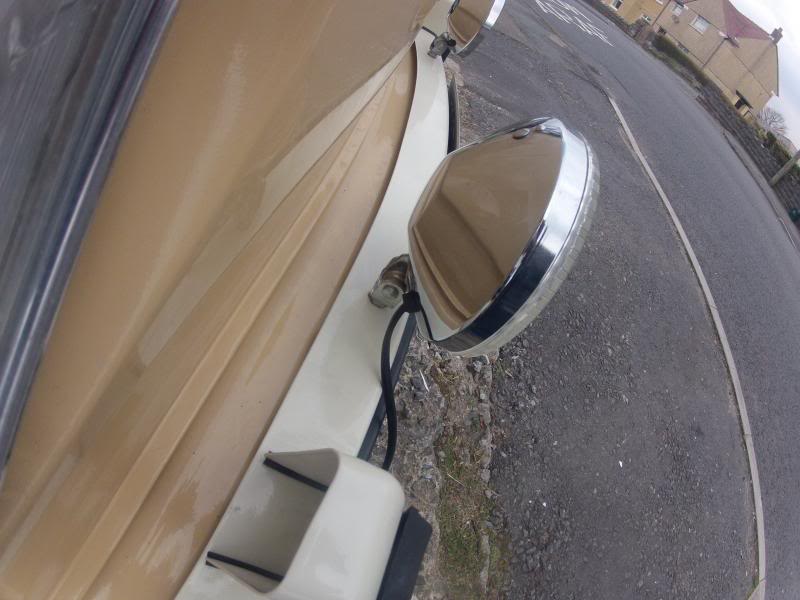

Started to wire up my spotlights:-

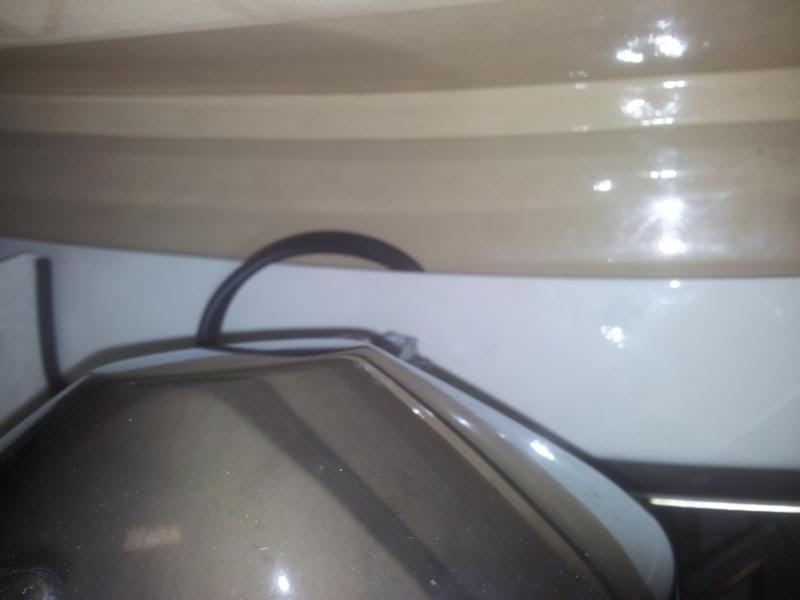

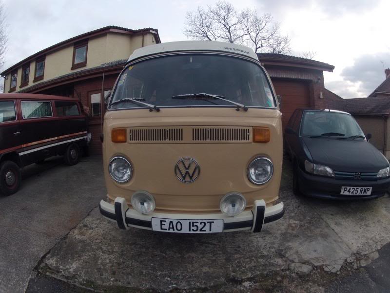

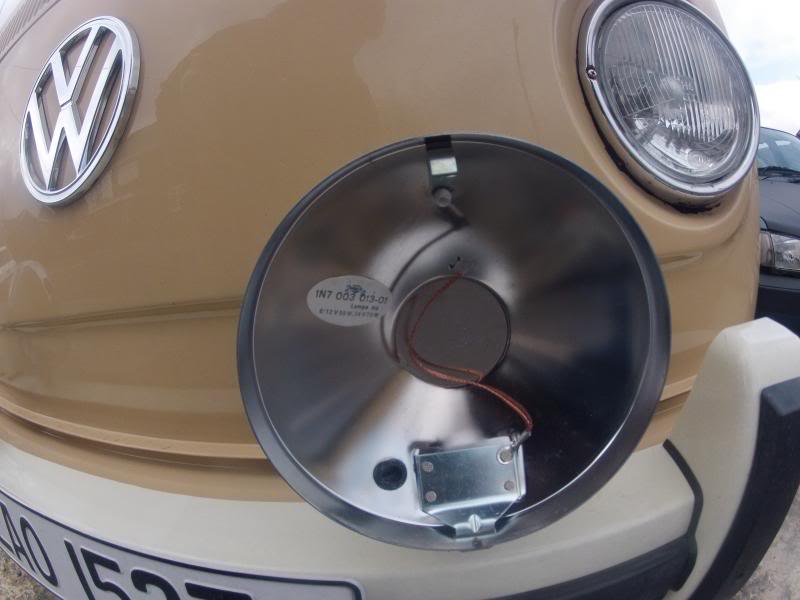

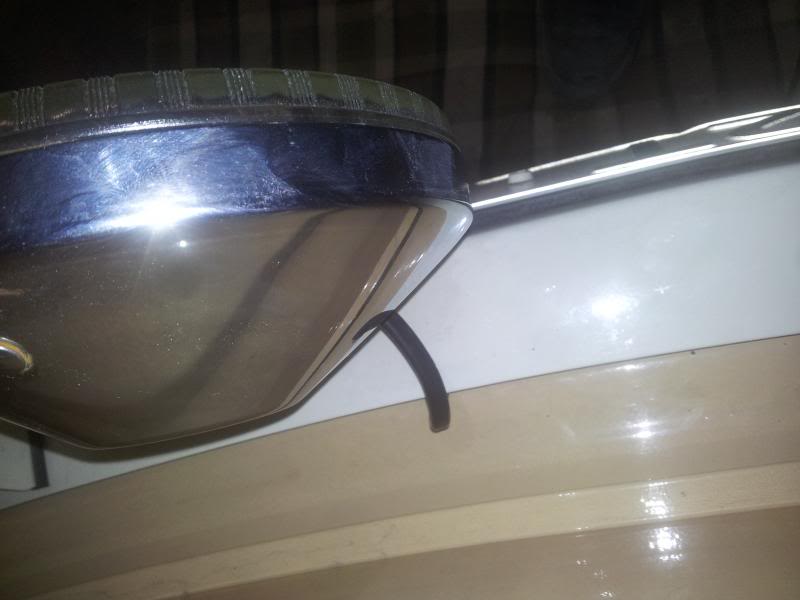

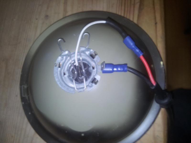

Did some more work on my spotlights:-
As you can see the cables tuck behind the bumper nicely & are mechanically protected in a second sheath.

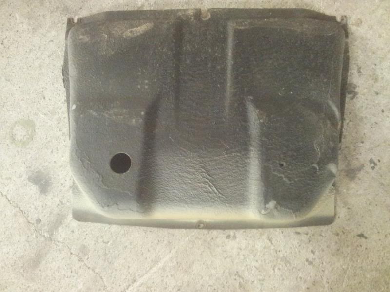

I'm going to have my front belly pan shot blasted & powder coated:-

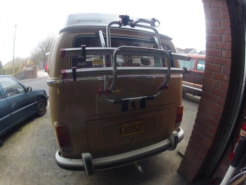

Put my bike rack back on:-

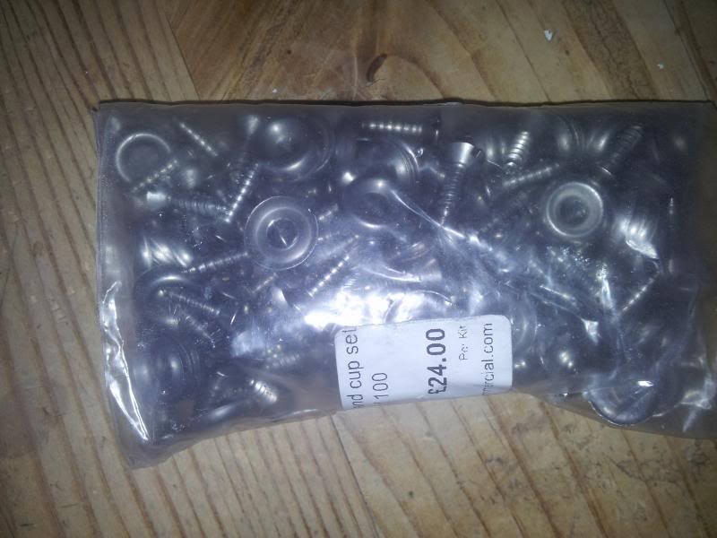

Bought some new screws & cup washers for the interior roof lining panels:-

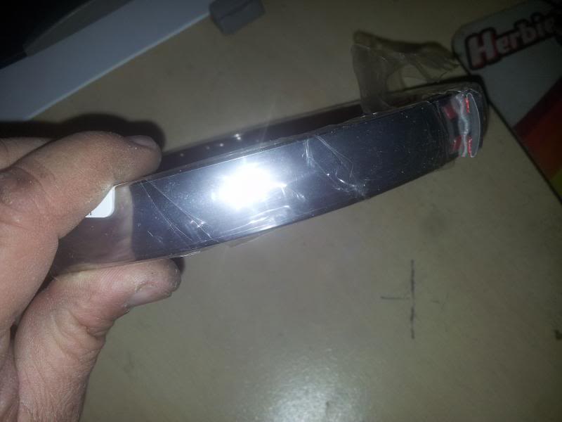

Also bought some Westy window trims:-

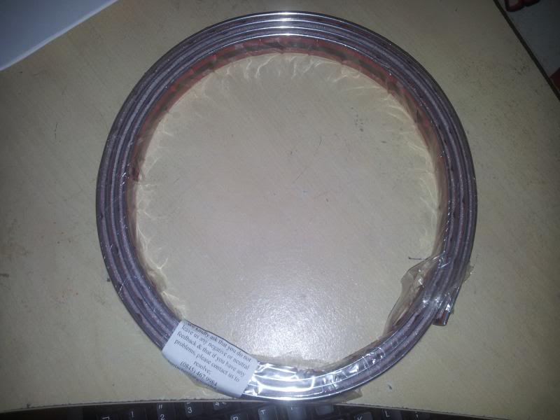

& some chrome strip for my trailer:-

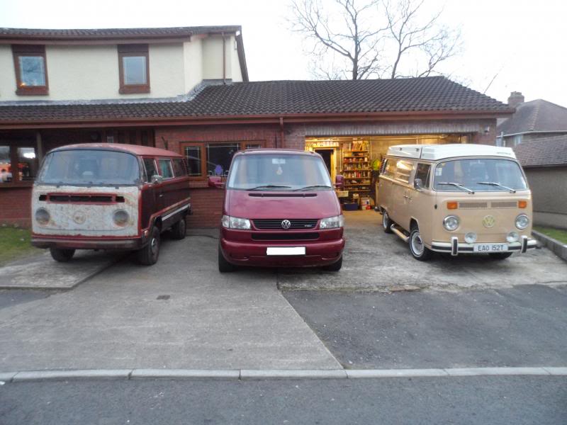

Got the wife a new daily transport:-

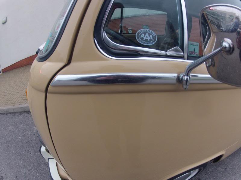

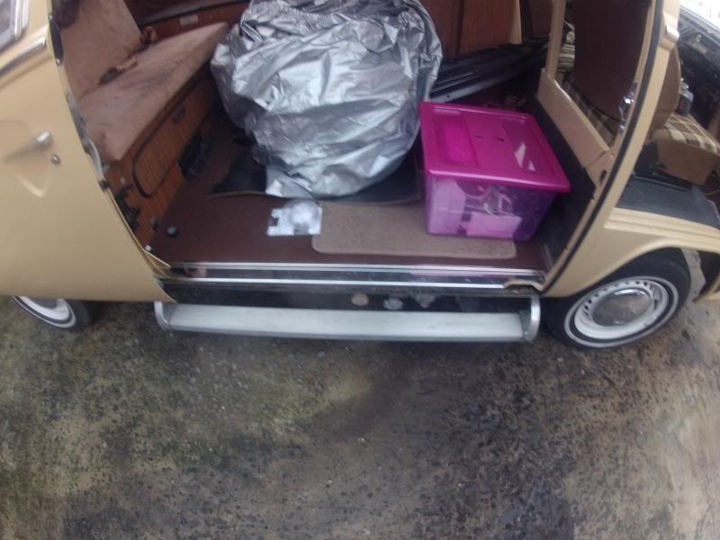

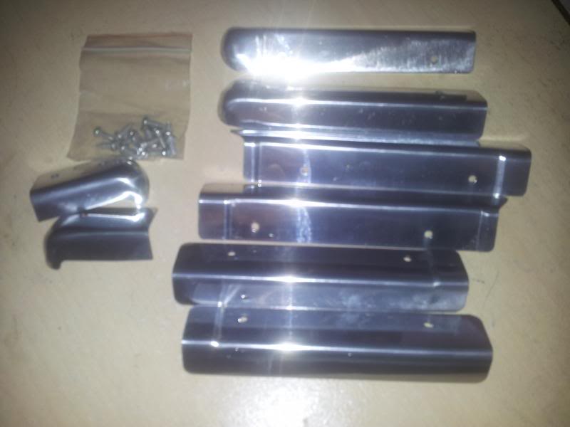

Fitted my stainless steel side step trim:-

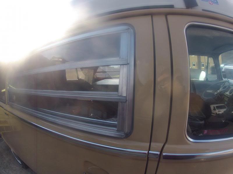

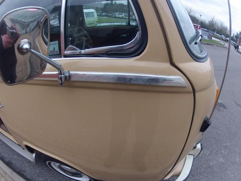

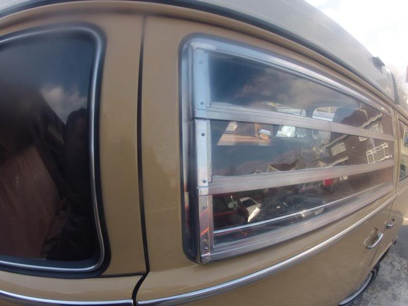

Fitted my Aluminium Westfalia window trim pieces:-

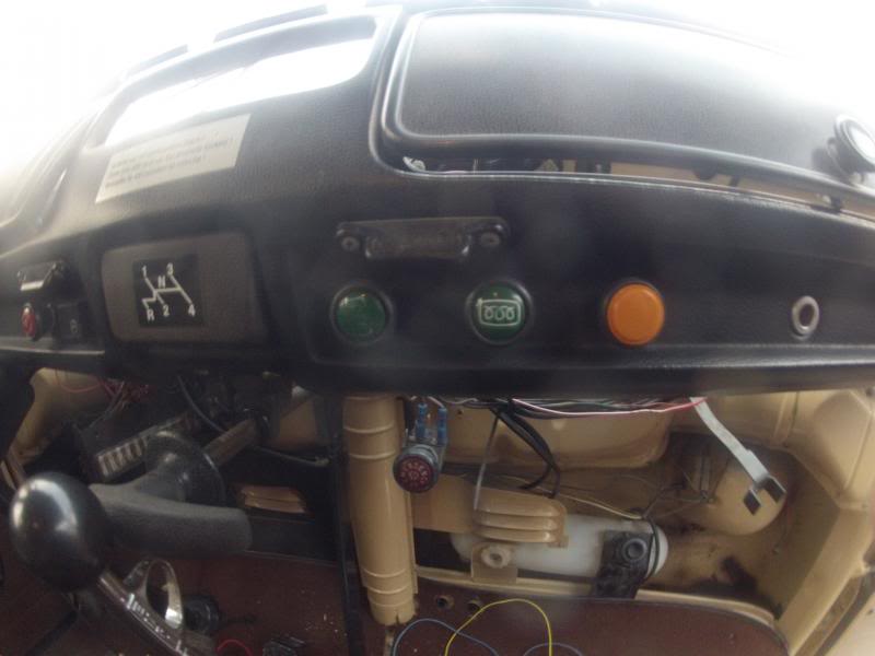

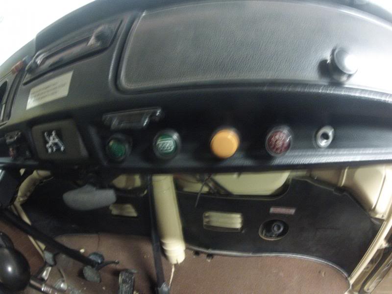

Dash switches, Left is the spotlights, middle is the heated rear window right is the front heated screen:-

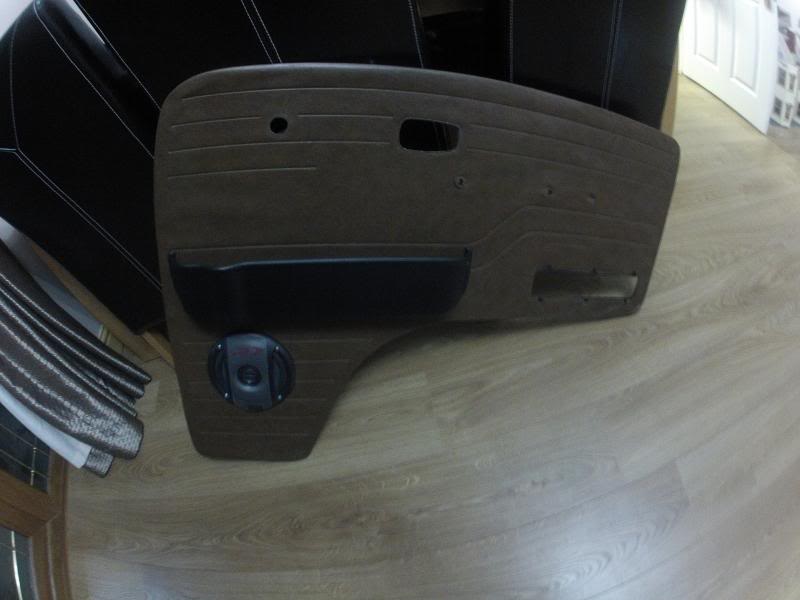

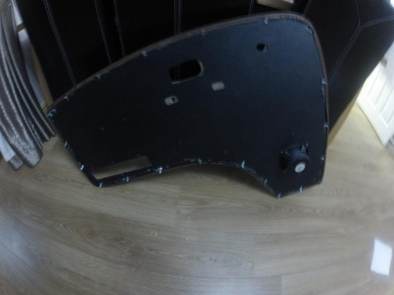

Finally got my passenger door panel ready to fit, & I've fed the cable into the door:-

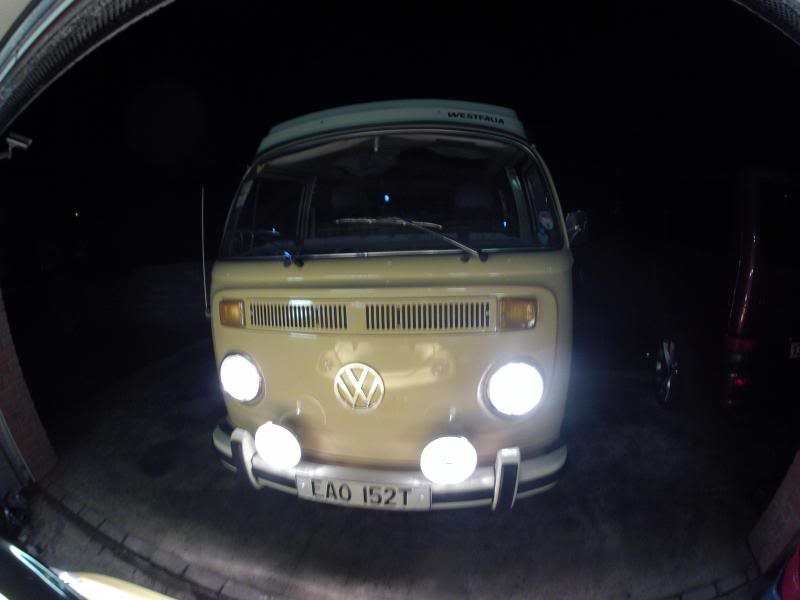

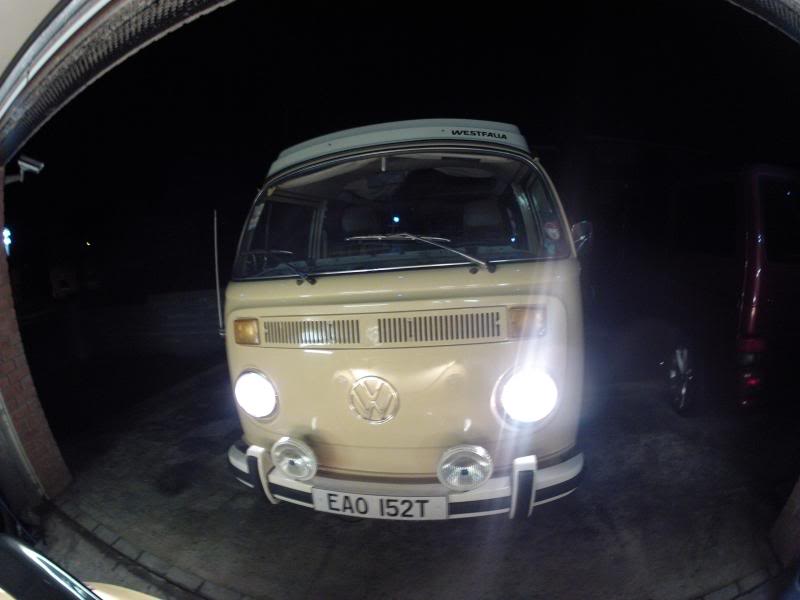

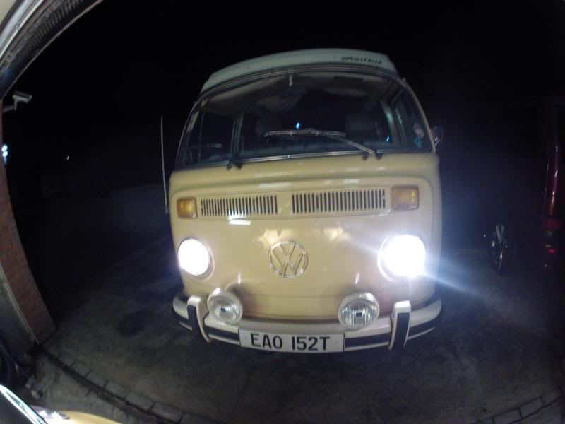

My spotlights are now working as follows, I can pull the switch out & the spotlights will only work when the lights are on full beam, they will not work when the lights are on dipped or on side lights. If I leave the switch on then the spot lights will flash when I flash the headlights:-

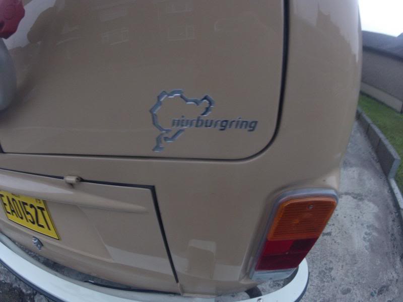

Nurburgring sticker is on:-

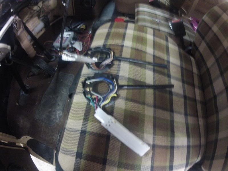

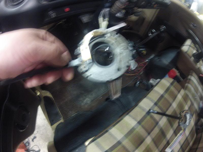

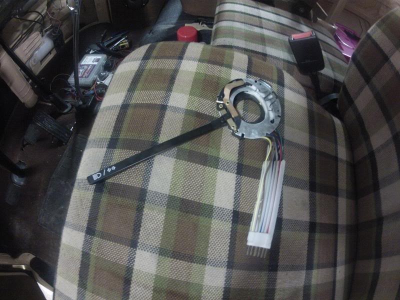

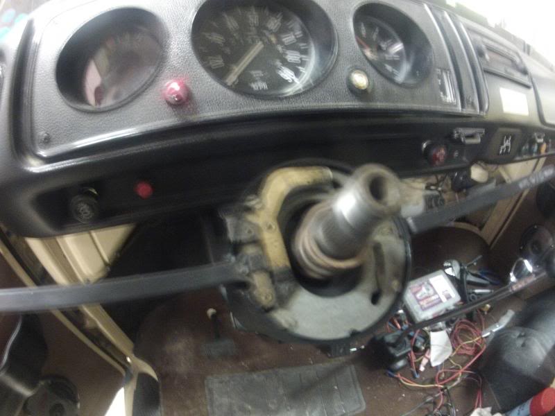

I've noticed lately that my indicators don't cancel anymore, on removing the stalks this part fell out, so that's probably why it no longer works:-

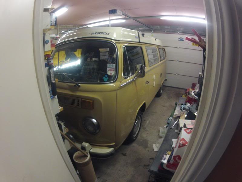

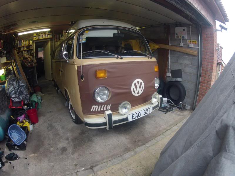

Milly locked away safe in the garage:-

I decided to fit a new indicator switch to fix the fact that the indicators don't cancel after I've turned a corner:-

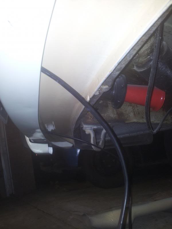

Volkshaven cut out a hole for my aerial & didn't charge me, thanks guys:-

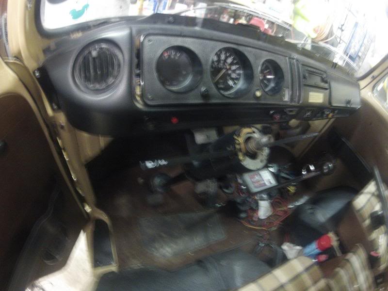

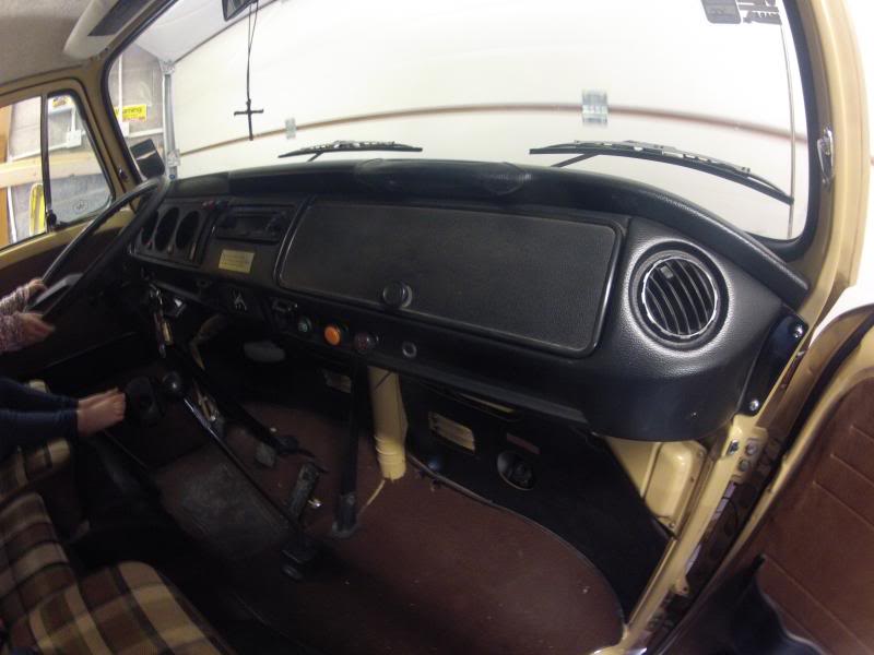

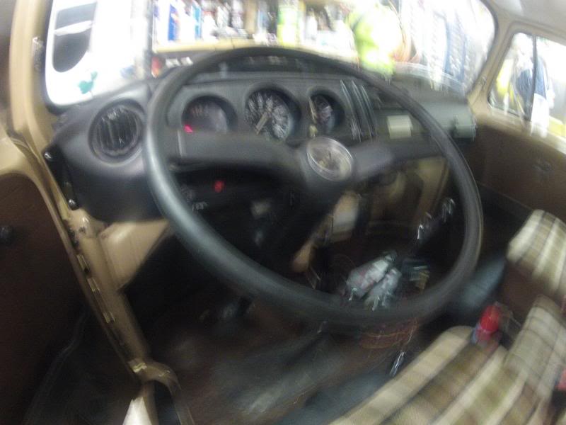

All my dash & cab are all back together:-
Luckily I had a couple of helpers:-
