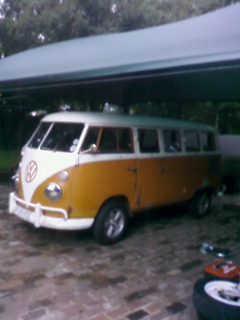

The kit consists of a stud with a 14mm end for the drum, and on the other end, 12mm for the wheel nut. Then there is a washer made to fit the Empi 5/American eagle rim and the Chrome nuts.
The kit in the top centre of this picture by the looks of it.
Not rocket science, just like changing a tyre, undo the old wheels, tighten the stud into the drum (it has an allen key centre)
Fit the wheel, and the nuts centre it nicely on the studs.
Unfortunately the kit is made for 4 stud applications, so I am one stud short on each wheel, and also need the Empi centre caps for the wheels, but will get all the above pretty soon.
When I get the last kit to fit to each wheel, I will use some threadlocker or whatever it's called, on the thread that goes into the drum, just to make sure it all stays in tact.... Didn't feel like it's really required, but probably a good idea, what do you guys think ?

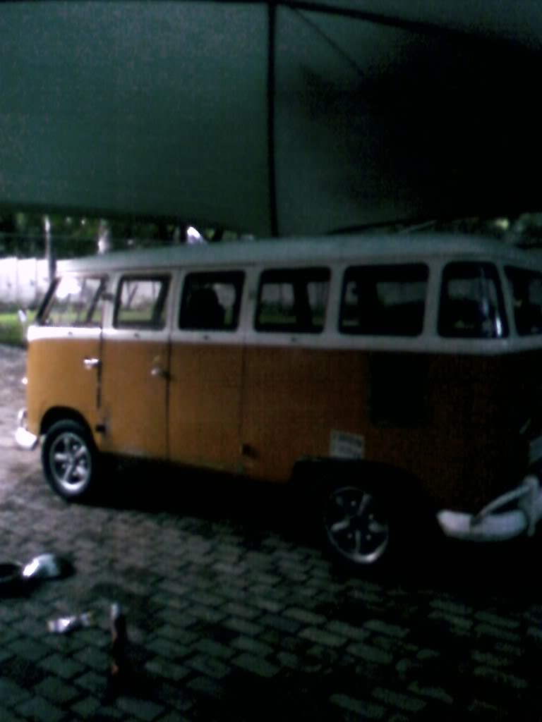

By the time I was done, it was already just about dark, so the cellphone was set to brightest, and pics are even worse than usual, but I had to take just one or two

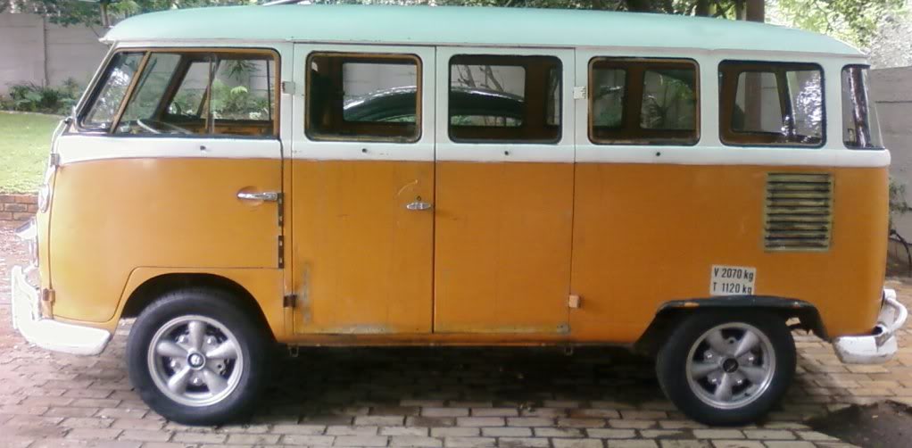

So here is a slightly better pic :
Notice the increased ride height. Looks like she can go just about anywhere
Problem is, now you can see all the rust and the rest of the repairs required

those wheels look hot.
it looks like a moerse hot wheels bus

Riaan, you got a stud missing on the left front

KK, those wheels look fab! I used Threadlock on Mo to also be on the safe side....I used it on all the studs, including the adaptor plates into the drum and the wheels to the plates

and rearhitlers revenge wrote:Riaan, you got a stud missing on the left front
- Donovan D
- Posts: 2231
- Location: Brackenfell
- Has thanked: 149 times
- Been thanked: 73 times
Re: Fleetfooted - 75 Fleetline - We have ignition :-)
farhaad.sonday wrote:and rearhitlers revenge wrote:Riaan, you got a stud missing on the left front![]()
...and probably the other side aswell
