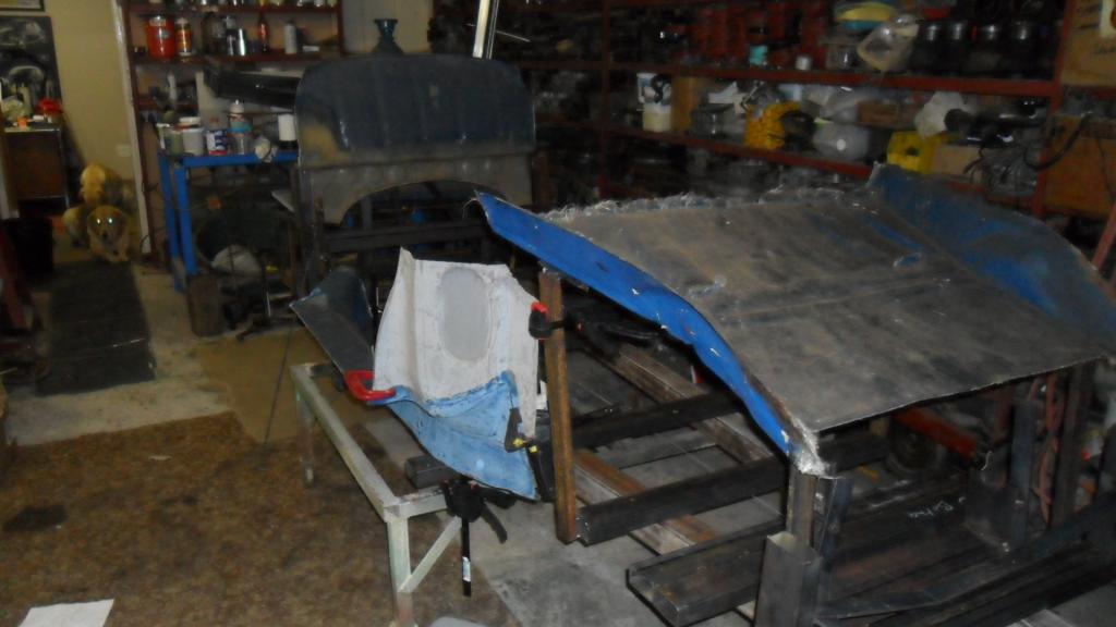

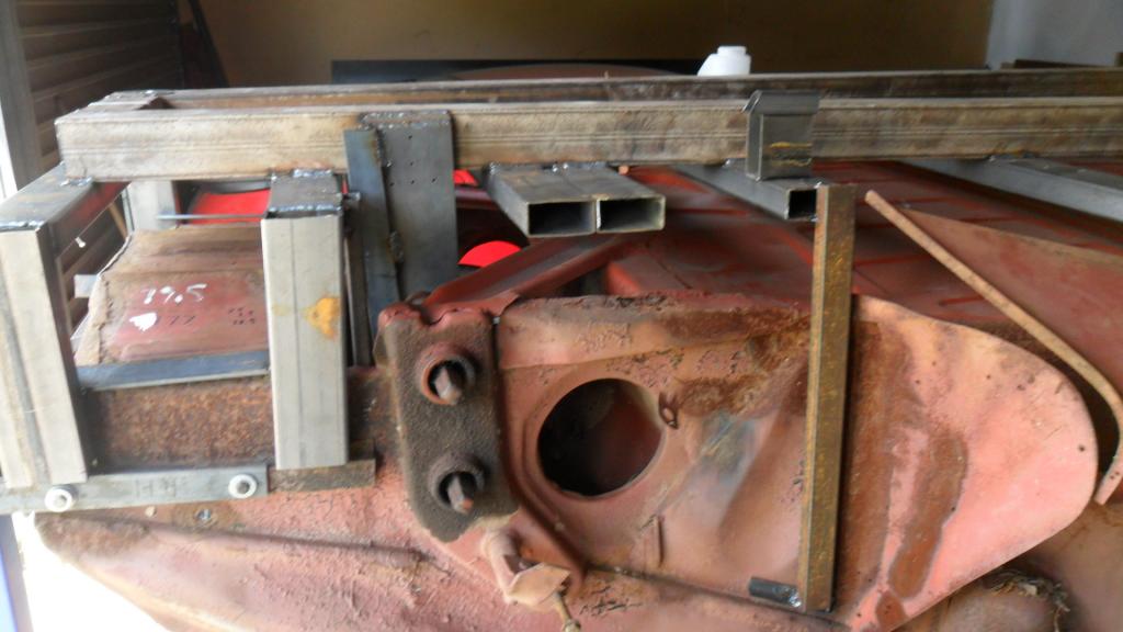

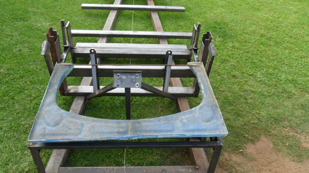

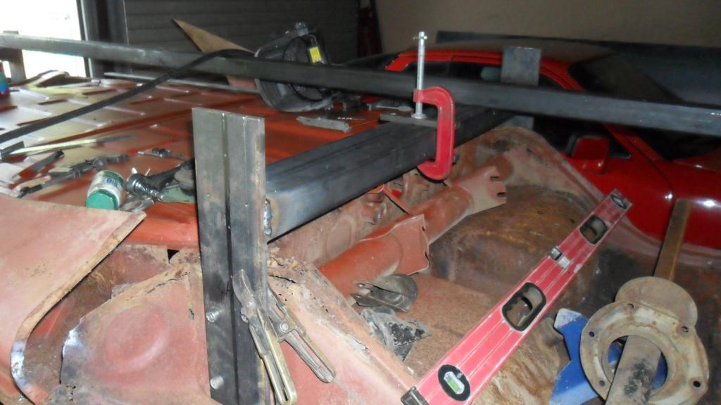

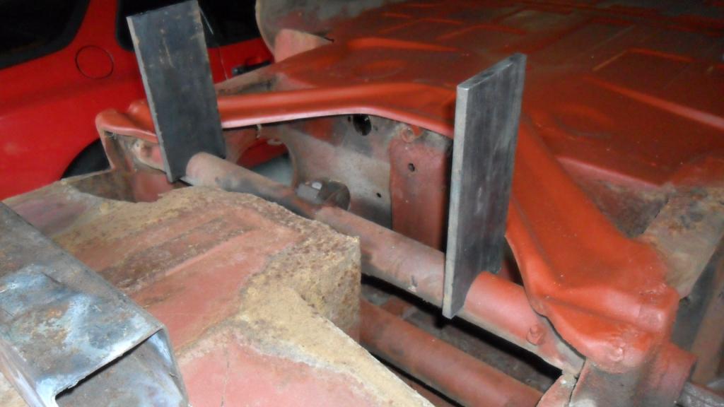

After trying to figure out how much to shorten the beetle pan and looking at rusty pans I took the plunge and decided that a custom chassis will be my way forward. I turned the wreck upside down and started fabricating brackets to pick up on all the points I think important (time will tell if I was correct) Bought R3500 worth of steel and started. :D

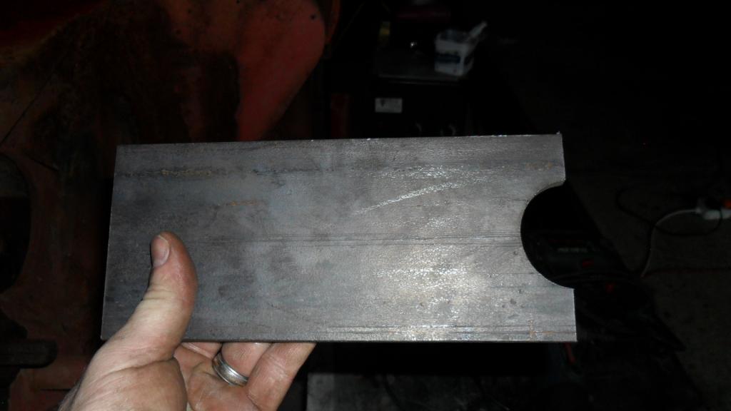

Made 10 x 100mm plates for the front beam
Same for the rear
Placed it all on the upside down car and welded the lot together after a Gazillion measurements

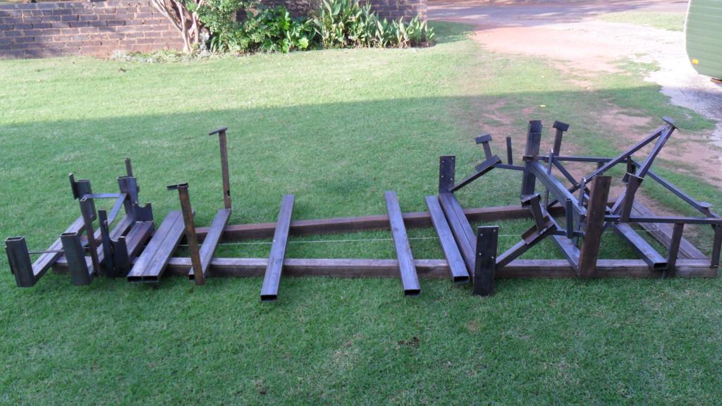

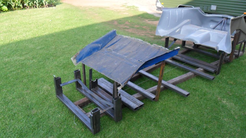

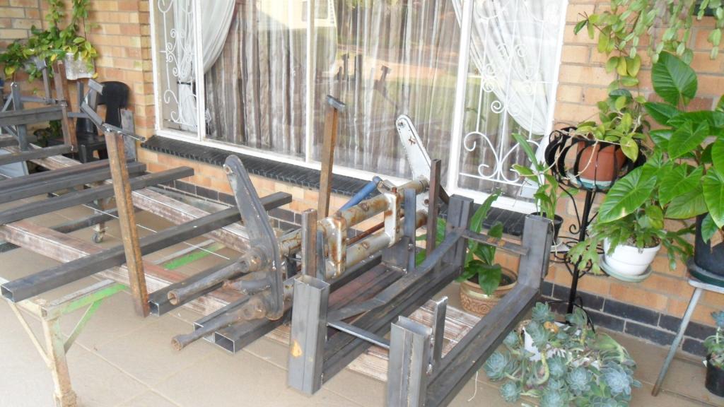

After separating it from the car I was left with this :D

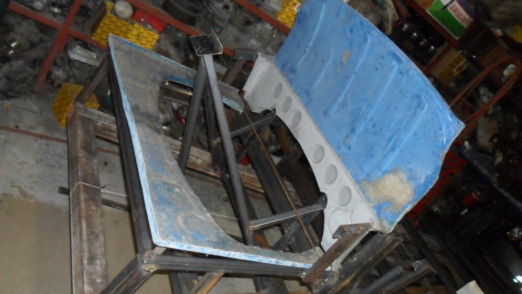

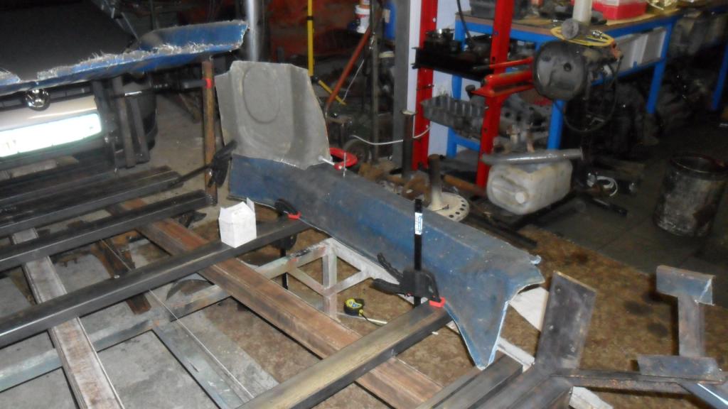

I then placed all my previously moulded bits onto it and am very happy It Probably will work
Engine tray in correct position
Rear engine compartment and inner wheel wells will fit after trimming
Front under bonnet area
Rear fire wall fits as well
Front suspension fits at correct camber
Front inner speaker panel and sill
There are a lot of minor bits still to be added before I fabricate but it is heart-warming to see everything fit so well
