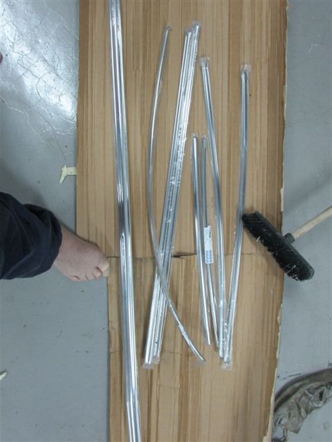

Here is the Trim;-

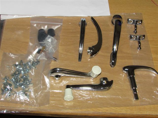

and here some of the much needed bright work, that was missing when I got my shell.;-

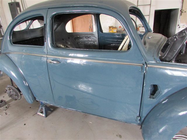

So, still waiting for harness, but have done some work on the 52.
