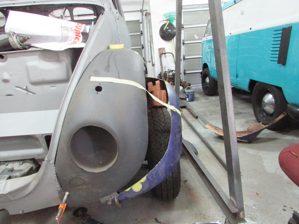

You quit right there Dawie.
This has run through my mind a lot, with all the compilations possible.
The starting criterion was that it should not loose the Beetle curves,
should have droopy eyes but only two. (still want that face illusion)
should have the front and back resembled as close as possible to the original beetle shape
With the body widened, it would have lost its weirdness and become un-cute.
So if I follow the tape line as per the above picture, I should cover most of these requirements....
BUT...
This we will only see when the fender is shaped and in a single colour.
What you think ?
With regard to the Fleetline, and Fastback, I was pissed off and did not think things through.
NO they are here to stay, not sure where we will pack them, as the Bay is on its way back home with a new wardrobe.

It will be difficult to name an "look-a-like" but the basic droopy face look I want is something like the DKW Schnellaster, also known as the DKW F89 LDawie wrote: Tue Apr 16, 2019 11:39 am .............
With stretched outer of fenders, closely spaced headlights, maybe it would look something like Messerschmitt KR200 from the front.
With a bit of Chevy & Ford trucks as well...

So a new system had to be brainstormed and parts got to modify to make it work as standard.
Bought a Golf 2 steering knuckles, coupling and cut it to bits. Use one half for the top twist coupling, and build a new VW gearbox coupling but with a spin pin so as to be able to take up the twist needed to go from 1-2 to 3-4 to R.
The length of the shaft was a hit and miss issue as I would either have 1&3 or 2&4&R but not at the same time.
The floor is in, the tunnel assembly is in the gear lever shaft is in, (still needs setting) and now we can get the steering in ....... .
So now its time to sit on the couch and wait for the next stint in the workshop.
Feet up ...
