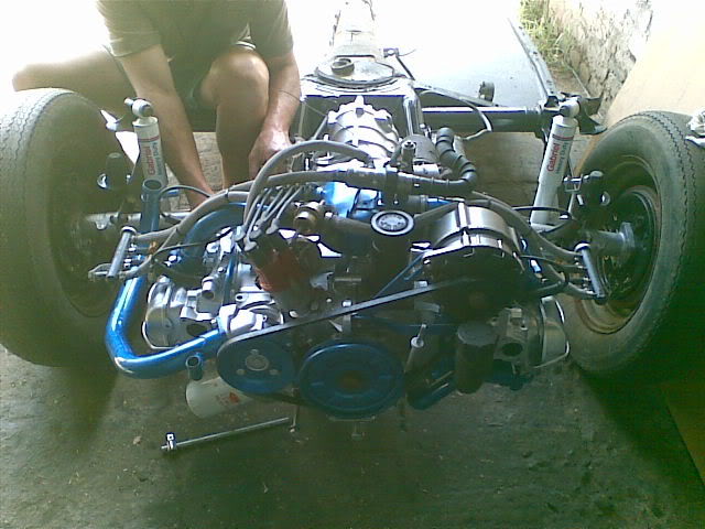

The motor was fitted without any hassels. The 411 FW works hundreds. Connected all the wiring, thanks to Bugger and myself for marking everything. Started it up. Now for the exhaust and cooling and then back under the body. What is looks like now. all wiring still needs to be made tidy.

That looks like a super job.
