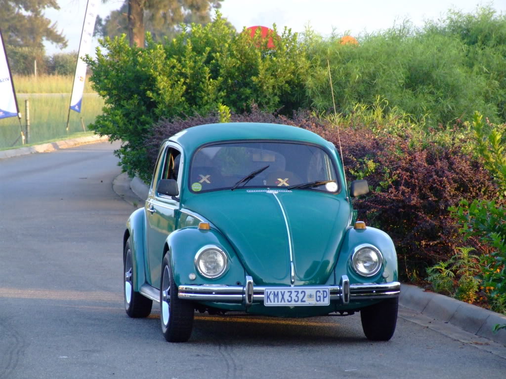

Maybe I am stupid, but I don't get what the big deal is with the wheels sticking out beyond the fender.
This is a picture of my old 69 with disc brakes and a wide five adapter on rostyles. The tyre size was 165x 15.
I had no clearance problems whatsoever. The lip on the left fener had to be tweaked to clear on full suspension compression, but that was due to a bad repair of a dent on the fender.

Jmvv do you have more pics or that setup please?

1972 wrote:Jmvv do you have more pics or that setup please?
http://www.aircooledvwsa.co.za/viewtopi ... 1&start=15 :hangloose: :hangloose:
