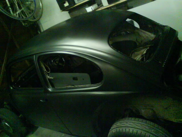

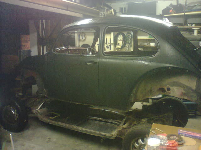

yip going all out on removing the paint, so that theres no regrets later

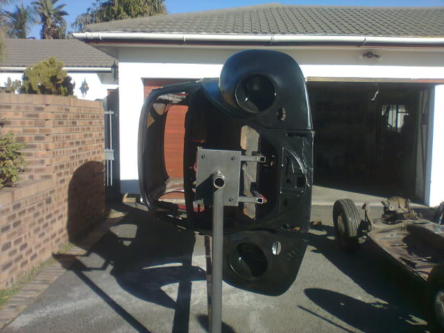

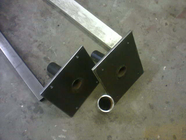

Almost done with my rotisserie

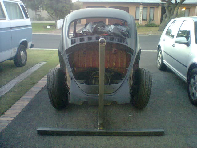

I noticed that you have one odd wheel on the rear, what's up with that??

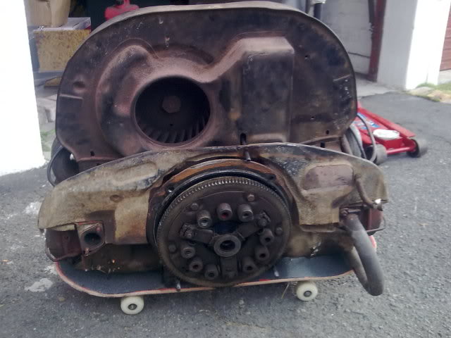

I got it with the car when I bought It, cant seem to find a complete set, PCD 4x130.
Re: A little further...update.
Let me know if you'd like to sell it, have 3, need 1 to complete a set

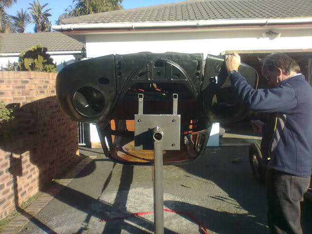

Rotisserie is now complete
, now the fun starts in repairing the almost non-existing heater channels

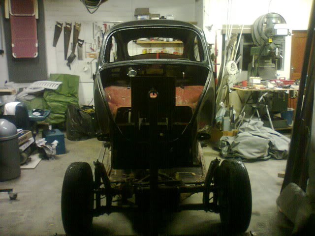

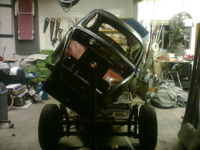

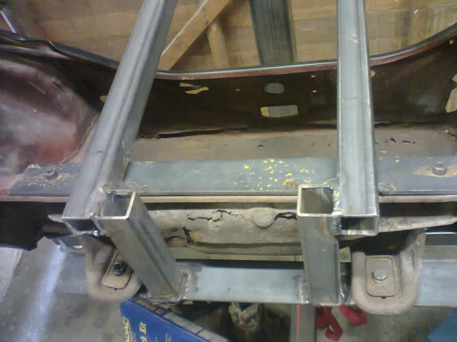

what part of the bug did you bolt the rotisserie onto?

I will post pics later of the front bracket design, the front is bolted to the mounting piont on the body where the chassis bolts to and where the fuel tank bolts are..pics will explaine better.
Back of car was bolted to where bumpers go, as in pics above. I wanted to bolt the back of the car to the mounting bracket of body to chassis, but that needs to be re-made.
I am prob going to make another set of brackets to change holding position, if I struggle to access areas on the body around the frame.

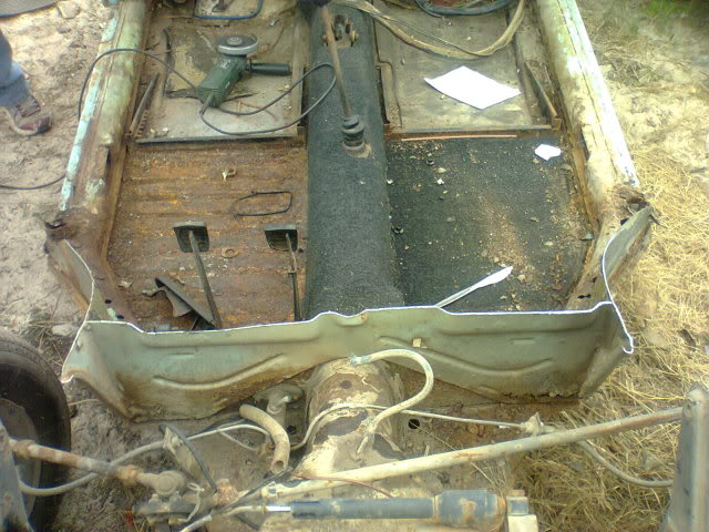

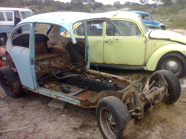

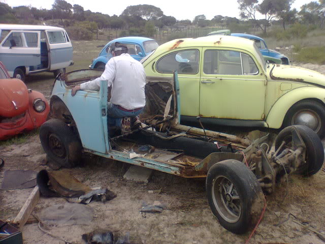

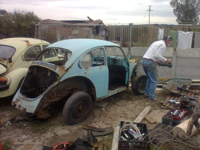

Found a beetle that I could cut up for the heater channels, driver side was good but other side needs TLC..good starting piont though!
My dad had a good time doing all the cutting, I didnt dare to ask...haha

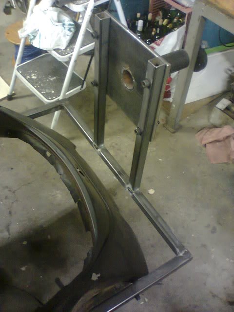

This is how the rotisserie i built clamps to the front.

very nice. Your car is going to be very special after all this. Pity about cutting up the other beetle, but the rust seems to have limited its chances of restoration anyway. . . How are you going to seal/prep the pan? And inside the heater channels?

It is a pitty for the bug I cut up, but the overall body was worse than what I have, so I chose to cut the sections I could use out. The sad news is that most rusted areas are common on all the beetles. I Plan on sandblasting the heater channels then galvernising the lot, but I dont exactly no yet., so any advice or ideas you got please do share.
