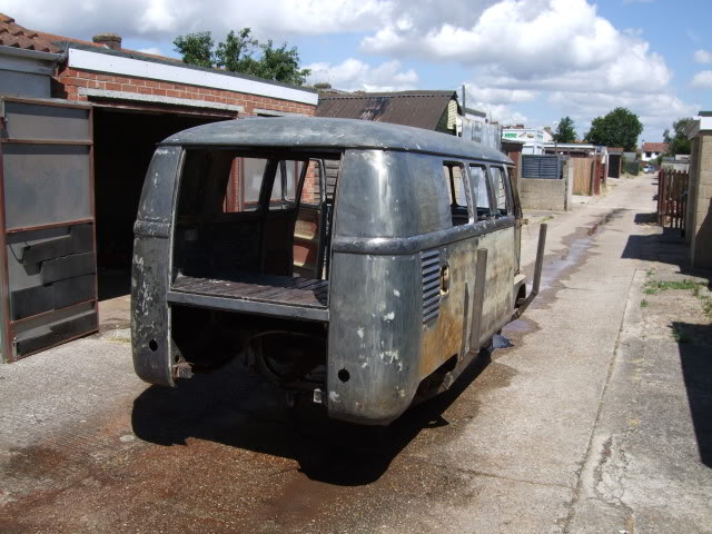

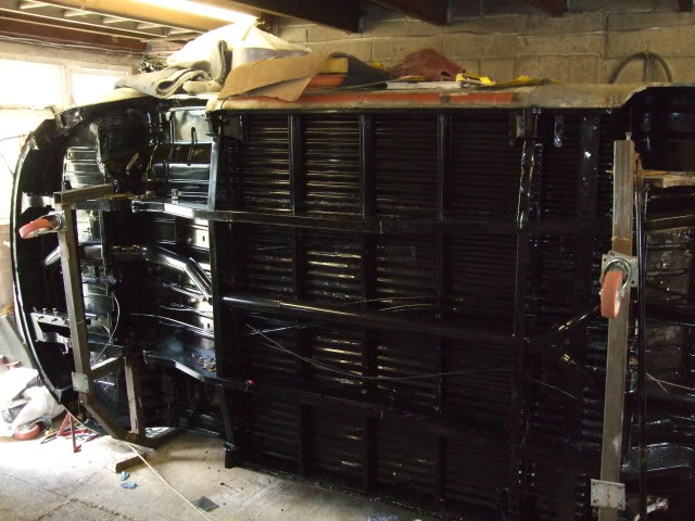

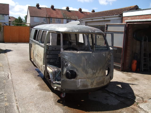

Wow, I can't believe it's over a year since I updated this
Well it's still on going, I'm sure it's the same for you guys...it's all down to money and time and more money.

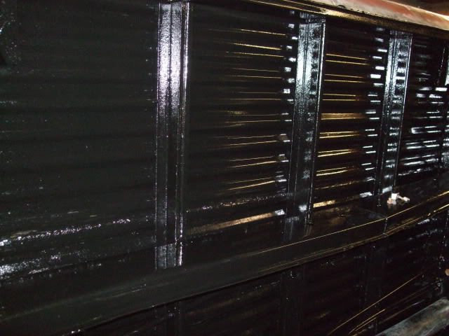

After all the welding and Bare metalling I had bus out into the alley and jet washed it all down, rolled it over on the rotisserie and did the underside as well. I was amazed at the amount of crap that I managed to wash off the underneath, All the south african soil is now outside my neighbours garage
The underside is now all painted in Por 15 Products firstly marine clean...then wash it down, then the metal ready....then wash it down......then the POR 15
The annoying thing is, I've used it before and I've read posts on here about what a pain it is to get off your skin, so did I wear gloves......off course not!
Also....had a bit of a play with some lead loading....
Andy
Andy

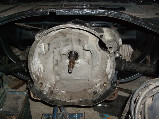

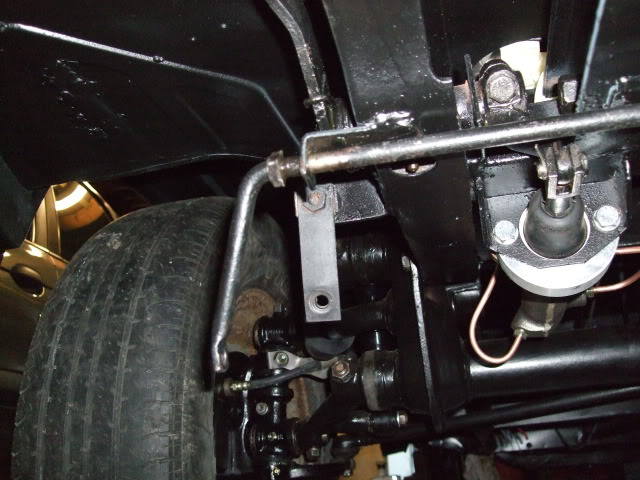

Trying to keep track of what I took off
Got the new Dual Circuit master cylinder
The front end all just needs tightening up now and I have to get the front wheel alignment sorted.
Got the gearbox back in, so just need to get the new rear brake lines on

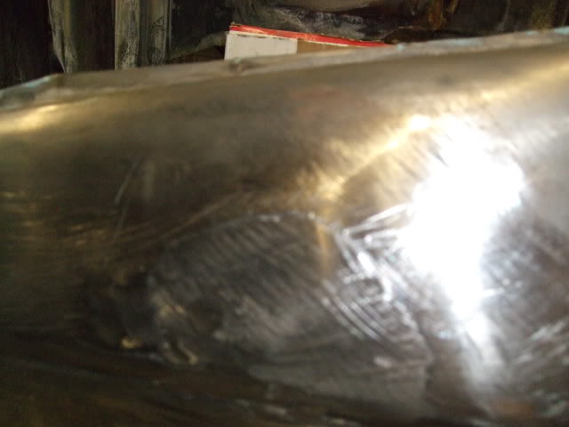

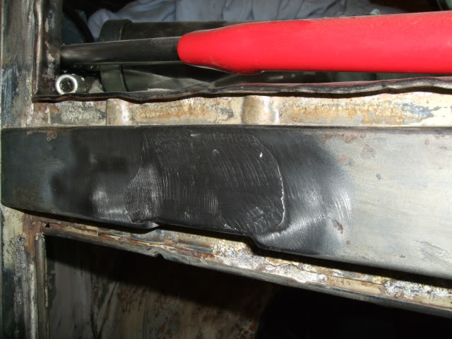

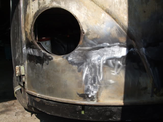

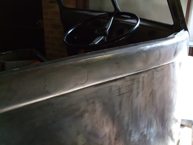

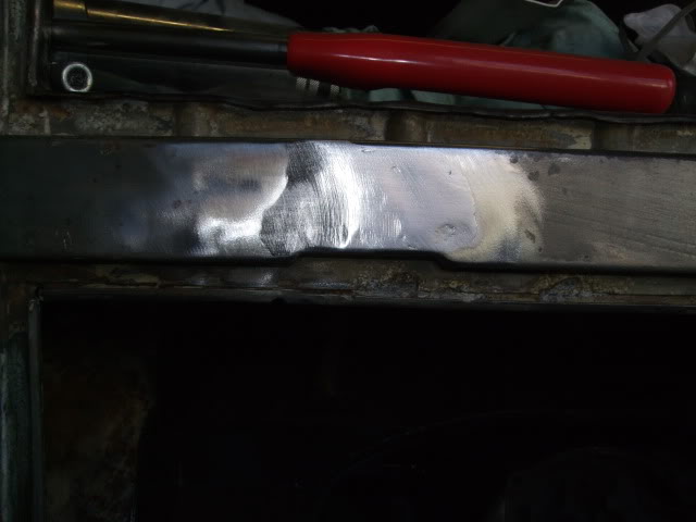

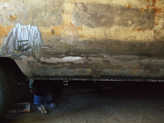

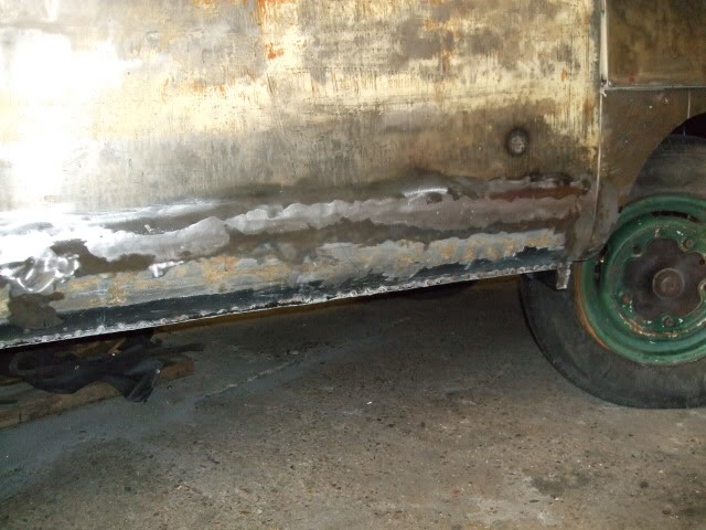

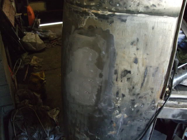

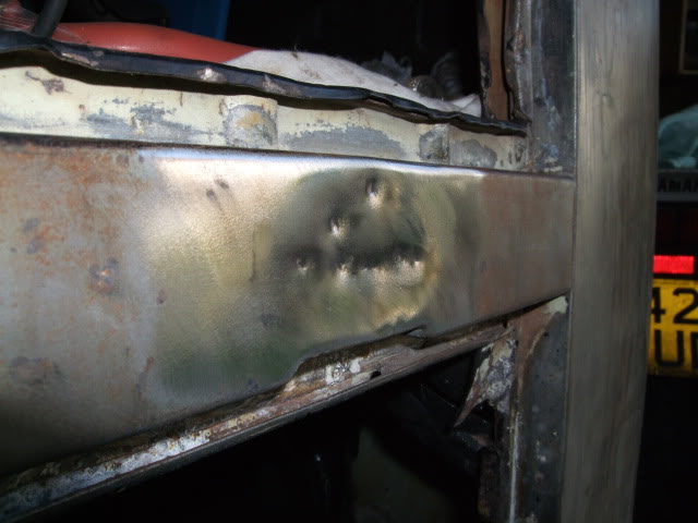

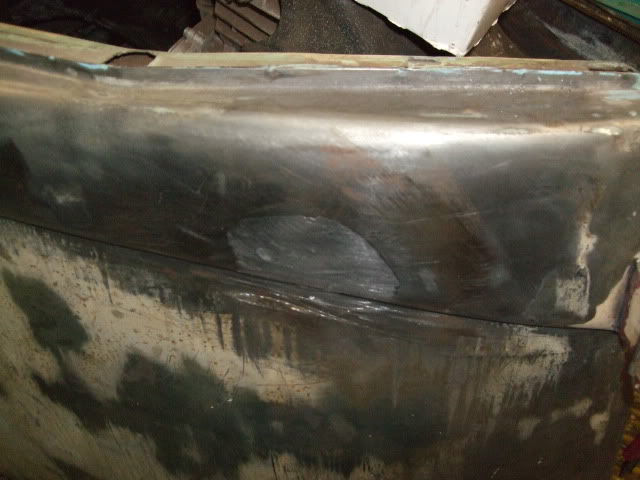

I decided I fancy having ago at Lead loading.....and I really enjoyed it....it's not perfect, not by a long shot but at least I will get away with either just a bit of stopper or a thin skim of filler.
Engine lid hinge area bit before
And after
And the other side
Short Sill
Cab Door
Long Sill
Front Panel
And the rear corner I was dreading....I couldn't get any more of the dent out as it has the inner skin in the cargo area , I had tried welding things on and trying to pull it out but, it just wasn't happening.
But it turned out ok, again a skim of filler.
Really enjoyed the Lead loading....once you get past the annoying / frustrating part of watching it all fall on the floor, and you get used to working with it I found it really relaxing.
I know the camera never lies but I don't think it does my lead loading justice, it is better in the flesh, er well...lead
So....I have just started putting on the primer, I'm about half done so I'll try and get some pics up when it's fully primered.
Andy
