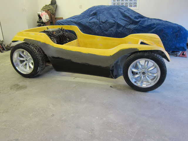

dsmbuggy wrote:I did some more adjustment and fitting for the fiberglass body so I know more precisely where I can mount some off the components. ( Fuel cell, radiator, battery ...)
I had to cut the body in half because of the proportion of the talon are different from the buggy.
The Talon is square and the buggy body is narrow in the front and wide in the back.
I will have to widen the front and narrow the back of the body.
It looks like half a car for now.
Next more fabrication.

This guy just likes cutting......I can't see it yet, think the work is very interesting and brave but kind of crazy!
The body doesn't look right for me.....rear wheels too far back and all the cuts in the bonnet are too much. I still love seeing this thread though!

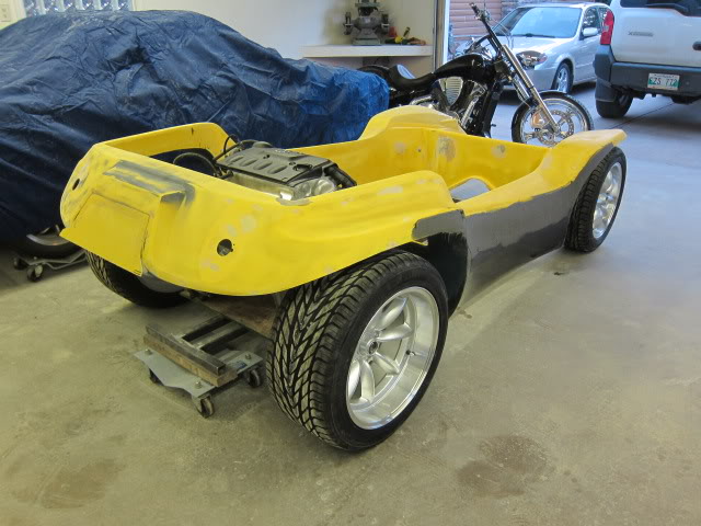

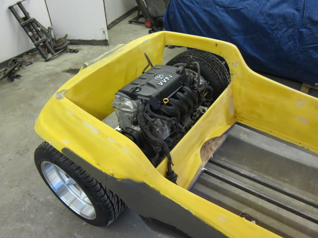

dsmbuggy wrote:I still working on the positioning of the body to get the best stance possible without cutting it in 15 pieces.gr8cobbler wrote:The stance is going to be pretty good. Not sure about lifting the front of the body as previously suggested. I think the "buggy" needs the straight part over the rear wheels parallel to the ground or slightly up in the rear to look right. It seems to slope down toward the rear a bit. May just be the way you had to rest it for the photo.
Any thought to the rear body treatment? Normally contains the cool exposed VW engine, I’m sure you have something cool in mind to treat/cover/trick out the radiator?
The rear treatment comes next.
A rear mounted rad for better weight distribution.(and I have no room in the front...)
First positioning.
fabrication of the rad support/bumper.
check
Ready to go
Here you go, this is what people are gonna see the most.
