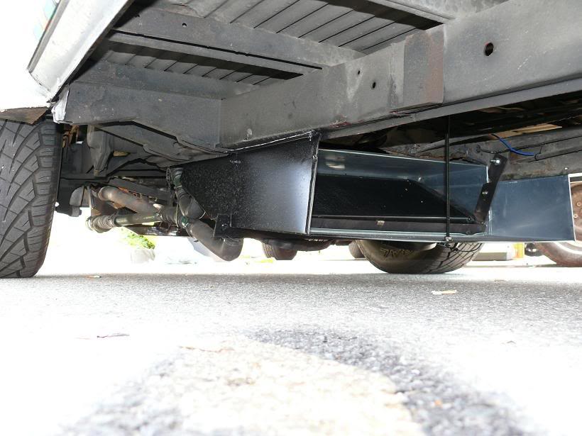

With the radiator, I would make sure that I could scoop air from under the van into the radiator, and then have a exit scoop, in line with the 1st scoop, which will release air back into the vacuum that the 1st scoop has made.
This will suck the hot air out, giving good cooling.
Just remember to seal this air channel well as it will take up a lot of water in wet days. Also place grid protection for stones.

Kinda like this bus???retrovan wrote:Hi all,
As long as you keep the "TOP" of the bulb, lamp, to the top it will work as it does in other cars, the internal deflectors will control the light. If using a sealed beam, place "top" to the top and it will work.
My 1/2 cant worth....![]()
- Posts: 8717
- Has thanked: 424 times
- Been thanked: 543 times
Re: Pappa se pompwagen
[/quote]
Defiantly not kinda like that...........
A bit more refined would be NICE.......
Flatter , wider, neater, ....yes....
[/quote]Defiantly not kinda like that...........

I want to put the radiator inside the engine bay on the left hand side. Golf 1 radiator fits nice there.
Defiantly not kinda like that...........retrovan wrote:Kinda like this bus???
Flatter , wider, neater, ....yes....[/quote]
Have seen two local Buses done like this, both run Golf engines and they work brilliantly with no overheating etc etc
Better than hacking up the front of the Bus with a radiator and Mercedes grille

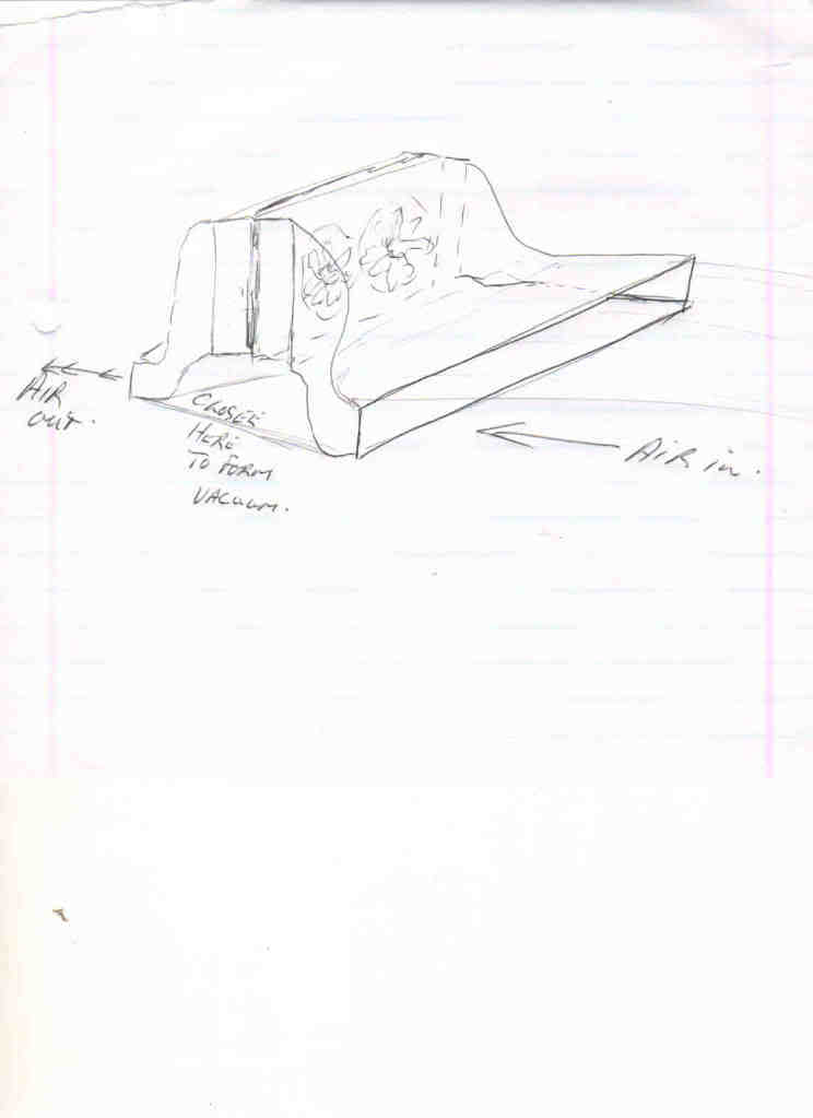

I agree, the radiator must be in the engine bay, so that you can get the hight right.RICKY-R69 wrote:I searched this topic thoroughly on the net. Plenty ideas on http://www.vwkd.com . But I like the idea of putting the radiator in the engine bay as I am planning on camping next to dams and travel a lot of gravel roads.
This is important to prevent trouble with air locks. Fit a Pressure/filler tank at the highest point, and fit slim air ducts from under the van, through the radiator, down to bottom, of van , and out the back.
If the intake is exactly the same size as the intake, the vacuum formed will help suck out hot air.
The bends will also help to protect the radiator.
And it will look neat, even from the bottom.

Do not mix the radiator air with the engine compartment air, then both will not work.
Keep the air through the radiator completely ducted so that what comes in must go out. Then create vacuum at exit point, to help fan remove air.
The other side you scoop the same way, and use it to cool engine bay. Also air in and air out.
Water cooled is not the same as aircooled in so far that the fan must have air flow assistance, such as grill, air scoops, negative air pressure, ie vacuum to draw air through system, and then the fan assists during hi peaks.
Also push fans are better then pull fans.(got myne from silverton radiators, very helpful)
Have used this system for the trike, and it works well.
Goodluck
Herman.
