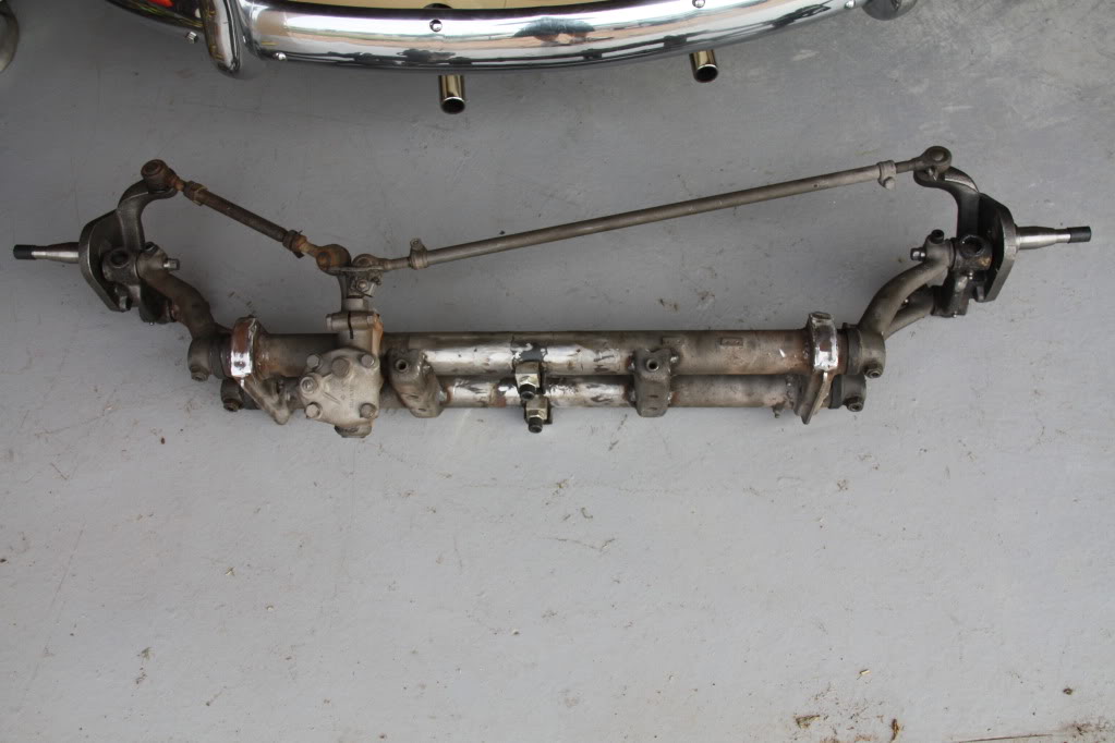

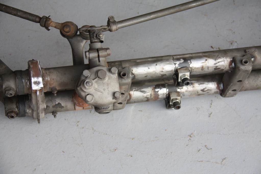

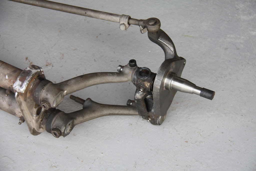

Here are some pics of my beam before welding on the brackets for shocks.

Re: My 72 project'''with 6 inch narrow beam''
Cool man,thanx,',but u can keep them coming,i dont mind an idea or ten''
