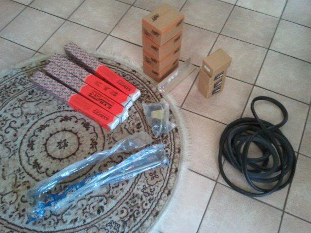

Bit of an update :
I ordered some spares from Calooker , which are coming all the way from the U S of A.
Parts include :
Part #: 211-415-802F TIE ROD, RIGHT WITH ENDS, BUS 68-79
Part #: 211-415-801F TIE ROD, LEFT WITH ENDS, BUS 68-79
Part #: 211-101B BUSHINGS,ANTISWAY BAR L/R BUS 1968-1979
Part #: 343144 KYB GAS SHOCK,FRONT= (BUG 47-65, BUS 50-79, GHIA 56-65, TYPE 3 66-73),REAR=(BUG 47-79, BUS 50-67, GHIA 56-74,THING 73-74, TYPE 3 66-73) x2
Part #: 344045 KYB GAS SHOCK,REAR BUS 1968-1979 x2
Part #: 211-405-371A BALL JOINT,UPPER AND LOWER, BUS 68-79 x2
Part #: 211-037C WINDOW SEAL KIT, FRONT & REAR, CAL LOOK, BUS 1968-79
VW Parts.net
C.V.Joint Boot Kit, W/Hardware Code: 211598201 x4
WolfsBurgWest
Part # 311853687 REAR HATCH VOLKSWAGEN SCRIPT, aluminium
I will be taking delivery of the bus on the 11th of july, then the work can start!
I will be replacing all these parts, along with Wheel bearings (which I will have to source locally, any ideas where?), the discs will probably come off to get a skim, and I will add some new brake pads(which I will have to source locally, any ideas where?)

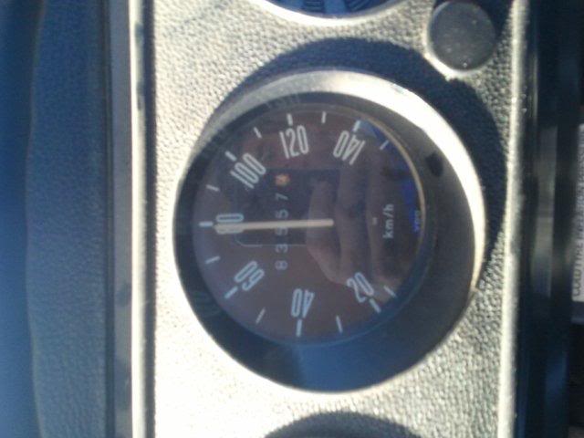

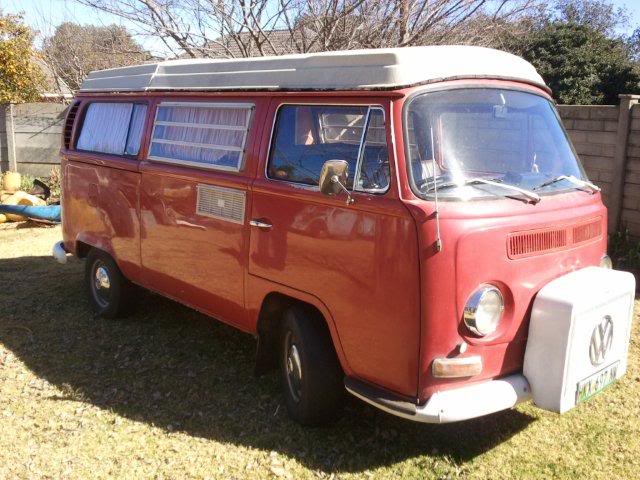

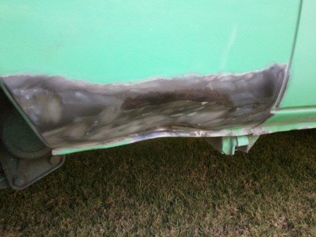

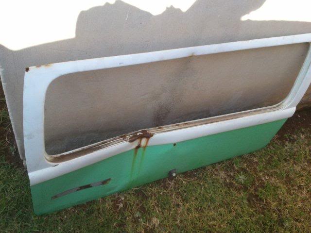

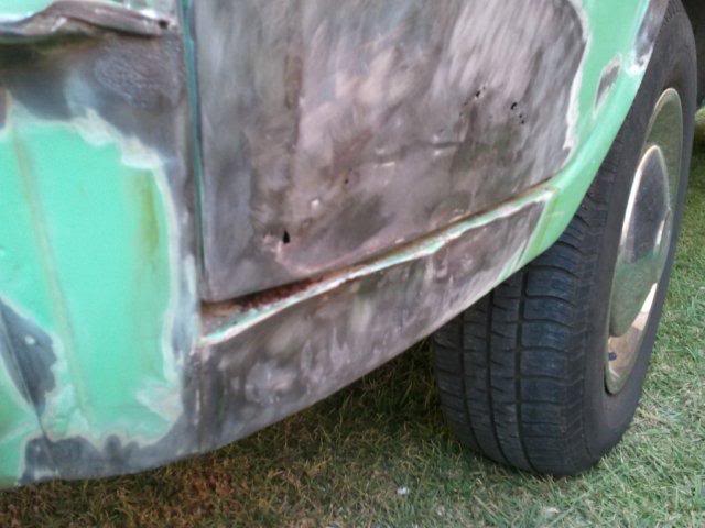

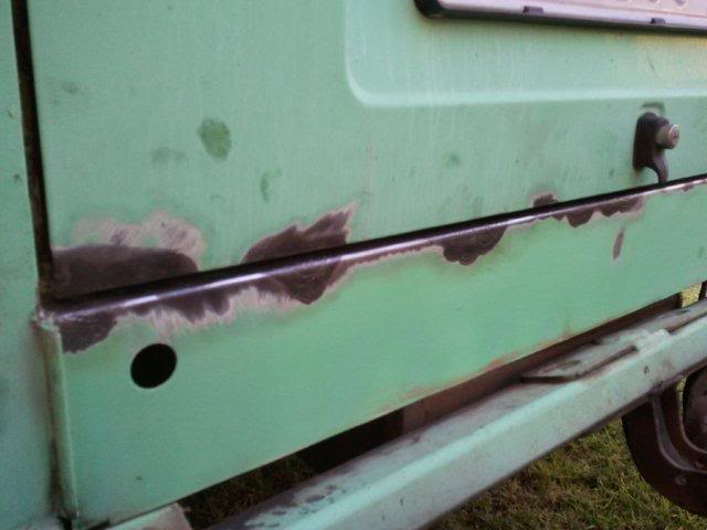

Bit of a write up:
So Saturday morning 5 o’clock We were ready to go, as we were leaving springs to pick up the bus in PTA. We drove with a bakkie incase we had to tow the bus, but original plans were to drive the bus back seeing as it was running the last time I saw it. I had to stop over at my house in pta to fetch some stuff and had a lekker breakfast there.
When we reached greenbean’s house, the bus was already standing ready and idling away. Greenbean was nice enough to get it started just before we arrived.
So I got in the bus and off we were… I could feel something wasn’t right, no power and also it sounded like the bus was only running on 3cyl. About 5km from greenbean’s house… There was smoke everywhere! Holy crap!
I was so pissed, got out to have a look… Thank goodness, It was just some old oil that was laying around and some got on the exhaust!! While cleaning everything up my dad replaced one of the plug wires… Pow!! Bus was up and running like never before! The whole way back the bus ran like a dream, cruising at a constant 80kmh all the way !!
The bus behaved well and we got back to springs.

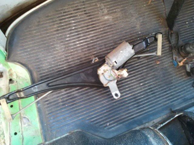

Inspection time started, first thing I noticed is that the bus is actually a 1979 model not a 1978. Which leads me to believe the bus should actually have been fitted with a 2l type4 and not a 1600 type 1 ??

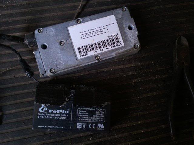

There is still major problems with the electrics of the bus, I started fiddling around and I found this thing :
I think its some sort of alarm that was fitted? But anyways I removed it… Then the bus didn’t want to start? Eventually fiddled around some more and all was well, bus starts.
I got fed up with the electrical side and decided to proceed later.

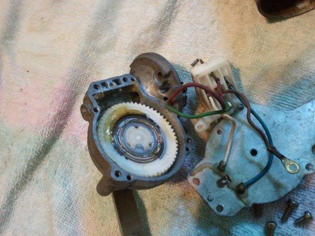

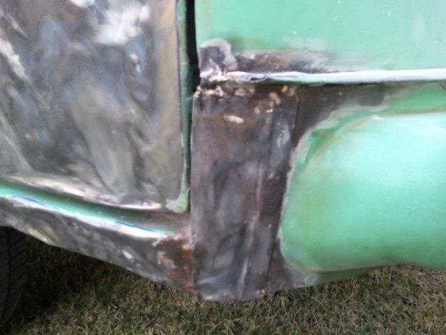

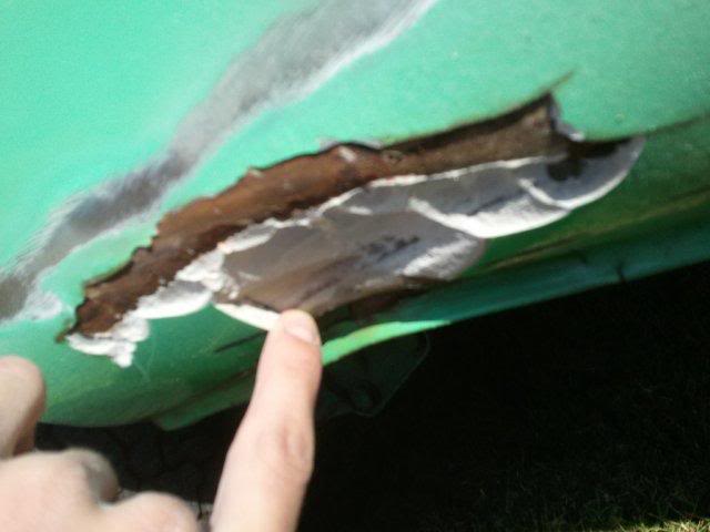

It was evident that the bus was in a few accidents, so I started by checking out these areas. I sanded the areas down to the metal with some areas having putty up to 15mm !
I want to have these areas fixed the right way, and get someone to help me with this, maybe ferdi( Ill still give him a call). I also got some red oxide that ill apply to these areas after they have been fixed.
Most of the rusty areas that was there, I also sanded down to the metal.

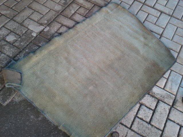

If anyone is interested in these two you can have them, just pick it up :
The mat is the one that fits in the boot.

I removed the whole wiper assembly because the wipers dont work :
What i found was that the one wiper shaft was rusted an wont even move out of the "bearing". SO I need a new one, can anyone help?
Also when I opened the gearbox, I found that the gear is stripped, So I also need a new one when it comes to that. Can anyone help?

Recieved some parts from the US, and picked them up from Calooker :
So over the weekend I took a trip down to Orkney, to pay a visit to IMPI. We spoke about some options for my bus' engine. Finally we decided on building a brand new 2L type4 with FI. Currently Im just waiting for IMPI's final quote before we commence building
I was going to paint the bus black and ivory, but then I saw IMPI's bus :
Now I have decided to go with red!
So I am consulting the panelbeater/spraypainter today about changing the bus to red instead of black. This is the look I want, but with a white roof :
The bus will be leaving for the panelbeaters on saterday!
