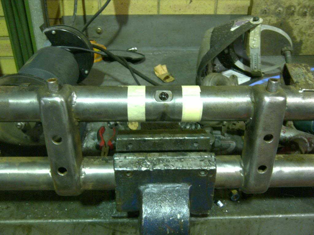

Beware the "weld on" adjusters, that are not so simple, removal of the original beam centre support for the leafs is a bastard of a job, you will land up having to cut the beam anyway to do it, then also drilling and the cutting of a slot is also requred, to add insult to injury the replacement centre support is the wrong size to actually do it's job properly, and the inner dia of the serated teeth deos not match that of the beam. I tried them once some 5 years ago, not again. :bn: BTW did VS tell you the 26th, of which month???? good luck. :shock:

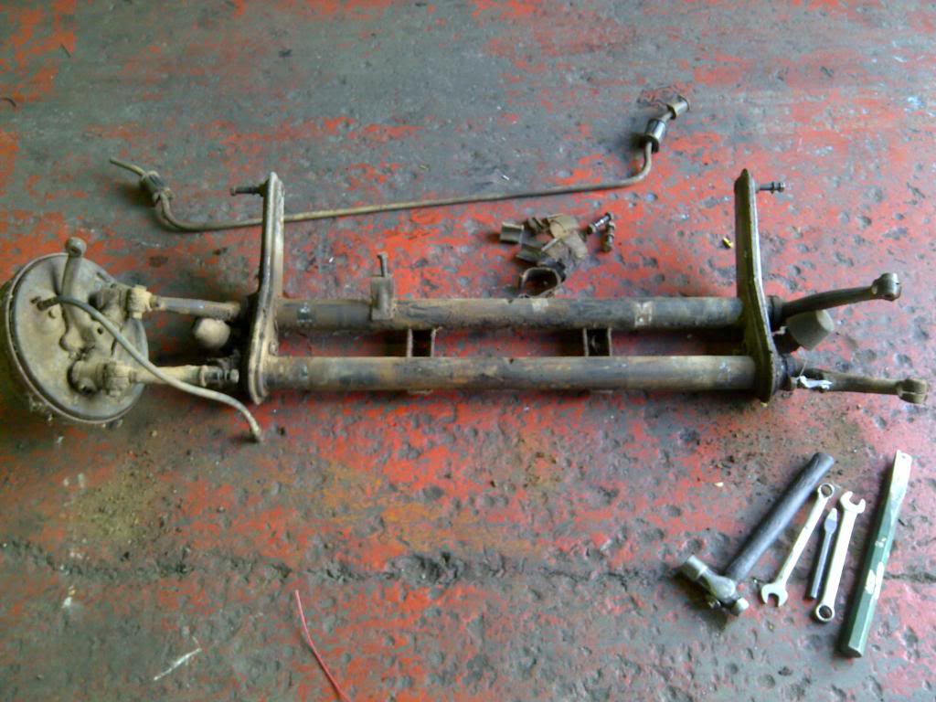

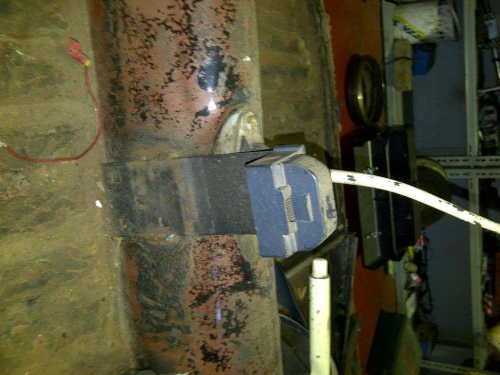

What I've done so far.... Stripped the beam in preparation for the beam adjusters that ill be getting from calooker tomorrow
Thanks for looking

Little progress today....
Got my beam adjusters on Friday-thanks calooker :hangloose:
and got my mig welder yesterday so I wanted to weld them in...
Got to the shop this afternoon,wanted to do a couple of practice welds with the mig before I tackle the beam.. guess what!.. no gas
So I weld them in with the arc welder,will get some gas tomorrow for when I'm welding the pan etc

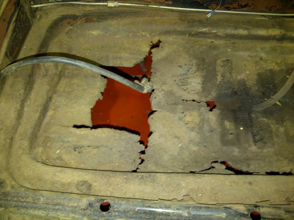

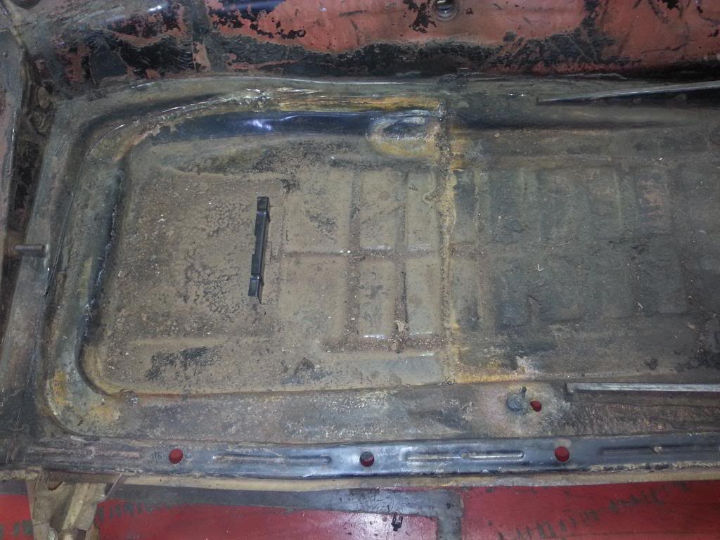

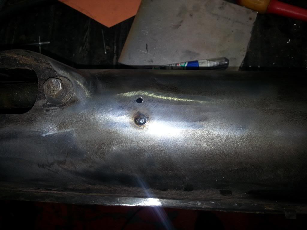

So when I bought the car I got Empi repair panels for the rear quarters of the pan,I then attempted to replace the rusted parts sections.Afer repairing the right side I wasn't happy with the outcome.You could see that the panel was repaired.So I was on the hunt for another pan but could not find a rust free early pan with the knob heater control.
And proper pan halves is a tad pricey for me.(allot actually).I then thought what better way than to replace the pan halves with genuine VW pressed steel from latter pans
I then placed a wanted ad on the forum and got a pan for free from Datwagen where the left side was perfect- painstakingly removed all the spot welds and welded the left-side on my pan.
The other day on my way to the shop I spotted a bakkie with 2 pans on the back presumably on his way to a scrap metal dealer.Asked him to pull over and bought the 1 pan that was still rust free at the battery side (with the battery hold down strap in place)

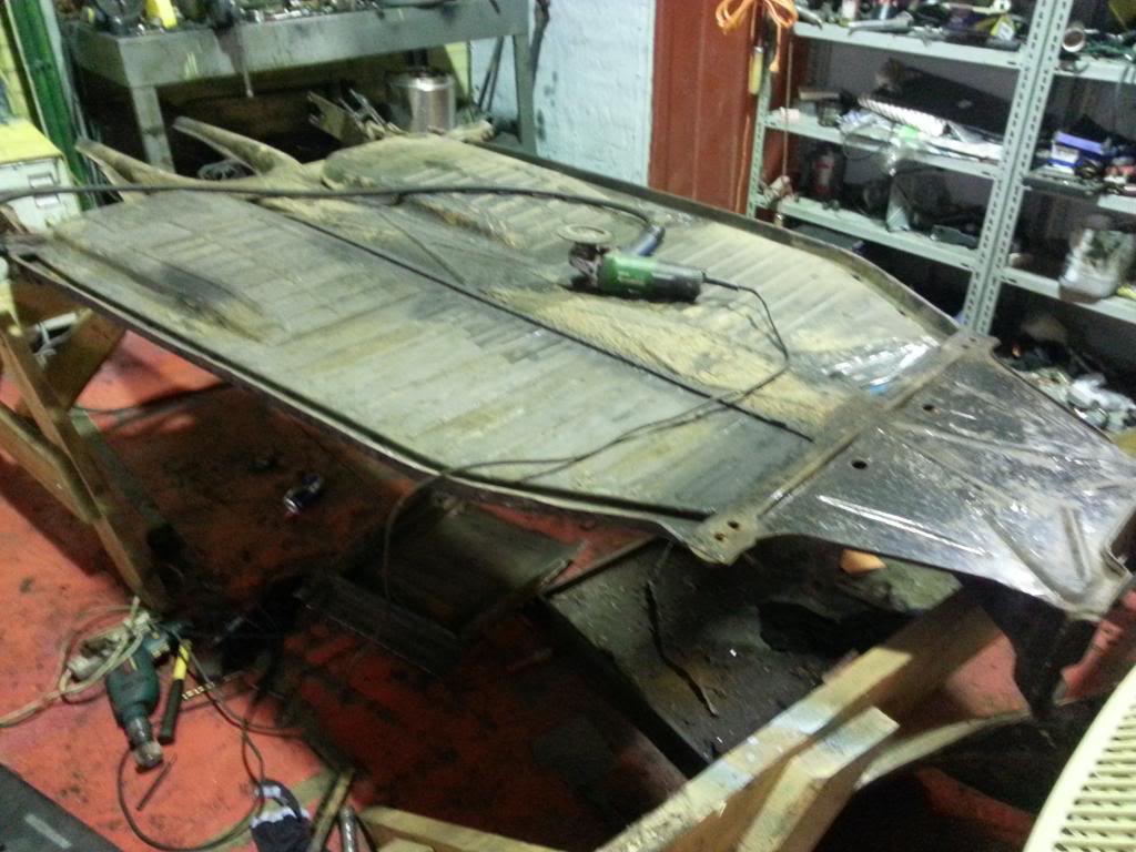

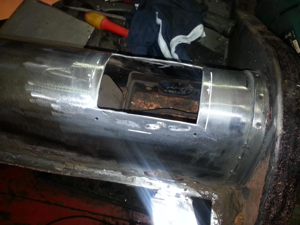

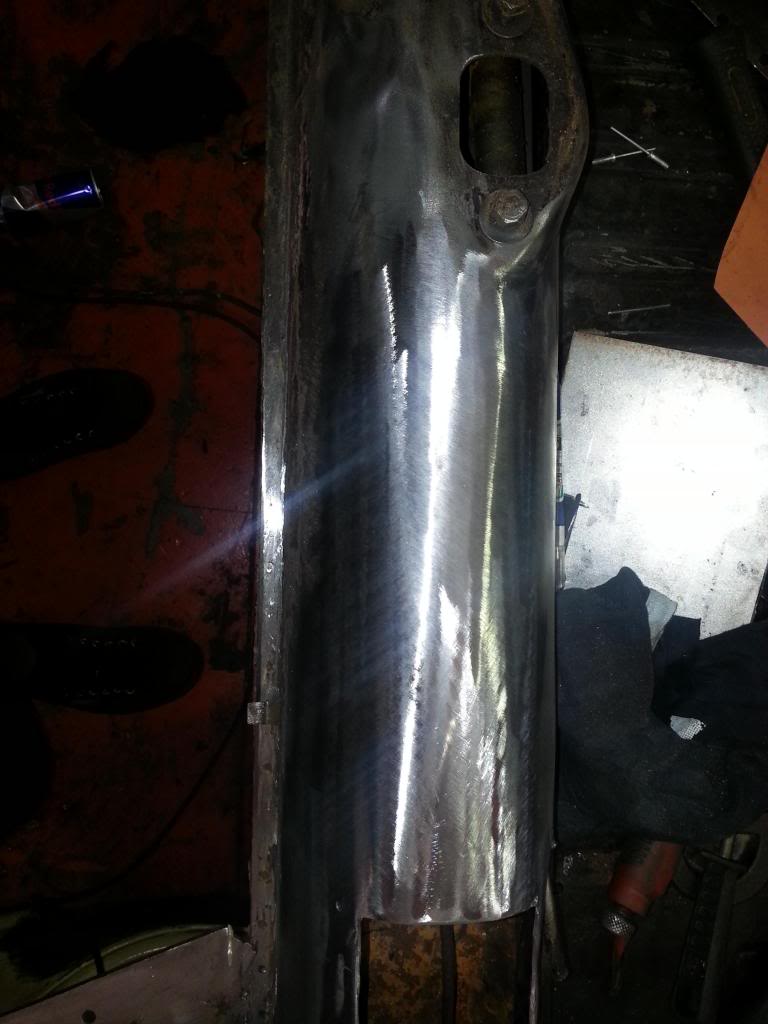

Friday last week I removed the right side of that pan and today I welded it in place.Only problem was that the pedal area is not the same so I had to cut that piece out and fab a replacement piece.I did everything to look as stock as possible and no taking shortcuts.
some pics
1st before pic's of the rust
My first repair attempt

What I started with this morning
The pan halve that I removed from the later pan
The rust free battery area :hangloose:
Plug welds
The panel I made for pedal area

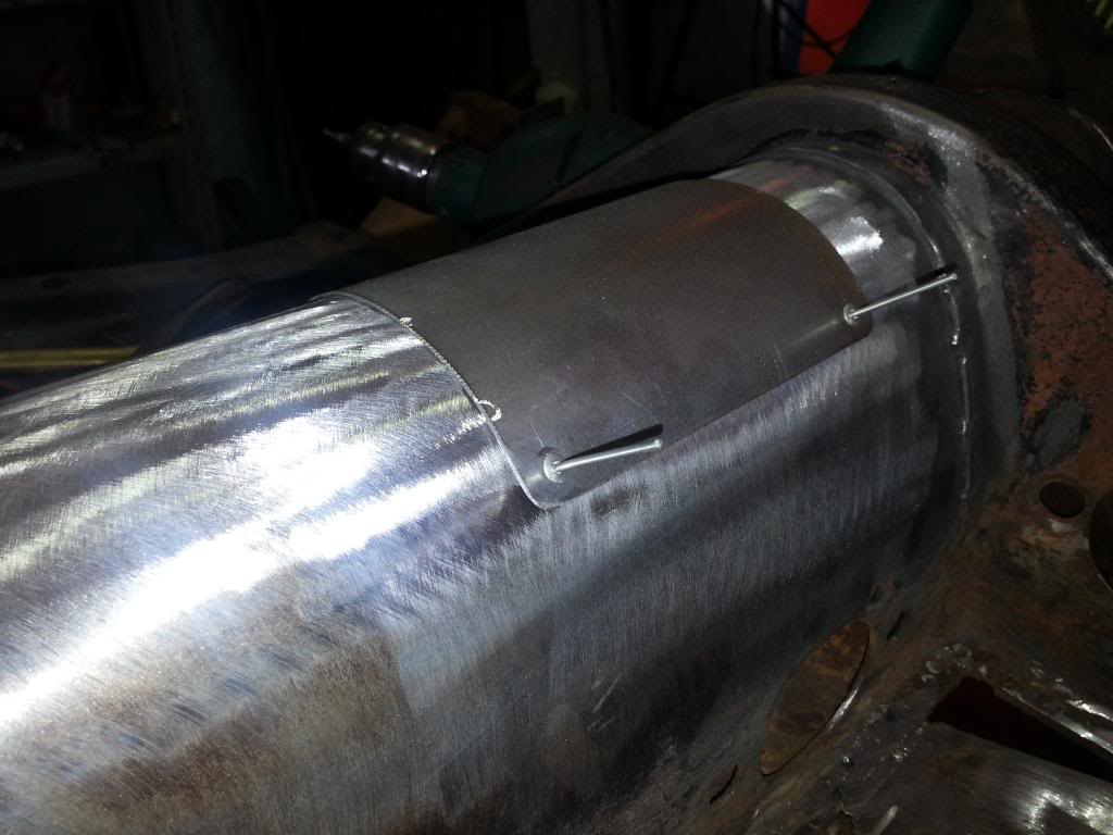

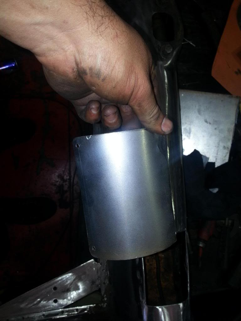

Also somewhere along this beetle's life someone replaced the clutch cable and butchered the tunnel
I then made a clean cut got it more straight and made a removable cover.I also removed the gearlock and closed up the holes
