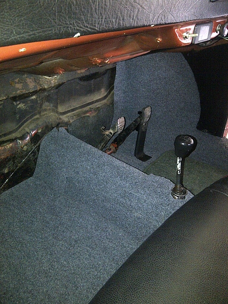

New dash template made and a section of new carpet. 8-)
Current project, 71 beetle 1600
