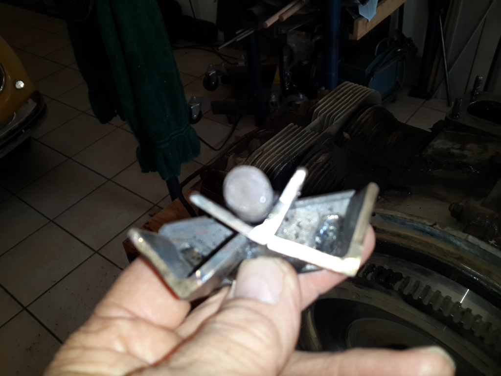

Then I found what looked like a mangled piece of wire, about 15mm long and 2mm thick. We then went hunting upstream of the piston and found that the injector tube (pump jet) in the carburettor was missing. This gave a clue as to the origin of the piece of metal.
Obviously, the pump jet had fallen out and it then worked its way into the cylinder, causing the ruckus as the piston slapped the little intruder violently around the ears.

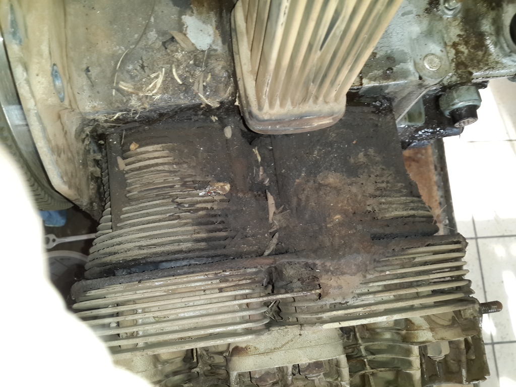

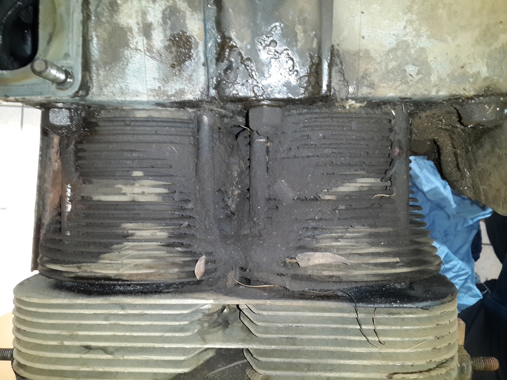

With the tin removed, it was found that the cooling fins were severely clogged with dust. Obviously the result of combination of a slight oil leak around the barrels and very dusty operating conditions. (That red Limpopo dust goes everywhere)
If left unattended, it would have lead to overheating on the first extended trip, and then it would have been expensive.

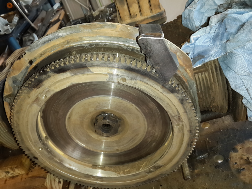

To remove the flywheel nut, Andre made this cool "VW" tool to lock the flywheel when the nut is loostened.
