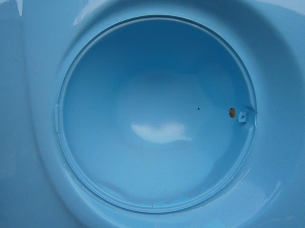

Terry, can you please take a photo of the light bowl, , the recess that the light assembly fits into as well as the side /back view of the light assembly itself

Here's a picture if the headlight bucket. Clearly no tabs

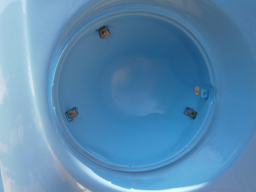

I made some tabs with stainless steel and rivited some rivnuts on

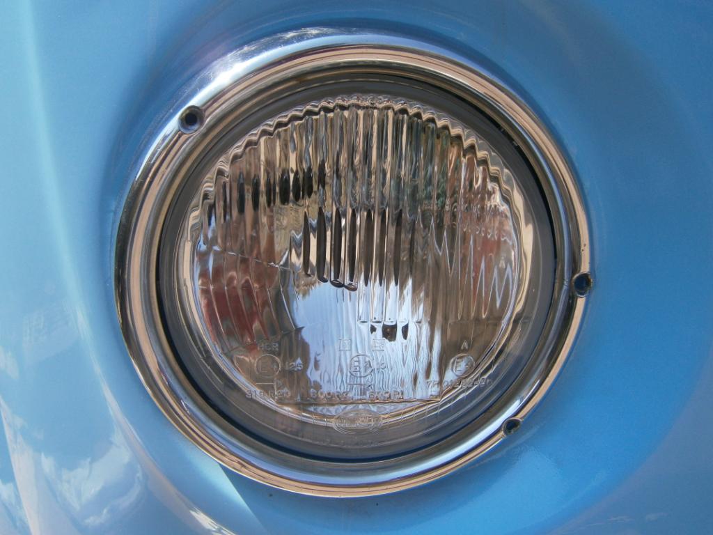

I got the new Hella lights but had to modify the section where it bolts on
Done!
Done!

Thanks Didi how far in are the new brackets you fitted are they all the same depth to set the lights.

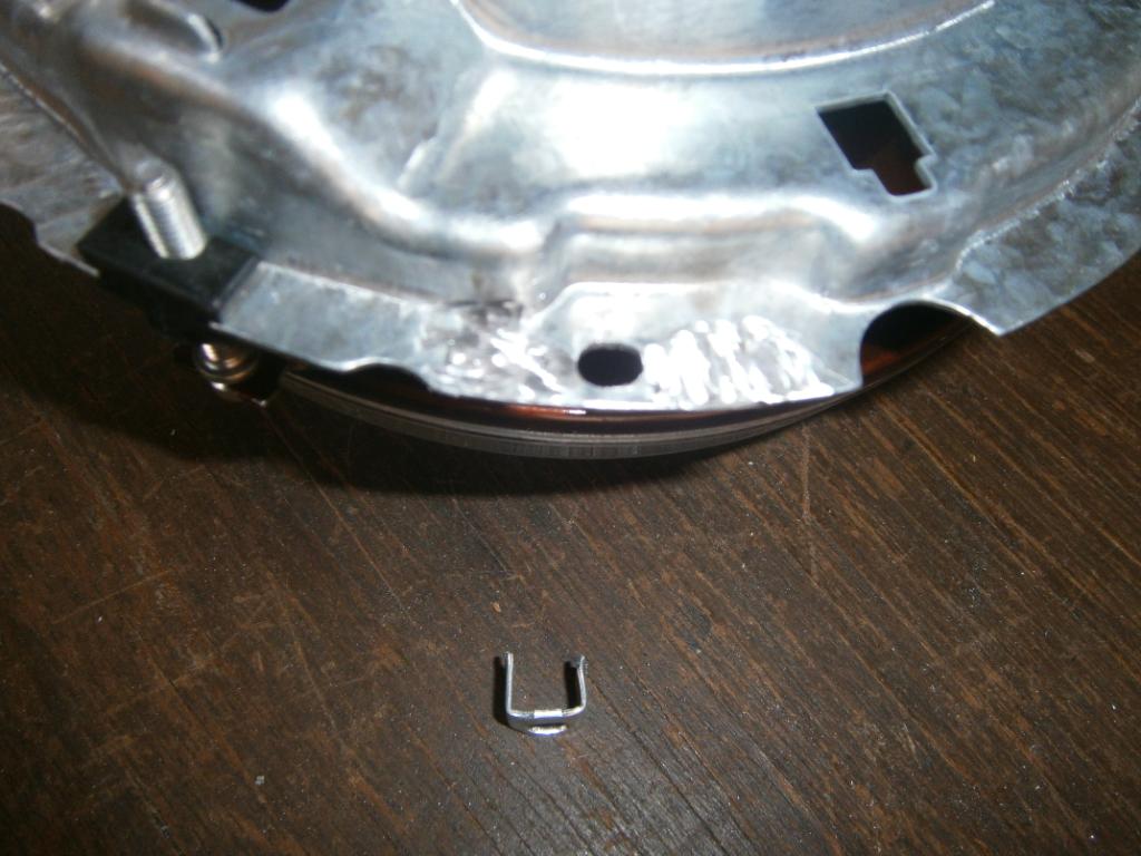

Is this the golf unit from Goldwagen that will work? And with the lense fitted to this bracket does the chrome ring screw into this backing plate?

Do not buy then loose, get the light with the fitting ring all in one. you can get them at Autostyle or Midas
This will make it simpler for you and you will be able to fit the chrome ring back onto the body as before it is not fixed to the lamp assembly.
If you look at the photo, the setting screws have been removed, and I always fit dummy screws with nuts behind the chrome ring, into these holes to make it look original from outside.
But this will tell you that everything has been striped off the chrome ring, and it is fully independent from the lamp & cradle assembly.
You now do your adjustment with the chrome ring off, by using the golf lamp assembly setting screws.
Just make sure when you fit the golf lamp assembly that you have the "TOP" pointing up. or your light will not be settable.
