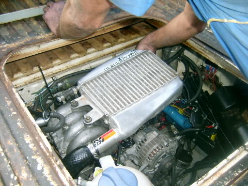

Noi not even moving the intercooler is needeed
A u bend for the exhaust and there you go
and the Declid closes as long as it is a 70`s model declid :D

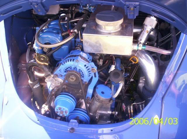

This is my beetle with charge cooling and a lot of mods
This is the way not do do it by fitting the intercooler and oil cooler right next to one another and cutting the whole doggy box away
Rether leave the intercooler on top and in good time when finances agree build a charge cooler

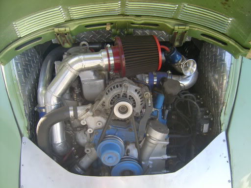

The way with a stock 13BT and injection is defnitley the way to go
You are more than welcome to come and visit me to have a look at the way I built my beetle and the way I did the doggy box
This was 13BT in my DC and it ran like a Bat out of hell
