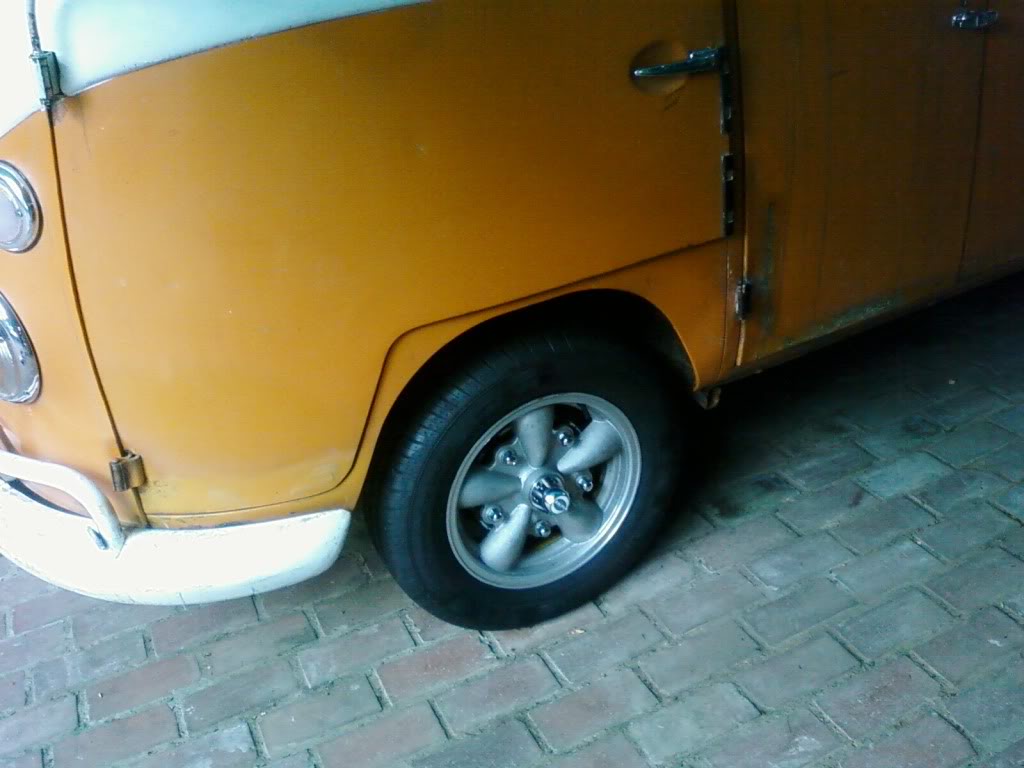

Got the last set required on friday, as well as some EMPI centre caps.
Bought some threadlock liquid and "locked" the studs into the drums today.
Word of advise to anyone else contemplating fitting studs. DEFINATELY use the threadlock.
I got the studs out of the drums WAAAYYY to easily for comfort. Strange thing, two of them WOULD NOT BUDGE.
Went quite quickly actually, take nut off, unscrew stud from drum, line of threadlock around the stud, tighten the stud back into the drum, nut and washer back on, tighten, repeat 20 times. Fit 4 x Centre caps and FINALLY, you get properly fitted Empi 5's !

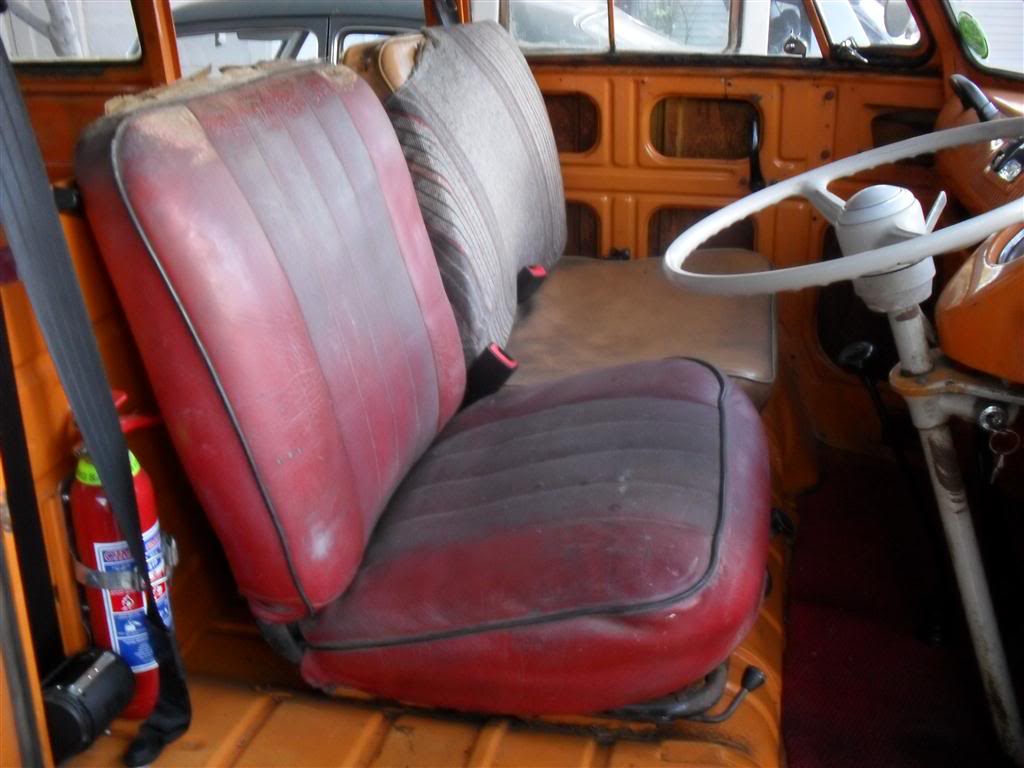

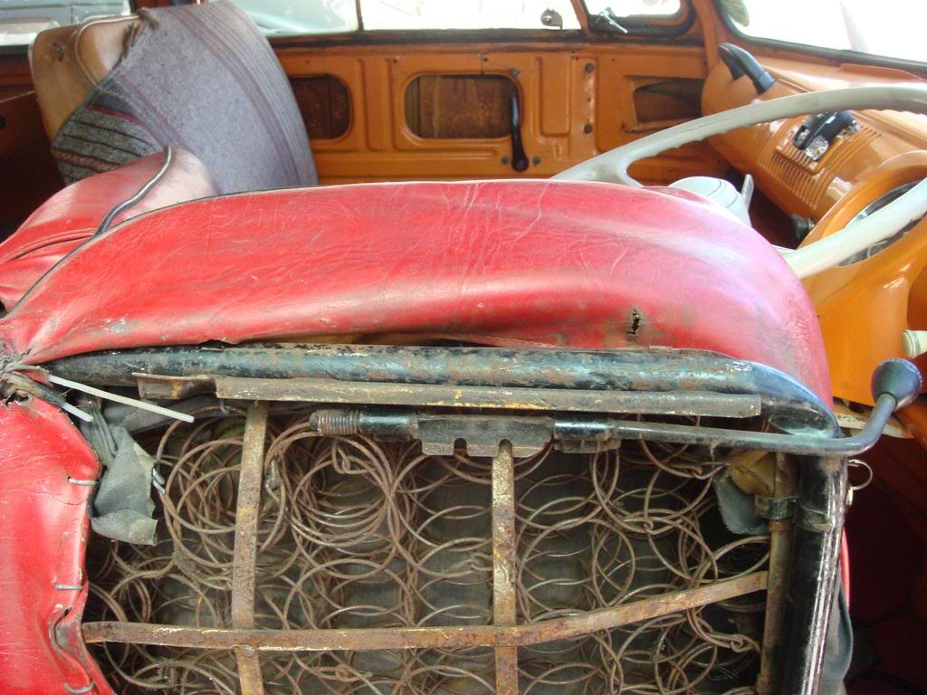

Finally got a drivers seat.
Thanks VW-rules!! Much appreciated. :hangloose: I owe you one.
Seat needs a full restore, but I was very pleasantly suprised to see the mechanisms on it all still work. :D
Took out the current seat of unknown vintage, and this seat slid right into the rails.
The backrest adjuster still adjusts and it slides forwards and backwards like it should. Way cool.
Soon we can start the reupholstery of these seats.
Oh, and there is a pic: Image

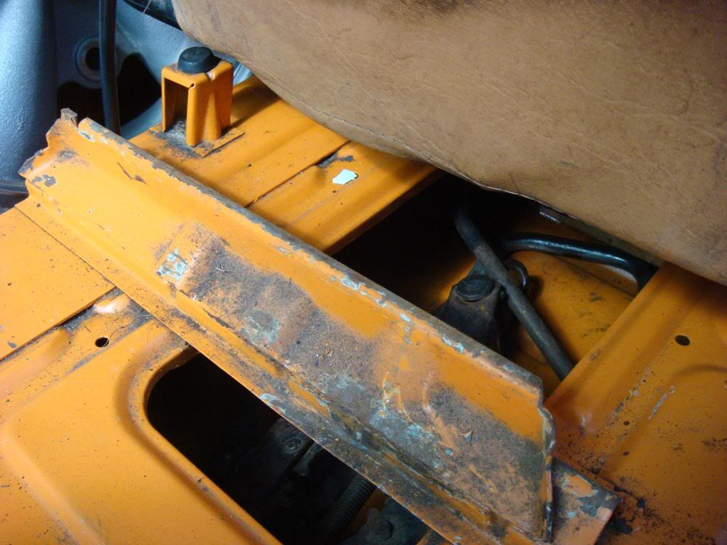

Karma
I need a favour please. Can you remove your seats and then take a pic of the rails for me. Thanks Man, I knew I could count on you. :D
Re: Fleetfooted - 75 Fleetline - We have ignition :-)
HR, will do when I get a chance to be at home in daylight again :-) , you couldn't have asked three hours ago :twisted: ?

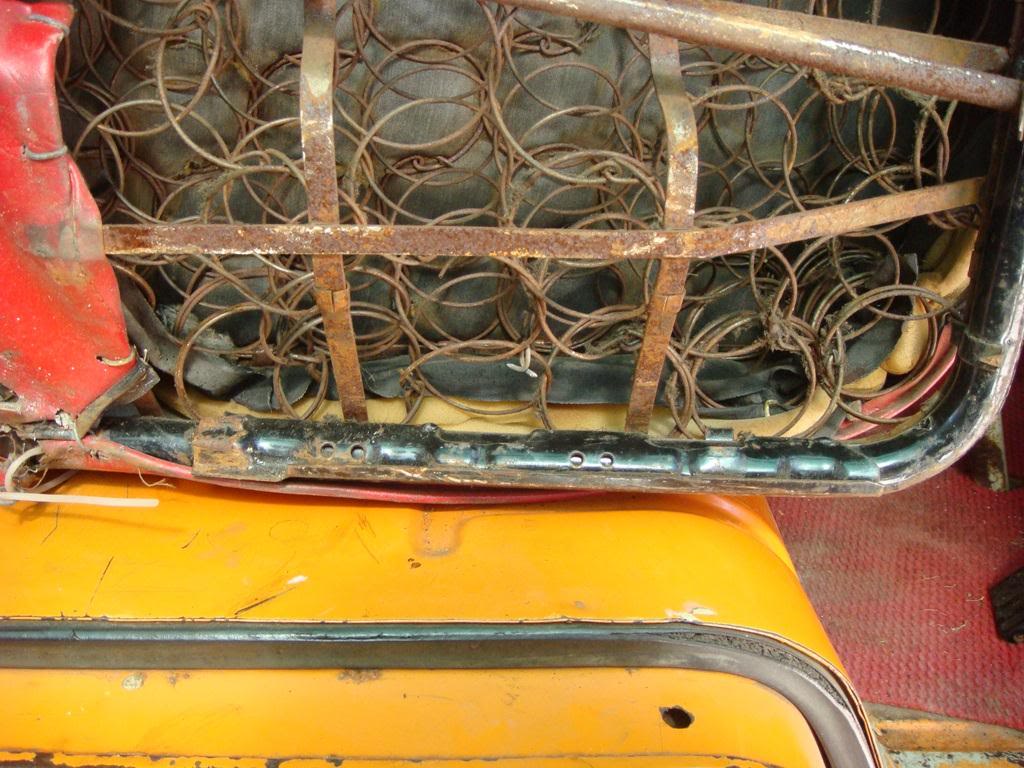

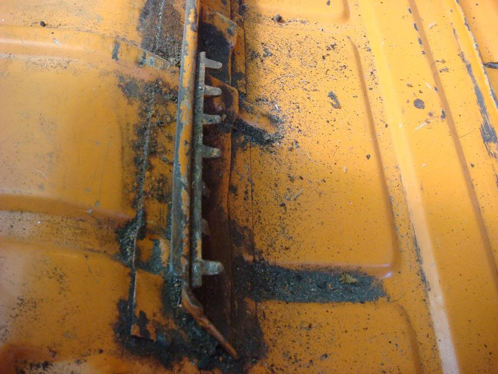

HR, specially for you, with the help of Beetlefanatic:
Thanks Karma. Sorry you had to go through all that. Now I've got an idea of what I need to do to my bus. And that is start from scratch. @#$#$@#$^%$
